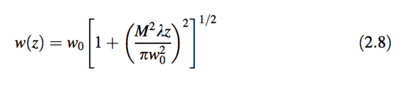

Hi all,
I am interested in finding the power of a laser diode as function of the distance z, assuming a free space propagation. I think to have enough information to work it out but I am stacked at the moment.
Given:
  • the initial power, P0 = 1mW
  • beam width clip (e-2 = 13.5%), wx = 3μm, wy = 1μm
  • wavelength, λ = 650nm
  • divergence beam width (full angular), θ = 1mrad
  • M2 = 5
What would be the power P(z) and the radius w(z) of the beam at a distance z?
Thanks in advance for any help!

The power is constant everywhere. There is no way the power will change unless the energy inside the laser changes, e.g. due to battery depletion.
Thanks for your prompt reply. About the radius of the beam, how large would be the laser spot after, let's say, 1m or 50m?
The information about the angular divergence which you already have there should be sufficient to determine the width at a given distance, assuming this distance is far enough from the beam waist.
I have used the following equation (2.8) to simulate the width at a given distance, using the beam width clip as w0. How do I include the angular divergence in the simulation of w(z)?
Thanks

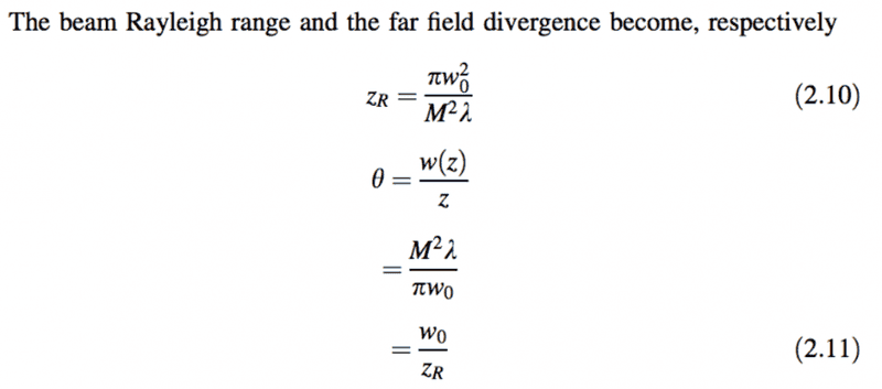

Isn't the beam divergence given already in equation (2.11)? You can plug in this into equation (2.8).
I thought that the 2.11 is valid only far away from the beam waist. After which value do you think it's "sensible" to use the far field approximation?
I have plotted the beam radii propagation for the X and Y axis and after a distance of about 4 meter the two curves are overlapping each other, i.e. same radius in the plane and the spot is not elliptical anymore. Is that an expected result for such a laser diode?
##\theta## is indeed derived by taking the limit of ##\frac{d w(z)}{dz}## for ##z\rightarrow \infty##, but it turns out that ##\theta## has such a form given in (2.11). Therefore you can regard this equation as an identity and you use it to replace any factor containing the RHS of (2.11) with ##\theta##.
Well at least for a perfect Gaussian beam, the smaller beamwaist you have, the bigger the angular divergence is. So, the behavior of the beam you observed makes quite some sense.
I had to refresh my memory about this topic, now it makes sense.
Thanks a lot for your replies :)
