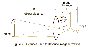

If you will look at this picture, you will see that laser light defocusing could happen after it exits a defocusing lens. You could imagine a viewer to the right of the picture.
https://www.google.ca/search?hl=en&site=imghp&tbm=isch&source=hp&biw=1097&bih=504&q=focus point&oq=focus point&gs_l=img.1.0.0l10.1347.6211.0.7312.11.8.0.3.3.0.112.737.6j2.8.0...0...1ac.1.58.img..0.11.785.760NeqkOueE#hl=en&tbm=isch&q=focus laser&facrc=_&imgdii=_&imgrc=dtm0n4DY_zW8qM:;5zaCK4Rwe6qbxM;http://laserpointerforums.com/attachments/f44/24857d1261844122-dx-green-laser-focusing-lens-green-focusing.jpg;http://laserpointerforums.com/f44/dx-green-laser-focusing-lens-46599.html;700;449[/URL]
What I wish to know if how large could be a distance between a point where it exits the last lens and defocuses, and how large angle of defocusing could we achieve. And similar details.
I'm afraid I don't follow what you're trying to do. Expanding a single laser beam will not form a picture of anything. It will just show up as a single colored dot once it is brought back into focus by the eye.
Look at the picture above. Notice that light is emitted (or reflected) from the top and bottom of the arrow as a diverging cone (they only show part of the full cone here. In reality the cone would expand in every direction away from the point and the lens would capture a part of the cone equal to its full aperture, not half). The lens then takes this cone and causes it to converge to a focal point. Note that every single point on the arrow is actually emitting its own cone of light. They only show the very top and very bottom for clarity.
Your laser beam is the equivalent of a single point emitter, and as such the image will be a single, focused spot of light. Nothing more.

The diagram you provided is complicated and I do not understand what is the "object" and what is it needed for.
Obviously, a lasers suppose to move vertically and horizontally like in a laser TV in order for a "single focused spots of light" as you said will create a full picture.
The object is simply an arrow. The light comes from the arrow, goes through the lens, and is focused at the focal plane where it forms an image of an arrow. The object could be a tree, a person, or whatever else you want to create an image of.

Honestly if you don't understand the very simple diagram I linked above, then you seriously need to study basic optics before trying to design some sort of optical laser system to project images.

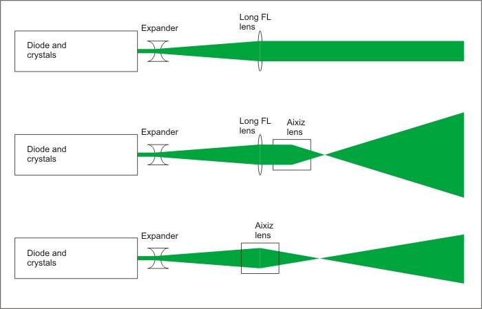

There is such thing as a focal length. This is the distance between a lens and a focus.
http://www.eurolaser.com/uploads/pics/eurolaser_Linsen_1_GBR_01.jpg
http://www.eurolaser.com/uploads/pics/eurolaser_Linsen_4_GBR_01.jpg
I think if they will achieve good enough manipulation with focal length and make it long enough the images may look like they float in the air.
Currently they achieved very high level of manipulation with light. For example they could create bended light rays and even make a light circles.
http://en.wikipedia.org/wiki/Airy_beam
For practical screenless images creation they would have to manipulate at least with a focus lens dynamic change. I think it could be done with help of some optoelectronic materials.

As mentioned, this was not intended for imaging purposes, just to show the statement there is not always true. I saw one of those plasma spots in a lab, it just looks like a bright, tiny point in space.

What is concerning to laser focus, everything depends at least in two things: the focal length and the angle of defocusing. Maybe someday it would be possible to make it defocus 360 degree wide, so it will radiate light in all sides completely evenly, and viewing angle will be practically unimportant.
The focus of the laser is entirely irrelevant. Defocusing the laser simply turns it from a coherent beam which can only be viewed from directly in front of the laser to something similar to a normal light bulb which can be viewed from a wide angle. An array of lasers can easily make an image similar to how a TV screen works, except that unless you defocus each beam, you'd need to stand directly in front of the lasers.
The amount of divergence of a cone of light entering your eye determines how your eye focuses it, not how it forms an image. For example, the light from a very distant object like a star enters your eye with practically zero divergence. It is essentially composed of parallel rays. In contrast, the light from you TV is diverging when it enters your eye. The lens of the eye alters its shape in order to bring light from objects at different distances to a focus.
Using a spotting scope with an adjustable focus, you can easily adjust the divergence of the light from an object at a set distance by moving the focus back and forth. Generally the most comfortable focus position for viewing an object through a scope is one where the light from the object enters the eye with very little divergence. That way the lens of the eye can completely relax and you don't have to expend any effort to bring the light into focus on your retina. Moving the scopes focus will cause the light to diverge before entering your eye instead of being composed of parallel rays, so your lens will flex in order to bring the light into focus on your retina. No matter how the focus is set, the image appears the same once it is focused on the retina. As you can see, whether the light is diverging or not doesn't have any effect on the image, it only affects what needs to happen to bring the image into focus.
When the light enters your eye with no divergence, it is acting like a laser beam. A laser beam has little to no divergence over a long distance. Adjusting the focus to make the light diverge before entering the eye is similar to the light coming from your TV. The light leaves each pixel in a diverging cone which means that you don't have to stand right in front of the TV to see it, but now your lens has to flex in order to bring the part of the cone entering your eye into focus.
Does all that make sense?

I don't see how not. The discussed system is exactly the result of the geometry in the lower two images, where the green beam corresponds to one pixel.
No, certainly not. This is not an engineering issue, it is a fundamental physical limitation.
