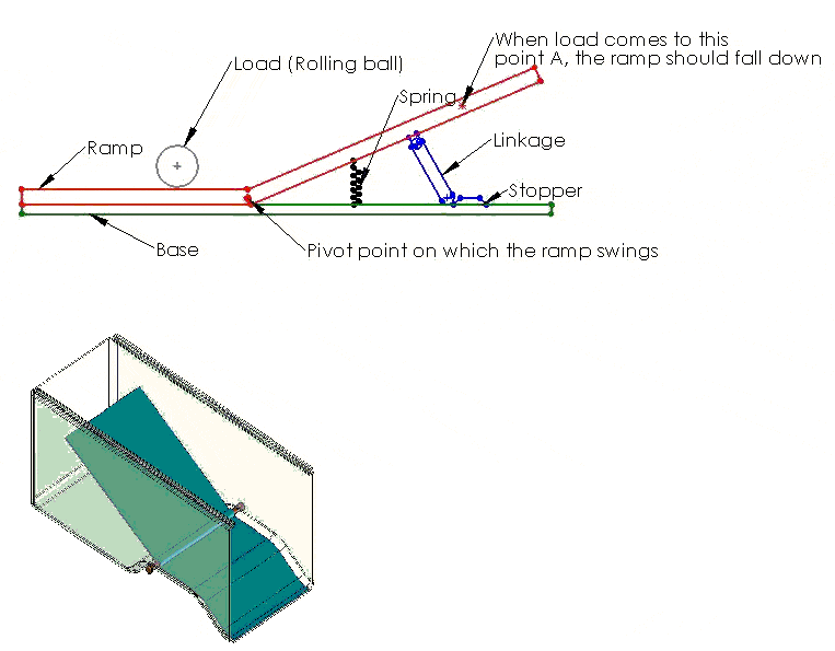

Hello all
I have attcahed a WORD file that has a diagram that exlains the problem.
When you open the file, you would see that I have a inclined part (called ramp) that pivots on a base. A ball (load) rolls up the ramp. The ramp is supported by a spring and some linkage. The linkage shown is not the final linkage, it's just there for representation. This linkage is the design problem. That is, I need to design a linkage such that when the ball rolls up to the point (shown by asterisk), the linkage will collapse such that ramp is now free to swing down and hit the base. For all other positions of the ball before that point A, the ramp should stay where it is.
I have put in a simple link that is blocked by a stopper. When the ball reaches certain point on the ramp, this link slips off the stopper and then the ramp falls down.
2 important criteria that it must meet:
1) The linkage needs to be a very simple link so tht the manufacturing is easy and cheap. I don't want to design a complicated multi-link mechanism.
2) The linkage should be load-independent and position-dependent. That is, the ramp must not fall down before the ball reaches point A, regardless of the weight of the ball. Therefore, it's the position, not the weight, of the ball that determines the movement of the ramp.
This whole assembly is laced inside a rectangular box that is shown in the 2nd picture. I have made the box transparent so that you can see the ramp. The linkage I want to design doesn't have to be like the linkage I have shown. It can be like a latch that engages in the side of the box. I just can't come up with any ideas.
I am looking for ideas to make this work. Eventually, i would want to do a force analysis of this linkage so that I can design the point A and load etc. Bu that will be later.
Pleas contact me if you have any questions about this problem.
Thanks a lot for your help.

Make it an electrical contact with the ball. The ball hits a certain spot, a contact is made and the linkage falls.

I'd consider just going with a simple straight bar pivoted to one side of the ramp and extending through a slot in the enclosure wall. When the ball hits it, it gets pushed ahead and disengages. (Think of hitting one blade of a propellor.) A light spring could return it to the loaded position once the ball has passed.

I get some idea but I am not clear how this bar is holding the ramp up. If the bar is above the ramp, how does the ramp stay up? And also, I want to have such a thing that the ball doesn't have to push the bar all the way out of its way. As soon as the ball touches the bar, the ramp should fall. This is also because the ball is traveling at a very slow speed, rather in halts and jerks, not continuous motion, no fast travel.
I was thinking along the lines of some latch that is at the end of the ramp. this latch somehow holds the ramp up. then as soon as the ball pushes it ever so slightly, it disengages fro the ramp and let's the ramp fall...

Interesting problem. What’s it for? Can you be a bit more specific? Does it need to be completely mechanical or can you use electrical devices? What’s the overall size of this? What are you using it for? When designing things, it always helps to know what you’re designing for. If it’s an industrial application and you need precise control for example, then Fred’s comments about using an electrical interface to more precisely control the mechanism may be the right way to go. If this is a mouse trap you’re trying to catch small leprechauns in the woods with, then electrical controls would be overkill, and Danger’s approach may be the best solution.
Just to hitch-hike on Danger’s approach, and because you’re responding to his thoughts, I’d suggest the attached. The circles are hinges, rectangles are solid sections. This is just a dumb idea to get others thinking, but basically, the ball rolls up the ramp to the trap which pushes down on the second, smaller, hinged section shown. The smaller hinged section is over-centered such that it holds the trap up. Once the smaller hinged section goes over-center towards the left, it collapses, and the entire ramp falls.
You obviously need to modify this significantly. Drop the entire floor away to determine how low it falls. Put a stop on the trap so it only rotates so far. Lots of little details are not shown.
I’m sure there’s a million other ways to do it.
