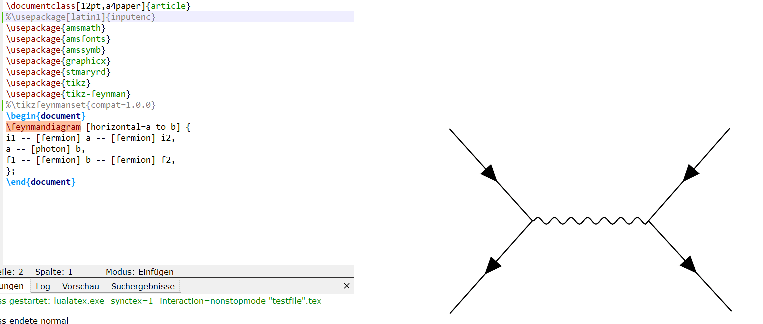

I've been trying to get Feynman Diagrams to work in my LaTeX code, however, the output is not what it is supposed to be. I'm using TeXMaker and TikZ-Feynman to draw the diagrams. My code looks like this:
\feynmandiagram [horizontal=a to b] {
i1 -- [fermion] a -- [fermion] i2,
a -- [photon] b,
f1 -- [fermion] b -- [fermion] f2,
which I have copied from the internet for testing purposes. However, instead of displaying a horizontally aligned Feynman Diagram, this gives me a weird vertical one, as seen in the attached picture.
Can anybody explain why this is happening? I am clueless and I haven't really found any solutions on the internet yet.

I've never used this tool. For my PhD thesis I used feynmf, but that's a bit tedious with "programming" the diagrams only. Now I use jaxodraw, which is WYSIWIG:
https://jaxodraw.sourceforge.io/
It is a compiler bug. If you change the compiler to LuaLaTex (IDE options) then you might not be able to see the pdf previewer, but the pdf document results in (see attachment)The disadvantage is, that you have to comment out
%\usepackage[latin1]{inputenc}
Corr.: my previewer works meanwhile:
Likes Ridmann, topsquark, Wrichik Basu and 2 others
That helped. Thank you so much!
