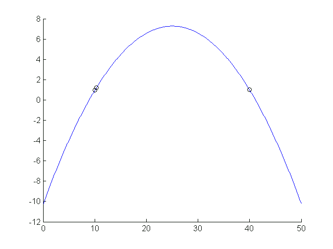

There is a problem with this technique. Consider what happens if two stations have similar values of [itex]d[/itex] but are geographically separated and have different pressure. One could end up with unreasonably large or small values of [itex]a_1[/itex]. See the attached picture for an example.
I think that the method employed should only generate pressures that are between the pressures given by the stations.
