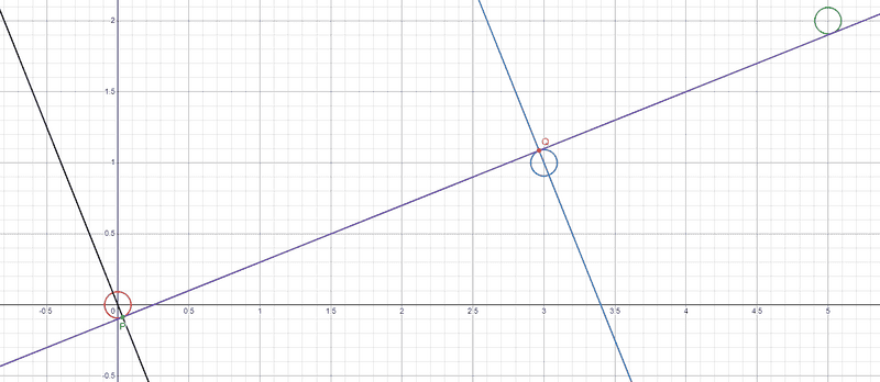

A lattice point in the plane is a point with integer coordinates. Suppose that circles with
radius r are drawn using all lattice points as centers. Find the smallest value of r such that
any line with slope ##(2/5)## intersects some of these circles
equation of a line, distance from a point to the line
So, the way I understand this problem, I think the line ##y = (2/5)x + c## should only intersect some of the circles drawn around the lattice points. But, I am not sure I even understand the problem statement. Can the line pass through the lattice points ? My first goal is to understand the problem statement.

Ok, let ##(x_1, y_1)## be the point of intersection of the line ##y = (2/5)x + c## and the circle of radius ##r## with center at ##(n, m)##. The equation of such a circle is
$$ (x - n)^2 + (y - m)^2 = r^2 $$
Since ##(x_1, y_1)## also lies on this circle, we have
$$ (x_1 - n)^2 + (y_1 - m)^2 = r^2 $$
Now, lets do coordinate translation where all points are shifted ##5k## units right and ##2k## units up. So, ##(x_1, y_1)## gets translated to ##(x_1 + 5k, y_1 + 2k)## and ##(n, m)## gets translated to ##(n + 5k, m + 2k)##. Its easy to verify that ##(x_1 + 5k, y_1 + 2k)## satisfies the equation of the line ##y = (2/5)x + c## and also satisfies equation of the circle with center at ##(n + 5k, m + 2k)## and radius ##r##. This proves that if the line with slope ##2/5## intersects a circle with center at ##(n,m)## then, it will also intersect the circle with center at ##(n + 5k, m + 2k)##. This was stated in post # 2. So, how do I proceed now ?
can anybody guide me further in this problem ?
What is the distance ##d## between the straight ##y=\dfrac{2}{5}x+c## and the circle ##(x-n)^2+(y-m)^2=r^2\text{ ?}## This distance is a function ##d=d(c,r,n,m).## Which is it?
If ##y = (2/5)x + c## is tangent to the circle, then the distance from the center ##(n,m)## to the tangent is given by the following formula from geometry
$$ d = \frac{|2n - 5m + 5c|}{\sqrt{2^2 + (-5)^2}} = \frac{|2n - 5m + 5c|}{\sqrt{29}} $$
How does the distance from a line to the edge of a circle of radius r not depend on r? Please show your working.
EDIT: Eliminating y between y = (2/5)x + c and (x-n)^2 +(y-m)^" = r^2 will give a quadratic in x. The line is tangent to the circle when the discriminant of this quadratic vanishes.
Ok, maybe I made a mistake. After plugging ##y = (2/5)x + c## into ##(x-n)^2 + (y - m)^2 = r^2##, I get the following quadratic equation in ##x##
$$ \frac{29}{25}x^2 + \left[ -2n + \frac{4}{5}(c-m) \right] x + n^2 + (c-m)^2 - r^2 = 0 $$
As suggested by pasmith, tangent occurs when there is only one intersection point. So, discriminant of this quadratic must vanish
$$ D = \left[ -2n + \frac{4}{5}(c-m) \right]^2 - 4\left( \frac{29}{25} \right) (n^2 + (c-m)^2 - r^2) = 0 $$
$$ D = \frac{1}{25} \left[ 116r^2 - 16n^2 -100(c-m)^2 -80n(c-m) \right] = 0$$
$$ 116r^2 = 16n^2 +100(c-m)^2 + 80n(c-m) $$
How does this help us ?

I have found solution on some site which I will explain here. As I have already shown that if the line ##y = (2/5)x + c## intersects the circle ##(x-n)^2 + (y-m)^2 = r^2##, then it will also intersect the circle ##(x-n-5k)^2 + (y -m-2k)^2 = r^2##, where ##k \in \mathbb{Z}##. Now, consider the points ##(0,0)## and ##(5,2)##. Lets draw two circles of same radius with these two points as their centers. Also draw a line ##y = (2/5)x + c## with the value of ##c## such that the line is a tangent in the fourth quadrant. Now, lets also draw a circle of the same radius with the point ##(3,1)## as the center. Now all three circles have same radius. Now, reduce the radius so that the line is tangent to the circle with center ##(3,1)##. And draw two perpendiculars to the line passing through ##(0,0)## and ##(3,1)##. We need to get the coordinates of points P and Q as shown in the attached diagram. The equation of the perpendicular line passing through the origin is ##y = (-5/2)x## and this intersects the circle ##x^2 + y^2 = r^2## at point P. Solving for x and y, the coordinates of point P would be
$$ x = \frac{2}{\sqrt{29}}r , y = \frac{-5}{\sqrt{29}}r $$
Now, for point Q, equation of the perpendicular line passing through ##(3,1)## is ##(y-1) = (-5/2)(x-3)## and this intersects the circle ##(x-3)^2 + (y-1)^2 = r^2## at point Q. Note that the x coordinate of Q would be less than 3. So, taking that into account and doing some algebra, we have the coordinates of point Q
$$ x = 3 - \frac{2}{\sqrt{29}}r, y = 1 + \frac{5}{\sqrt{29}}r $$
Now, points P and Q lie on the line ##y = (2/5)x + c##. So, the slope of the line is ##(2/5)##. Using slope formula and the above given coordinates of P and Q, we have
$$ \frac{2}{5} = \frac{1 + \frac{5}{\sqrt{29}}r - \left( \frac{-5}{\sqrt{29}}r \right)}{ 3 - \frac{2}{\sqrt{29}}r - \frac{2}{\sqrt{29}}r} = \frac{\sqrt{29} + 10r}{3 \sqrt{29} - 4r} $$
Solving this, we get ##r = \frac{\sqrt{29}}{58} ##. So, this should be the minimum radius.
Thanks fresh_42 and others for all the help. ##\smile##
