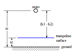

Harry has a mass of 58kg and jumps off a roof that is 3.8 m above the ground and lands on a trampoline that is 1 m off the ground. The trampoline has 110 springs each with a k value of 77.6 N/m.
a) How far does the spring/trampoline stretch? For simplicity sake, assume the trampoline mesh is an extension of the springs.
b) What is the acceleration of Harry on the trampoline when his speed reaches 0 m/s? include a free body diagram.
c) If 30% of the energy is lost due to friction each bounce, how far above the trampoline will Harry reach on his first bounce? 2nd bounce?

hi, thanks so much. I'm really sorry about the confusion, i made a typo so i will fix it. i tried the question again and got this so i hope it makes more sense.
h1 = 3.8m (guy standing above cliff)
v1 = 0
x1 = 0
h2 = 1m (trampoline)
v2 = 0
x2 = ?
Eg = Eg + Ee (law of conservation)
mgh1 = 1/2kx2^2 + mgh2 (formulas for each of the above based on the variable list above)
58(9.8)(3.8) = (110)1/2(77.6)x^2 + 58(9.8)(1) (subbing in variables. there are 110 springs so i multiplied the Ee equation by 110)
2159.92 = 4268x^2 + 568.4
x = 0.6m
i would really appreciate it if you could tell me if I'm doing this right, and how i can approach parts b and c.
You're close, but I think you would benefit by drawing a diagram of what's happening so that you can visualize your energy changes when writing out your equations. For example, before Harry jumps the situation is like this:
Now clearly, Harry falls a distance (h1 - h2) before hitting the trampoline. When the trampoline has maximally stretched the situation is as follows:
As you can see, Harry falls an additional distance Δx, stretching the springs. So that's an additional mgΔx of potential energy going into system. What's the total distance that Harry falls? That gives you the total PE "sourced" and converted to other energy. Can you write an expression that describes the total gravitational PE that goes towards stretching the trampoline springs to their maximum for this situation?
How far do the springs stretch? That gives you the energy transferred to the springs, which should be equal to the "sourced" energy from gravitation.
A nit-pick: In a real-life trampoline the springs don't stretch vertically. They go from approximately horizontal to some angle below the horizontal, so the vertical deflection of the trampoline mat is something different from the actual stretching of the springs depending upon the geometry of the trampoline. It's not a trivial exercise to work out how the energy will be distributed amongst the springs for a non-circular trampoline.
For part (b) you need to find the net force acting on Harry when the trampoline is maximally stretched. If you found Δx while doing part (a) that shouldn't be a problem.
For part (c) you need to consider what losing 30% of the system energy does to the height of the bounce. If he leaves the trampoline surface with 70% of the energy he arrived with, how does that affect height he returns to? Look at how KE and gravitational PE exchange. Also note that they ask for his height above the trampoline, not the ground for this part.

ahhhhh, i see! i think this would make sense then:
Eg = Ee
mgh = 1/2kx^2
58(9.8)((3.8-1)+ x) = 1/2(77.6)x^2
1591.53 + 568.4x = 38.8x^2
i would then have to use the quadratic formula to solve for x. i got -0.28m and 15m. 15m seems unreasonable, so do i still have to multiple the Ee formula by the number of springs in the trampoline?
thank you so much for your help! i will attempt b and c and let you know how it goes
edit: i multiplied Ee by the number of springs and got x = 0.7 which seems more sensible but i'll wait for your input

hi again! for a) i did what i mentioned above and got 0.7m.
for b), i equated Fe + Fg = ma.
kx + mg = ma
110(11.6)(0.7) + 58(9.8) = 58a
a = 93 m/s^2
for c), i found Ee.
1/2kx^2
1/2(110)(77.6)(0.7)^2 = 2091 J
then i found 70% of it for the first jump = 1464 J
i equated this to mgh
1464 = mgh
h = 2.6m
i did the same for the second jump, after finding 70% of 1464J
am i on the right track?
