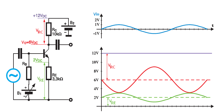

See this example of a common emitter amplifier.
At first we bias the transistor in linear active region.
Next we connect the input signal 2V peak to peak AC signal.
The DC voltage at base is equal Vb=2.6V, and emitter dc-voltage is 2V.
So if we apply the ac signal to the base. The dc-voltage will be change from 2.6V + 1V = 3.6V and 2.6V - 1V = 1.6V. So the base voltage will change from 3.6V to 1.6V in "rhythm" of a ac input signal.
These changes will result that the emitter voltage will also change. From 3V to 1V. This will result the change in emitter and in collector current by (3V) 0.9mA to 0.3mA (1V). And this change in collector current will cause change in VRc voltage, between 9V to 3V. We have a three times larger change in VRc voltage because Rc is three times larger then Re resistor.
And as you can see I can use a Ohm's law to find all the current in this circuit.
And for any circuit we can use this basic law of electricity to find all what we need.

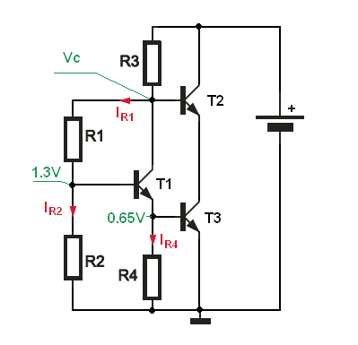

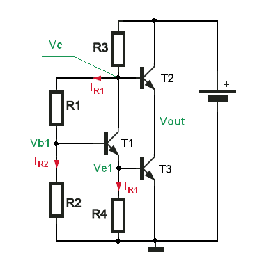

I give you another example. I will use nodal analysis which is nothing more than a KCL.
So for the Vc node we can write
IR3 = IR1 + Ib2 + Ic1
(Vcc - Vc)/R3 = (Vc - Vb1)/R1 + Ic1 + Ib2
Now KCL for Vb1 node
IR1 = IR2 + Ib
(Vc - Vb1)/R1 = Vb1/R2 + Ib1
And finally KCL for Ve1 node.
IR4 = Ie1 - Ib3
Ve1/R4 = Ie1 - Ib3

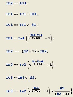

And additional equation for BJT

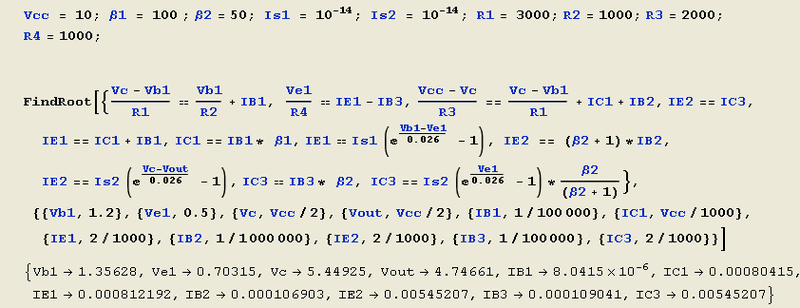

And next we need to use some numerical methods to solve the nonlinear equations.
I use a Mathematica software.
To be able to use algebra we are force to use some simplification and replace the BJT with his linear model.
For example If we assume Vbe = 0.65V and we ignore the transistors base current. We can solve for Vc quite easily. Just by assuming the Vbe voltage we already know the IR2, IR4 currents and Vb1 voltage.
IR4 = Vbe/R4
IR2 = Vb1/R2 = 2Vbe/R2
And we can find Vc voltage
Vc = IR2*R2 + IR1*R1 = 2Vbe + (2Vbe/R2) * R1 = 2Vbe + 2Vbe * R1/R2 = 2Vbe* (1+R1/R2)
and Vout = Vc - Vbe
