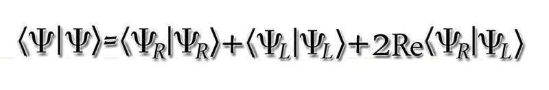

What if we write the double slit result like this:
## \langle \Psi | \Psi \rangle = \langle \Psi_R | \Psi_R \rangle + \langle \Psi_L | \Psi_L \rangle + 2Re \langle \Psi_R | \Psi_L \rangle ##
Then at least R and L can stand for "right slit" and "left slit", the ## \Psi ## would be capital in both equations, and the bra-ket notation would be used in both equations. Also the interference still shows up clearly in the "overlap" term.
Likes Demystifier
I still prefer the subscripts 1, 2 instead of L, R but it's nicer now.

renkma said:
I do have to ask though, why is the "result of the double slit" equations all look so different from each other, and from the one I had initially found. I am really hoping for some agreement on this one.
Just as with ordinary english language, with mathematical language one can say nearly the same thing in many different ways. And not all ways are equally "beautiful". In the double-slit case, the one in post #11 is probably the most beautiful so far.
Named functions should not be italicized. This is more correct.
## \langle \Psi | \Psi \rangle = \langle \Psi_R | \Psi_R \rangle + \langle \Psi_L | \Psi_L \rangle + 2\textrm{Re} \langle \Psi_R | \Psi_L \rangle ##
Ah, right - the "Re" looks better that way!

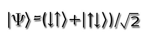

Well, here are the finished equations ready for my client's tattoo. She loves them; didn't want them fancy. How do they look to everyone? I went over them several times to make sure I didn't muck them up. If anyone sees any errors, please let me know.
Thanks all.
The top equation is missing a vertical bar to the left of the first term in parentheses: It has ## \downarrow \uparrow \rangle ## and it should have ## |\downarrow \uparrow \rangle ##. Think of the symbols ## | \rangle ## as boxes that you can put labels on. In other words, one of your boxes is missing a side!
Thanks for starting this nice thread! :smile: I don't know how open for change you still are, but I'll give my aesthetic considerations anyway.
I don't like the many vertical elements in the first equation. When I write this equation, I write it as ## |\Psi \rangle = \frac{1}{\sqrt{2}} \left( |\uparrow \downarrow \rangle + |\downarrow \uparrow \rangle \right)##.
But for the tatoo, I think I would drop the ##\frac{1}{\sqrt{2}}## completely. ##|\Psi \rangle = |\uparrow \downarrow \rangle + |\downarrow \uparrow \rangle ## is much more beautiful to me and it isn't wrong. It uses a different convention which makes calculations more inconvenient, but it captures the essence of entanglement just like the other one. Arguably even more because of its simpler form. Also your second equation seems to already use the same convention.
Likes akashik_rekords, Geofleur, Mentz114 and 1 other person
Thanks Geofleur - glad I posted before tattooing an error (Oh, that would be so horrible!), but before I hit Photoshop to correct my entanglement, may I ask ... do you agree with Kith? I agree that Kith's equation is prettier without all the vertical what-have-you. But I need to see how many I can get to agree before going with it.
And BTW, thanks Kith.
Everyone, please weigh in on what you think - I would very much appreciate it.

I also agree that the kith's version of entanglement is better.

To recap, given the various contributions, I also agree that the nicest choice is
## | \Psi \rangle = | \uparrow \downarrow \rangle + | \downarrow \uparrow \rangle##
A minor improvement:
## | \Psi \rangle = |\! \uparrow \downarrow \rangle + |\! \downarrow \uparrow \rangle##
(I reduced the space between "|" and the arrow. In Latex this is done by \! command, which often makes equations look better.)

So far I like the look of Kith's version. I see it's gotten a couple of thumbs up. I would really like to see a couple more thumbs up before taking it into Photoshop, and then tattooing it into skin. Hopefully a few more might see this thread and weigh in.
Best all ...

@renkma, you can send people a notification by writing an "@" in front of their name. So if you want the opinions of other people who have commented earlier in your thread, you can call them like this: @Geofleur @Nugatory @cgk @dipole
Also you should include Demystifier's suggestion (as you already did in your first photoshop version). The excess of space between the horizontal bar and the arrow isn't intentional, it is an artifact of using simplistic typesetting.
  • #34
I too like kith's suggestion of dropping the 1/2, and Demystifier's version (post #30) of kith's suggestion looks good to me.
  • #35
Excellent. I'm going with the double slit experiment equation I originally posted in #21 ,
and the following from post #30 (originally Kith's suggestion) for my entanglement.
