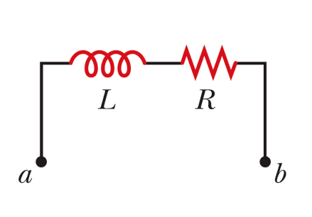

When the current in the portion of the circuit shown in the figure below is 4.00 A and increases at a rate of 0.500 A/s, the measured voltage is ∆ = 15.0 V. When the current is 4.00 A and decreases at the rate of 0.500 A/s, the measured voltage is ∆ = 10.0 V. Calculate the values of (a) L and (b) R.

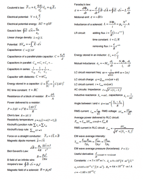

Given formula sheet.[/B]
My attempt:
I was given an equation:
adding flux formula:
i=Imax(1-e^-t/Γ)
Γ=L/R ---> Γ=L/(V/I)----> Γ=LI/V
R=V/IAm I on the right track?
Voltage between points a and b is sum of inductor voltage and resistor voltage. Inductor voltage is Ldi/dt..
So what I do is:
Vt=Vr+VL
Vr= I*R
VL= -L(di/st)
Vt=(I*R)+(-Ldi/dt)
So put in the variables given:
15v=(4A*R)+(-L(0.5A/s)) increasing rate
10v=(4A*R)+(-L(-0.5A/s)) decreasing rate
Then solve for L & R like?

Hi Am_0.
That's the right idea. Except there should not be a negative sign in the expression for VL.
Also, where you are asked to provide all relevant equations in your homework post, please only include those relevant to the problem at hand.
