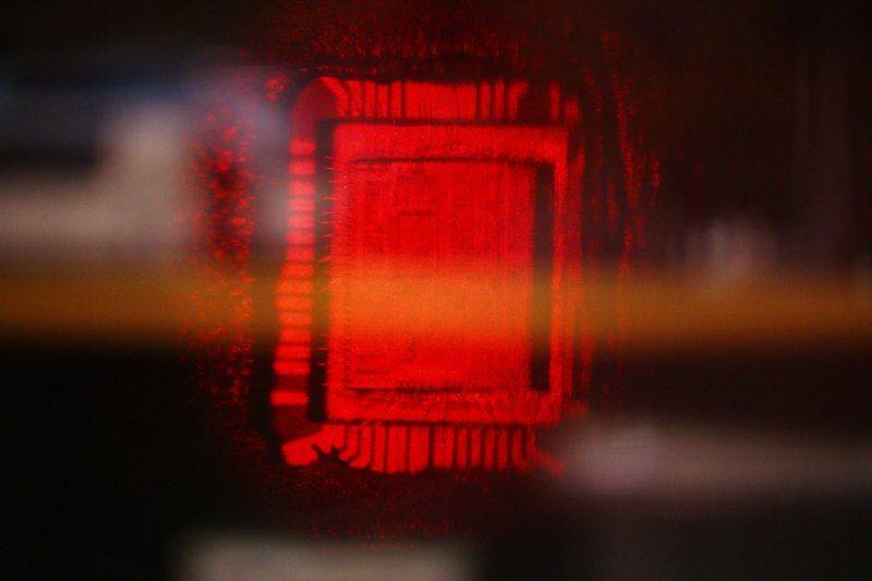

I made a hologram of a computer chip:
Andy Resnick said:
It really is as simple as the advertising claims- no need for heavy stabilized tables, etc. Each student group's initial hologram was suboptimal, but every group produced good-quality holograms using a variety of objects- one group even recorded multiple holograms on a single plate to demonstrate the principle of holographic memory.
I remember that, in the past, there were serious problems in producing decent holograms and an expensive setup was required. Do you know what changed?
Nope. Smarter engineers?
