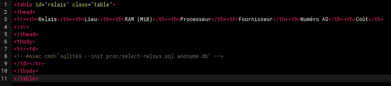

Personally, I would run a Python program directly with a shell command and get the results. You can use PHP or the like to execute a shell command, but even with only Apache, you can set it up for SSI (Server Side Includes) and execute any Python script. No need for intermediaries. Just make sure you sanitize your user input carefully, if any.
For example, I used this shtml file with Apache to read an SQLite database just to fill an HTML table:
proc/select-relays.sql:
(Sorry for the text as images, I'm just tired of being blocked by the extra-sensitive security on PF)
And the result is this.
I like the challenge of simplicity and lightweight (as few programs as possible). And it is "not too easy" to accomplish what you want - the way you want it - securely and efficiently. :wink:
