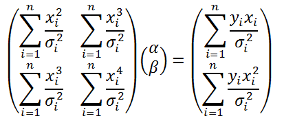

Yea I did mess up the derivatives and my subscripts were also wrong - thank you for clarifying :) I rearranged and got something like this for the matrix:
Looks correct at a first glance.
Likes Dixanadu
Thank you very much :D i know who to ask for help with stats! thanks :)
