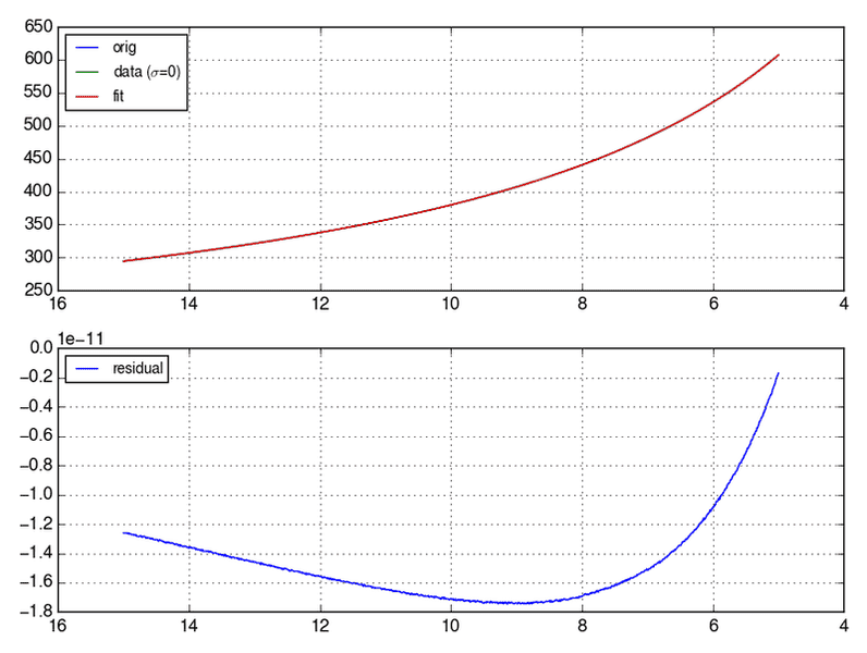

I'm getting closer, but we're not there yet. Let me first reply to your thoughts. We don't know the exact distance ##d## in the system, but we can make a well-defined move (##\Delta d##). That's what I meant when I said we don't know our starting point on the curve. So we need ##b## to account for an unknown offset in distance...
Somehow, I got hung up on how the cross product ##xy## would fit in the calculations. Then I realized it's perfectly straightforward. This is what I'm doing now: we're trying to find the coefficients in $$y = \frac{a}{x + b} + c$$ which can be written as $$xy = a + bc - by + cx$$ Replacing the independant part ##a + bc## with ##a'##, we need to minimize the errors ##\varepsilon_i## in the system $$x_i y_i = a' - b y_i + c x_i + \varepsilon_i$$
which can be written as $$\begin{align} \begin{pmatrix} x_1 y_1 \\ x_2 y_2 \\ \vdots \\ x_n y_n \end{pmatrix} &= \begin{pmatrix} 1 & -y_1 & x_1 \\ 1 & -y_2 & x_2 \\ \vdots \\ 1 & -y_n & x_n \end{pmatrix} \begin{pmatrix} a' \\ b \\ c \end{pmatrix} + \begin{pmatrix} \varepsilon_1 \\ \varepsilon_2 \\ & \vdots \\ \varepsilon_n \end{pmatrix} \nonumber \\
\vec {xy} &= \mathbf F \vec a + \vec \varepsilon \nonumber \end{align}$$
Minimizing ##\vec \varepsilon##: $$\hat {\vec a} = \left(\mathbf F^T \mathbf F\right)^{-1} \mathbf F^T \vec{xy}$$
So I tried this with numpy on data that is similar to sensor data, and it works! Even better: we may be able to offload these calculations to the application processor, where we do have a Python environment available. The crucial lines are:
Code:
import numpy as np
xy = np.array([x * y for (x, y) in zip(x, y)])
F = np.array([[1, -y, x] for (x, y) in zip(x, y)])
est = np.linalg.inv(F.T.dot(F)).dot(F.T).dot(xy)
return [est[0] - est[1] * est[2], est[1], est[2]]
Now the real world steps in, adding noise to the data. We know that the noise has a normal (Gaussian) distribution and does not scale with the amplitude of the signal. You'd think that in a large data set of, say, 1000 samples, the noise would average out. Unfortunately, it doesn't when the noise is significant. I analyzed part of a curve without noise (##a = 3000, b = 1, c = 107, 15 \leq x \leq 5##), the numbers obtained from an earlier curve-fitting experiment.
Code:
def f_inv(x, a, b, c):
        return a / (x + b) + c
a = 3000
b = 1
c = 107
# data set
x = np.array(np.linspace(15, 5, 1000))
y = np.array([f_inv(i, a, b, c) for i in x])

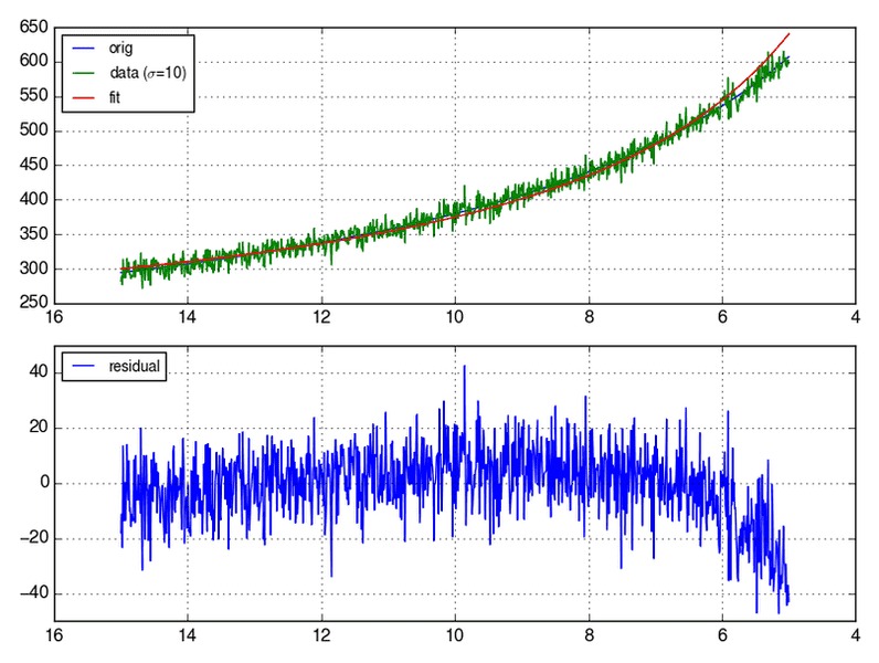

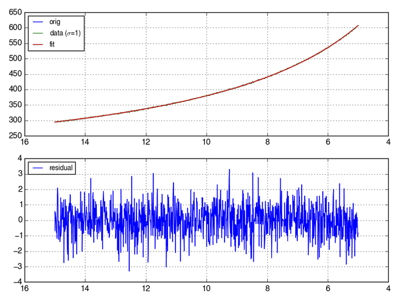

Running the data set through the code above, the same coefficients are found. However, when I add noise comparable to a real-world signal, I see a significant error.
Code:
y += 10 * np.random.randn(*y.shape)
I'll see if I can upload some plots, and I can send the script if you like. Any idea how to improve the fit in the presence of noise?
BTW, typing the equations does take quite some time. Thanks for your efforts!
I have cleaned up the Python code and created some plots for the values of ##a##, ##b## and ##c## mentioned above. Noise is simply added to the 'ideal' data, has a mean of 0 and a standard deviation of 0, 1 and 10.
What I infer is that, at higher noise levels, the mean of the residual is still low, but apparently positive and negative errors cancel out. I was hoping that the regression would lead to minimum errors over the entire data set...
As integrals are usually less sensitive to noise I tried
[itex]\int {xy\,dx} = \left( {a + bc} \right) \cdot \left( {x - x_0 } \right) + c \cdot \frac{{x^2 - x_0^2 }}{2} - b \cdot \int {y\,dx}[/itex]
(using Simpson's rule for integration) and got a much better result. Compared to a combination of a linear regression for a and c and a golden section search for b, this linearisation apears to be almost as accurate but faster.
