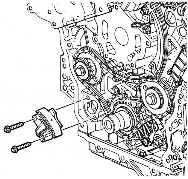

actually, if you park a manual vehicle facing up hill, you want to put the gear selector in reverse. you don't want to take any chance of turning your engine backward. some engines have hydraulically controlled timing components that keep tension on the belt or chain that synchronizes the crank shaft with the cam shaft/s. when the engine is running, oil pressure is directed to them, but with the oil pump not being driven, these can bleed off leaving some slack in the chain or belt.
looking at the front of the engine the crank shaft turns clockwise. the tensioner that keeps the belt or chain tight is located on the left hand side. the pulling force is on the right hand side of the chain, and the slack is on the left. therefore turning the engine backward can re-direct the slack to the right and in between this faze, it can cause the belt or chain to jump teeth throwing off the timing. this can cause engine damage when the engine is started again. the piston can come into contact with the valves that are controlled by the cam shaft "in some cases" causing them to bend. or best case scenario, it will run poorly or not at all.
1st gear facing down hill and reverse facing up hill to be completely safe. the lower the gear ratio the better. if you have a 4x4, putting the t-case in low4 is even better.

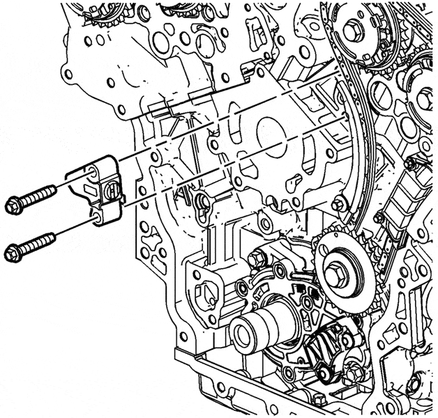

I'm an Ase certified technician with only 4 years experience, although I'm not what is considered a veteran technician, knowing not to rotate an engine backward is common knowledge and one of the first things taught in engine repair.
not all transmissions provide a lower reverse gear. some are the same as first gear.

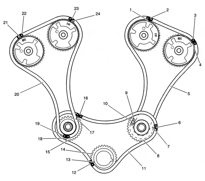

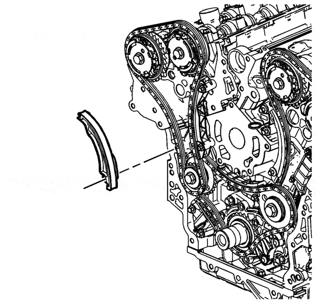

here are some of the timing components for the Chevy 2.8L, 3.0L, 3.2L, or 3.6L. as you can see, it is quite the complex timing system.
this is a hydraulic tensioner. it uses oil pressure against a small piston that moves out to apply tension on the chain.
this is the tensioner shoe that guides the chain. the hydraulic tensioner presses against this which in turn presses against the chain, taking up any slack in the chain.
this system uses three chains and three tensioners. so allot can go wrong.

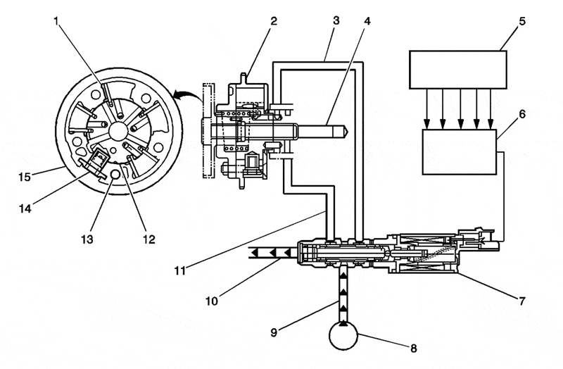

there are 4 cam shafts. 2 per side. on each side of the engine, 1 controls the timing of the air and fuel intake, and 1 controls the exhausting of burnt fuel vapors.
(1) Camshaft Actuator Vane
(2) Timing Chain Sprocket
(3) Engine Oil Pressure-For retarding the camshaft
(4) Camshaft
(5) Input Signals from Engine Sensors
(6) Engine Control Module (ECM)
(7) Camshaft Actuator Solenoid
(8) Engine Oil Pump
(9) Engine Oil Pressure Supply
(10) Engine Oil Drain
(11) Engine Oil Pressure-For advancing the camshaft
(12) Camshaft Actuator Rotor
(13) Camshaft Position Sensor Reluctor
(14) Camshaft Actuator Lock Pin
(15) Camshaft Actuator Housing
this engine also has the ability to control the timing of each cam shaft hydraulically in order to control:
• Engine power output
• Fuel economy
• Lower tailpipe emissions
NOTE: the hydraulic tensioners in this engine have a ratcheting ability which is sort of a fail safe. as the chain starts to age and stretch they ratchet out one click at a time. this holds them in place when oil pressure bleeds off. but they don't always do their jobs. oil and sludge build up can keep them from working. also, not all hydraulically controlled tensioners work in this way.
you seem interested enough that i figured you would appreciate this info.
