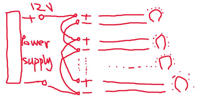

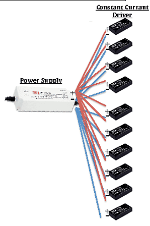

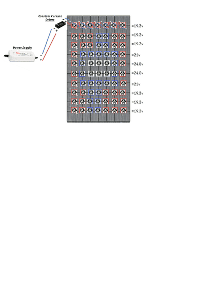

looked over all of the responses and tweaked the design slightly.
I am completely new to this and all of the feedback really helped.
Now that I looked into it a little more I see 1 Watt LEDs would ultimately produce the best plants, so I ditched the 5mm and went with these. RED 630nm, RED 660nm, Blue 450nm, and Warm White.
This was originally the array with 84 LEDs. It now consists of 70 1 Watt LEDs .
[URL=http://imgur.com/wrmHW][PLAIN]http://i.imgur.com/wrmHW.png[/URL][/PLAIN]
I know that the diagram above is NOT correct.
My question, is this possible or am I just pipe dreaming.
I know that I need some form of current limiter, or driver, but I am not sure what exactly.
is there anyway to use a smaller power source for this project? if so please let me know!
I really appreciate all the input I can get on this project thanks in advance!
jim hardy said:
well. i see forward voltages of 2.2, 3.5 and 3.2 volts at 30 milliamps.
one of each in a series string would add to 8.9 volts
IF you selected 12 volts as convenient,
your resistor would eat the remaining 3.1 volts
R = V / I = 3.1 / 0.03 = 103 ohms, 100 or 110 is nearest standard value
power is only 0.093 watt so a 1/4 watt will do...
Were I to build this, I would want to tweak the currents under full operating conditions by, e.g., tapping along an 82Ω with a string of small resistors in series. Otherwise, he could end up with currents being double what he'd planned for. A 12v wall wart could be anything from about 10.5v - 13v under full load, and small differences in diode voltages may accumulate.
In practice, the convenience of having a current source feeding each string may well be worth the extra effort of constructing it.
I'd look for a switched mode wall wart, much cooler running than the heavy iron + copper block.
OP needs to calculate the heat dissipated in the lights, too. Plants would probably enjoy a little warmth, but not excessive heat.
Also, OP hasn't addressed some questions I raised.
Your diagram is a good start...
just needs something to control current in each row.
There's always more than one way. The resistors i suggested are simplest, and cheap.
There are exotic LED drivers you could use
but there's no way to drive it with less power than it puts out.
You can use one supply, or several smaller ones.

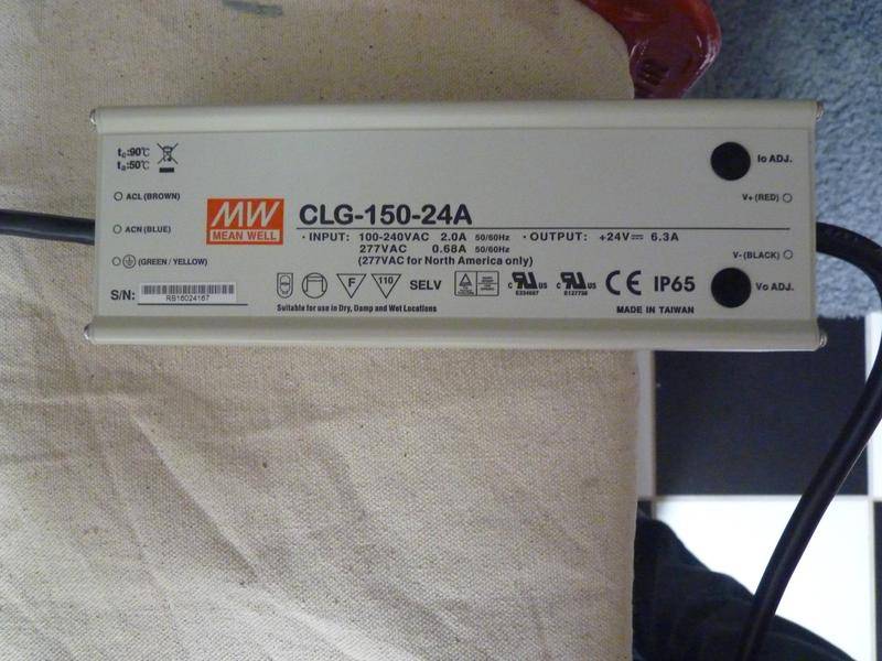

Here's a fairly beefy supply. its datasheet says it'll adjust +-10% so it should make 26 volts okay.
http://www.mpja.com/24V-45A-100W-Power-Supply/productinfo/16015+PS/
and another, beefier yet...
http://www.mpja.com/28V-108A-NAO-Power-Supply/productinfo/18927+PS/
both are regulated so should hold constant voltage.
dont use an unregulated one for LED's for reason NascentO2 mentioned,
unless you use constant current drivers instead of resistors to set current.
7805 datasheet shows how to use it for that purpose, but you'll want a 28 volt supply in order to have enough "headroom"

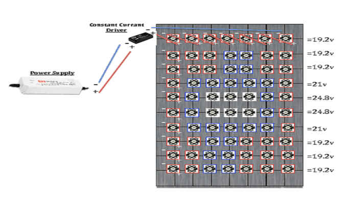

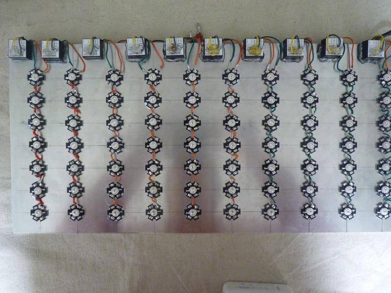

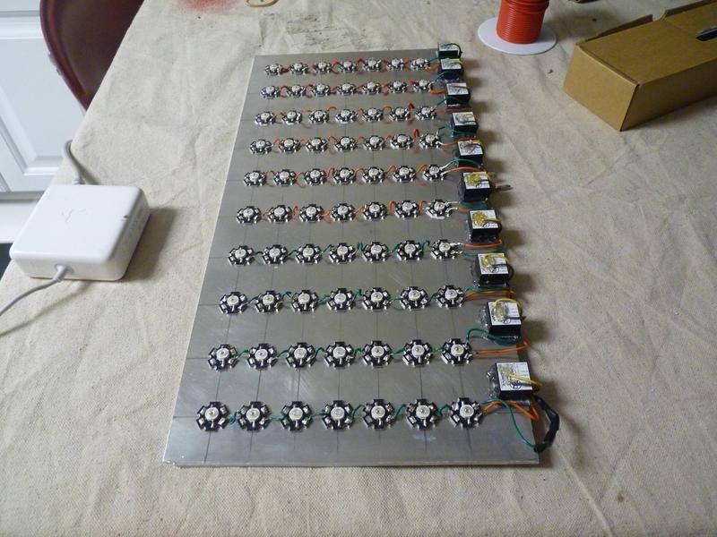

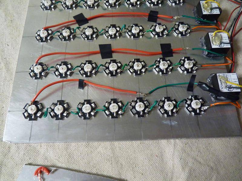

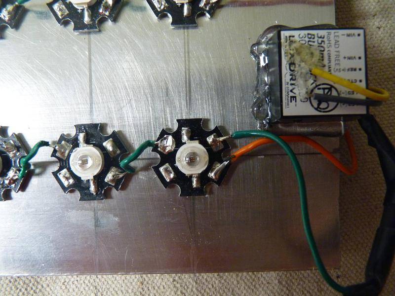

I've finally decided how I'm going to assemble the 70Watt (70x1W) LED array.
That dose not mean that I am ready to build it, not even close. I am posting this method so
that you guy's can let me know if it will work, and it probably isn't the most efficient method
so please, let me know, I am open to suggestions.
However if this is a really good way to wire em up then please let me know what
components I'm going to need, what I might need to know, I mean anything that can help.
All of the information on the LEDs in on this thread.
The image of this array is link to the site hosting it, and on that site you can edit so if you
ever want to use that too respond to this post you can.
only trouble i see is your white LED's are 750 milliamp
and others are 350 milliamp
so the white ones will be not at full intensity (probably okay)
check LM7805 datasheet for how to use it as constant current driver
and i count up 3.5 amps load
and please go back and either shrink or delete those [too wide wide wide ] pictures so this thread fits on a screen

Hey guys. Thanks for all the posts and advice, but I have a specific question I need help with.
if you look at the most recent diagram you'll see I'm planning on using
10 constant currant drivers to run each series of 7 LEDs in parallel. Okay got that figured.
Now I'm having issues with the power supply. I don't know how I am going to wire all of
Those currant drivers to one power source.
please if anyone knows please reply.
Jim, I saw that my LEDs weren't the same currant and am now looking for replacements.
The LEDs not being the same current will not be a problem if you group the LEDs together by type and configure the constant current supply to provide exactly the right current for each type.
The Warm White LED from Superbrightleds.com looks like it provides 180 lumens for 3 dollars each @750mA, and the one on newark says 80 lumens for 8 dollars, that's less than half as much light for more than double the price.
the constant current drivers can all go in parallel with each other, as long as the power supply is capable of handling the sum of all the currents. I hope you don't spend too much on the current drivers, the method I suggested would require about 1 dollar each
Hey guys I'm about to begin purchasing LEDs. when I'm all done Ill be sure to let you know prices.
But! alas i cannot move forward with this project, because I'm not sure how to wire all of the
constant currant drivers to the 24v power supply.I need to wire 10 parallel connections, and
for them to be parallel each driver will need to be directly connected to the power supplies
+ and - output. I haven't seen this done and am wondering if i just strip the + and - wires
then just "tie-in" or wire each positive and negative end of the driver to each singular
+ and - lead from the power source.
In my search for power sources I came across ones that said dual output. I am wondering if
I need multiple outputs, or if dual means it can hook up to two different arrays.
Please answer these questions specifically so I can begin to order a power supply.

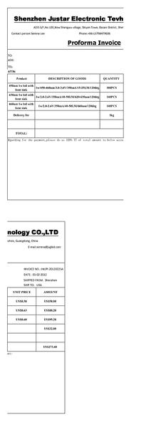

http://www.kutop.com/power-supply/indoor-power-supply/120w-switching-power-supply-ac-to-dc-12v-24v.html
LED SPECS
RED-1watt/2.0-2.6Volts/350milliAmps/40-50Lumens/620-630nanometers/120degrees
RED-1watt/2.0-2.6Volts/350milliAmps/40-50Lumens/660nanometers/120degrees
BLUE-1watt/450-460nanometers/3.0-3.6Volts/350milliAmps/15-25LumensM/120degrees
the attachment is the bill from the LED company. see how I did.

The constant current drivers can all be powered from a single pair of output terminals, provided the sum of the currents is within the current rating of the power supply.
I suggest that you fabricate only one current source to start with, and concentrate on getting it working and powering its group of LEDS.
Thanks for the reply, but could you be a little more detailed. Maybe you could you tell me if
the diagram with each driver separately tied into the output terminals is correct or if that's
not the right way to go about it.
Another question I have for all of the viewers. What gauge wire should I use.??
sketch on left is fine.
# 18 lampcord is easily good for 7 amps
I recently got some help from customer service representative Deng Tianxiong of Kutop.com. He sent me
the diagram below, and said this was the method to wire parallel circuits to the power source.
Is the above diagram more correct than the method I was originally going to use
depicted in the diagram below?
In this diagram each LED drivers positive and negative leads are connected to the positive
and negative leads of the power source output. In Deng Tianxiong's however each LED
series is wired together positive to positive, and negative to negative.
You guys have been a great help so far and I am asking again for your help. Thanks in
advance! :biggrin:
Imagine it as a plumbing problem.
Supply pipes are red and go to positive of supply, by hook or crook.
Drain pipes are blue and go to negtaive.
The two drawings you propose are electrically equivalent, just one is a "star" or "Radial" hookup (all wires radiate out from one point)
and other is a "loop" or "daisy chain" where they are strung together like Christmas lights..
use whichever looks better to you and will be easier to repair when that becomes necessary.
Answer perobably depends on where you physically locate the supply.
i wanted to keep all of the diagrams the same style so I made this one up.
I'm pretty sure this is what Deng Tianxiong's diagram would look like.
Please let me know if it is or not.
sorry I am not sure why but I couldn't resize the picture.

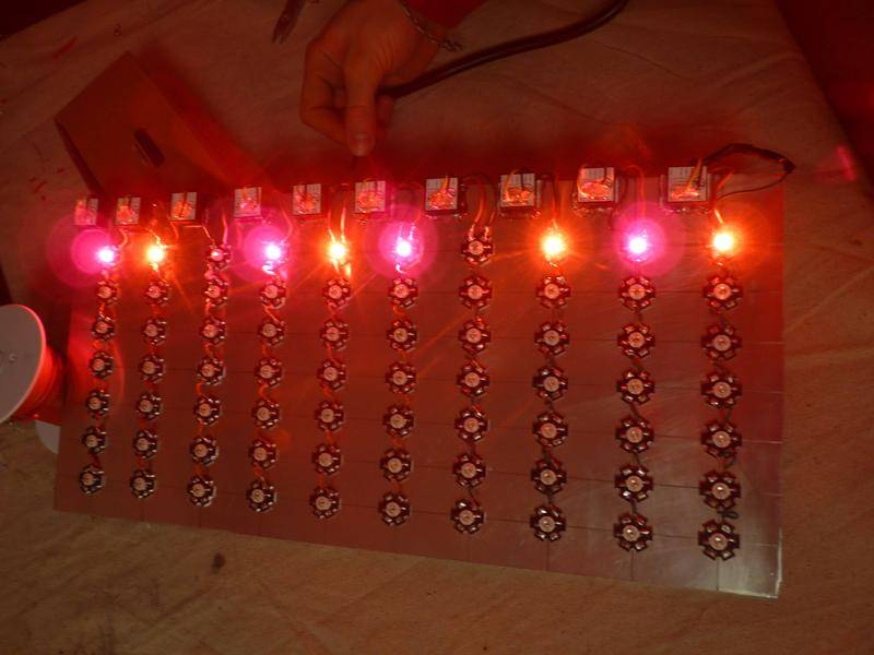

Hey guys I havn't made a post in a while, but I have an update on this project.
I got all of the supplies I needed to complete the 70 WATT panel so I went ahead and did it
Looks pretty dam good you might say...WRONG!
I was really sure of my method so I wired everything up and never stopped to test, and this is what it got me.
I think there are two duds which doesn't say much for the quality of the LEDs, but besides that the series connections don't seem to be working.

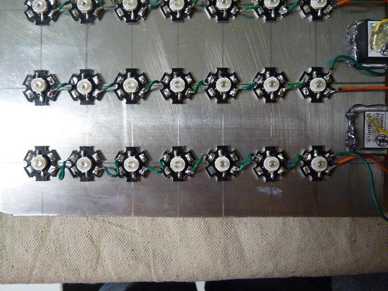

heres a few close ups of how I wired them maybe someone could give me a little insight on how to fix this.
P.S. here is the power supply I am using maybe this has something to do with it as well.
  • #31
Thanks for taking the time to report back.
I couldn't find any reference in the thread as to the wiring definition of the LEDs base terminals. (edit: oh wait. Yes there is. Let me read it first) Guessing here that the green "-" supply should be on the last LED in the string?
  • #32

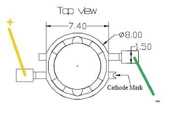

what's IN and what's OUT on your LED's ?
Clearly, current is only going through the first one of each string.
One of those wires from each constant current driver needs to go to LAST LED in its string...
so the current will go through all of them before returning to supply.
You had it right a couple weeks ago, , take a look at the sketch in your post of Feb1-12 11:49 PM.
Where's the wire going to last LED, that blue wire at top of panel? I thought you were showing it as 'typical " for all rows.
Looks like you hooked it to first LED instead.
Good thing you had that constant current driver in there !
  • #33
Looks like your green negative supply should be on the last LED. Here's the diagram from your link, with my green and orange annotation.

  • #34

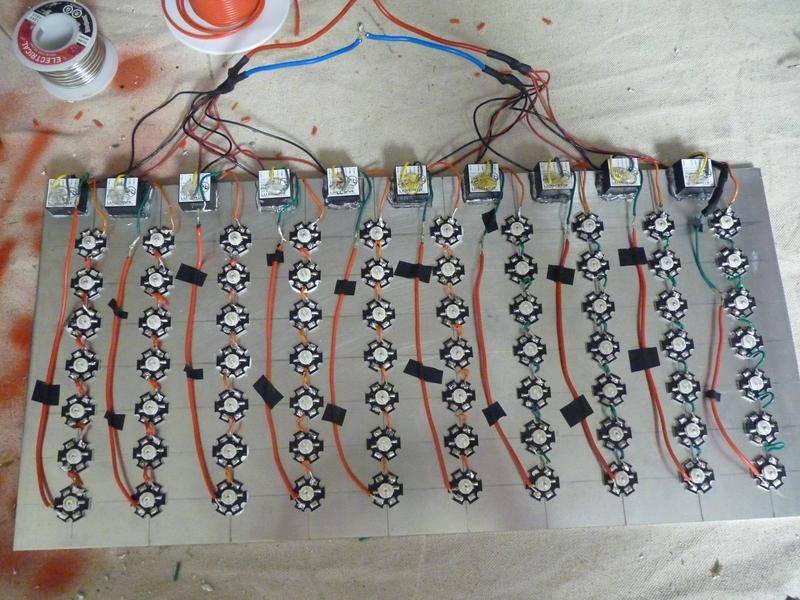

Yeah, Thanks for the replies guys I relized my mistake only after posting. I fixed the problem and am still having troubles so I am turing again to you.
here it is all fixed up
The electrical tape is only temporary.
Heres is it all Lit up.
Even though its not perfect yet, it still looks pretty cool. I also replaced the first two LEDs in line 10 and it is now lighting perfectly.
Problem 1- as you can see the LEDs in lines 1,2, and 8 are lighting but very dimly and I am not sure why.
Problem 2- line 9 is not lighting at all, like power isn't even reaching it.
Im not sure where these problems originate from or what could be causing them, but I need to solve these problems in order to move forward with this project. You guys have been a great help so far and I am hoping that you all have a bunch more advice to give.
P.S. It may have something to do with how the drivers are wired to the power source?:confused:
