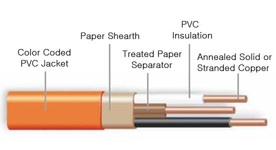

well, think about it.. if the two conductors going to the switch have capacitance between them, as they do in typical houswiring
that capacitance shunts a feeble current around the switch. It may be enough to give an LED a feeble glow .
Hi Jim. This is particularly true for wires in a "two way" switch. Here you can often get a fairly long run where the "dead" wire runs directly in parallel (usually in the same cable) with a live wire. My back of the hand calculations suggest that you could get about one nF of coupling there and a corresponding parasitic current of about 50uA. Probably enough to dimly light a high efficiency LED.
That's what it is and a 100 watt light bulb running on AC would give off light to, but it is to big of a load to see the light, but do you pay for this type of current or would this type of current have been lost anyway even if there was no light in the socket? Also in house wiring it does not only have to be two way switch just the hot wire coming down to the switch along side the wire going to the light will be close enough.
