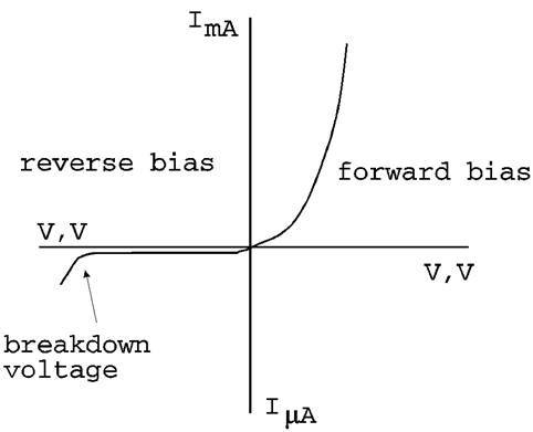

So the relationship between current and voltage is linear like with a resistor. I have always assumed that this doesn't matter for an LED, as the main reason there is a voltage across this is because energy has been converted to light, (like a resistor does as heat). This is unlike a diode whose "resistance" changes as you change the voltage across is.
