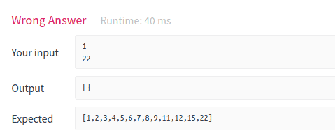

However, when I copy the code into leetcode I get the following:
Leetcode:

And the output when compiled is :
But I can't seem to understand why it works fine in the online compiler but not there. Any ideas?

Do you really think the code is exactly the same? There are quite a few differences, and if you click the blue button that says "Spoiler" you will find I have pointed you to where the critical one is.

[Edited for clarity] Line 40 in the "Leetcode" code block in your OP has the same indentation as line 38 which is a return statement so it will never be reached (in the 'marked up' code below these are lines 36 and 33).

Python:
# This starts a definition of a class.
class Solution(object):
    # This starts the definition of a member function of the Solution class. It can be invoked
    # as Solution().selfDividingNumbers(1, 22) which is presumably what the test code does.
    def selfDividingNumbers(self, left, right):
        # This starts the definition of an inner function which can only be accessed within the
        # definintion of its parent, selfDividingNumbers.
        def Checker(dig, number):
            # This ends the definition of Checker but the else statement is unnecessary and
            # potentially confusing because the last line of the function has extra indentation.
            if number==0:
                # The brackets are unnecessary here and misleading as it looks as though you
                # are trying to call a function named return.
                return(False)
            else:
                # Agian the brackets are unnecessary but because of the compound statement
                # they do add a bit of clarity; personally I wouldn't use them in this case but if
                # you are going to use them you should put a space after return to avoid it
                # looking like a function call.
                return(dig !=0 and dig % number==0)
            # This is a better way. Note also the consistent use of spacing around ==.
            if number == 0:
                return False
            return (dig !=0 and dig % number == 0)
        # This starts the definition of another inner function.
        def All_Divsable(n):
            # This statement will always execute
            return(True)
            # This statement will never be reached!
            L=[]
            for i in range(left,right+1):
                if All_Divsable(i)==True:
                    L.append(i)
            return(L)
