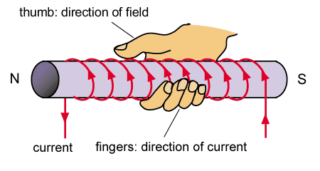

Left Hand Rule Applied to a Winding
In summary, the direction of force in a DC motor is determined by the current in the coils and the direction of the magnetic field.
jake jot
302
TL;DR Summary
If the winding has equal current and directions in each side. They cancel out. So how do you determine the principal force directions?

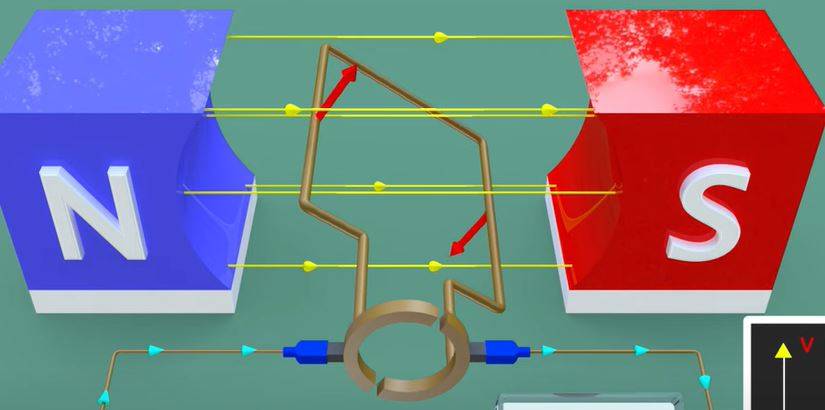

All illustrations of direction of force in motor has this form.

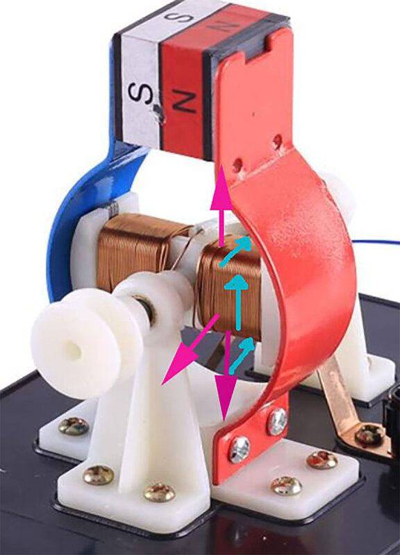

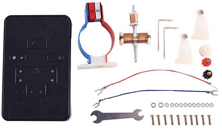

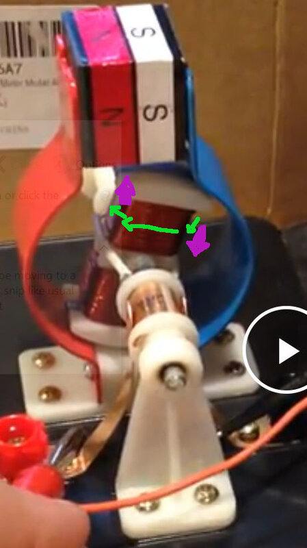

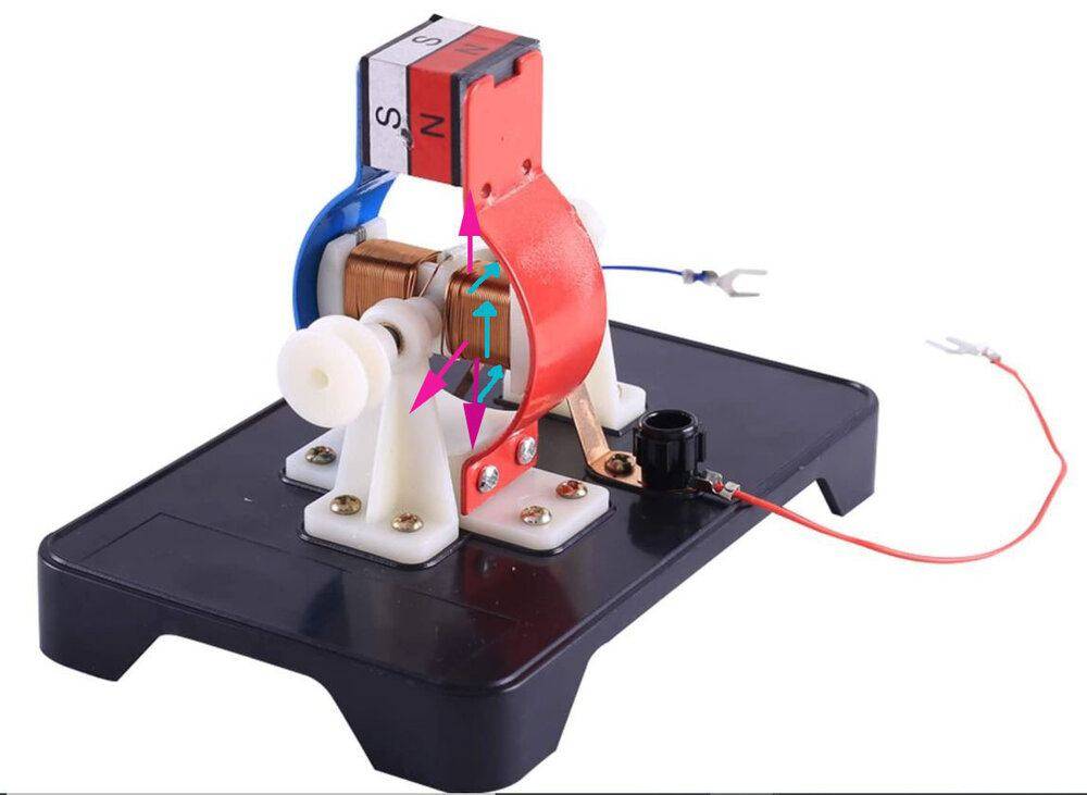

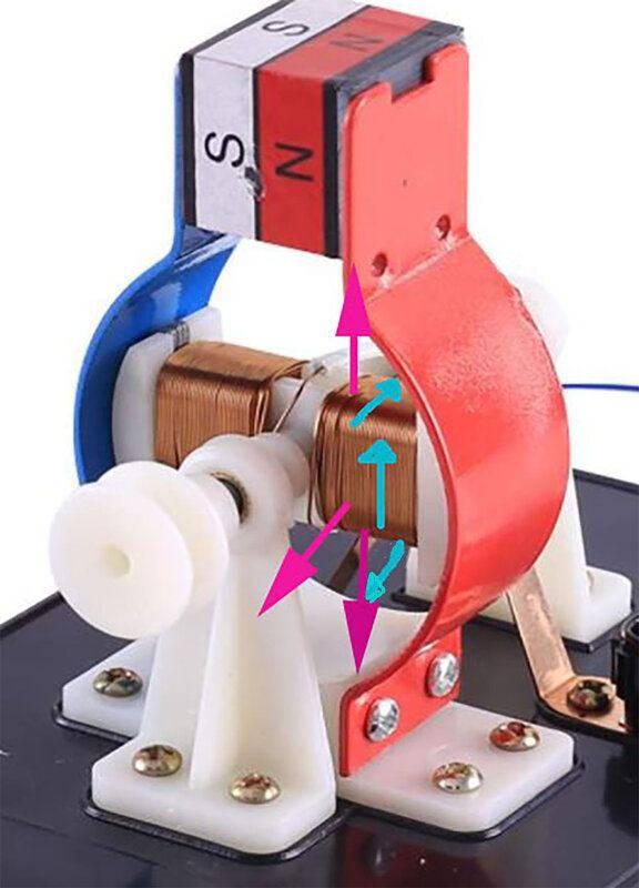

For the following specifically the rotor. I'm confused where is the direction of force. It uses winding and there seems to be current and force in every side of the winding (applying left hand rule). So where does the principal force really point? I've been figuring this out for days. So hope someone can give aid.
This is video of the motor running.
https://d2y5sgsy8bbmb8.cloudfront.n...rm-Generic-480p-16-9-1409173089793-rpcbe5.mp4
It's from amazon science kit. https://www.amazon.com/gp/product/B073GXWQMV/?tag=pfamazon01-20

Is the current in CD really running in the same direction as in AB ?
Here is zoom of the center.
Where is CD and AB?

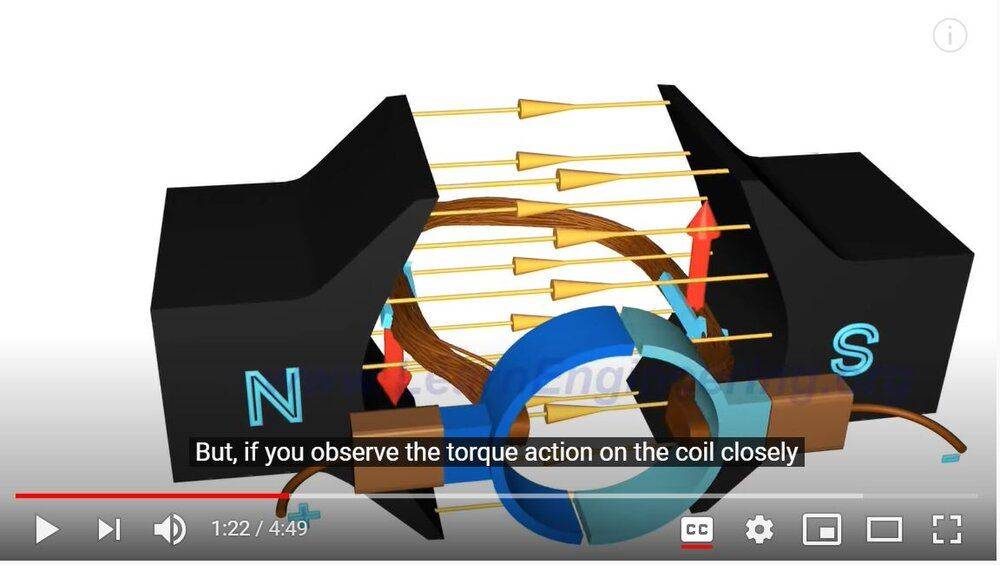

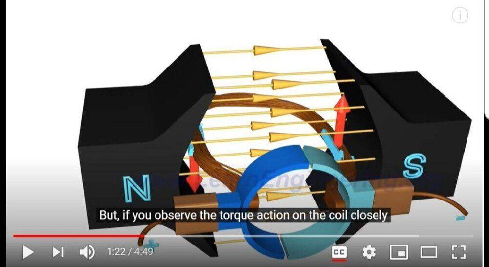

BC and AD rotate in plane of field, so cross product (force ) is always perpendicular to that plane, ie axial and produces no rotation.AB and CD : currents may be equal in magnitude and direction, but as vectors they are opposite in sense. Field stays the same, current is opposite, so force must be opposite.
If in doubt, I draw in a few field lines then look at them as Faraday describes.

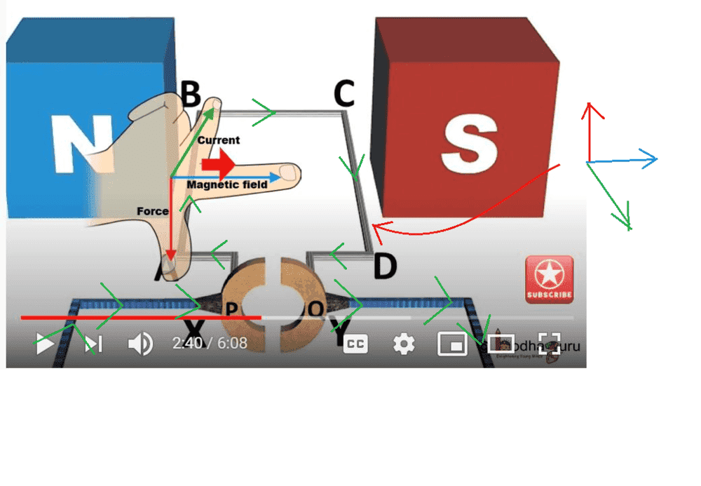

no problem about it, but how do you apply it to the following where the winding has 4 sides unlike the above?

I understand the above. No problem with this.
DC Motor, How it works? - YouTube
It's obvious. But in the following, the conductor is in form of windings at all sides, and they seem to cancel so where is the EMF force directions at the right and left?

Again, the (now) vertical wires give axial forces, so irrelevant.
The now horizontal wires have up and down forces, top up and bottom down. But, that's because they are at the changeover position, when, in fact, there should be no current flowing.
If you imagine the rotor turned 90 deg ACW, so that the coils are top and bottom, and keep the direction of the current as shown here, then the wires on the LHS get an upward force and those on the RHS a downward force, giving a CW torque. If the current is in the same sense in both coils, that applies to all the wires in both coils.
You could of course simply imagine the rotor as an electromagnet. As shown in the pic, viewed from the right, the current is CW, so it looks like a S pole and is attracted to the N pole, which is where it is. From the left current is ACW and looks like an N pole being attracted to the S pole where it is. No reason to turn.
When the rotor is turned 90 deg ACW as above, the S pole is at the top and is attracted to the N pole on the right. Similarly the N pole of the rotor is now at the bottom and attracted to the LH S pole. A CW torque, just as produced by the, up on the left, down on the right, forces above.
TBH I've no idea how to analyse this sort of rotor, with an iron cored rotor and shaped field poles. You probably need and electrical engineer for that. (I expect Jim Hardy would have known). I just knew the basic principle of the motor with wires in a uniform field, as taught in Physics textbooks. After that I just put my faith in Eric Laithwaite's principle that the more iron and copper, the more efficient the motor! It's actually always puzzled me that the wires in most motors don't seem to be in any magnetic field: nearly all the flux seems to go through the iron, bypassing the wires. The magnetic flux "links" the coils and I've seen analysis of transformers based on that idea, but not motors. It's probably my bad understanding of field and flux.

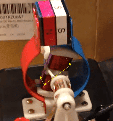

In the amazon motor above. Do you think the entire curved blue and Red metal body is the magnet or is the magnet only at the top. I gave the product to a kid and it isn't with me now. But I'll borrow from the kid again later this week.
Yes. The iron shell guides the flux from the magnet at the top and produces a horizontal field around the rotor.
Your first diagrams used two magnets one on each side of the rotor. The field can be strengthened by joining the outside faces with iron, completing the manetic "circuit".
Early motors sometimes used horseshoe magnets to have the same effect.
This idea is very economical because you need only one simple magnet, then the cheap shaped piece of iron brings the field to where you want it.
Likes jake jot
Hello Jake,
No need to re-post the same image five times. I do wonder who drew the blue current lines on it, though. If they are correct, the motor is in a stable stalled position. The current should be reversed to create a north pole on the righthand side of the coil. Like @Merlin3189 , I suspect the brushes are at or near the point of reversing the current direction.
Did you notice Amazon makes a mess of the pictures by attaching the red iron arc to the south permanent magnet pole in half of them ?

I drew the blue current label. After i drew it. I got stuck thinking how it could move. So the secret lies in reversing the current. Thanks for the ideas.
Yes. Basically you force the poles of permanent magnet and electromagnet to be equal at the moment shown in your picture, so they repel each other and the rotor keeps turning. The brushes take care of that.

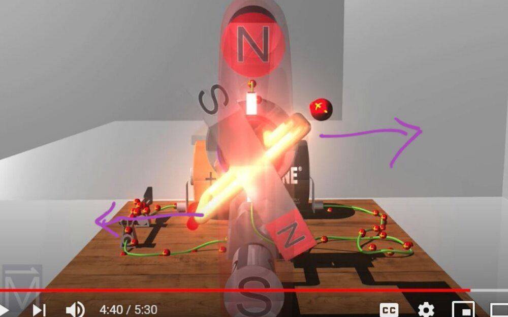

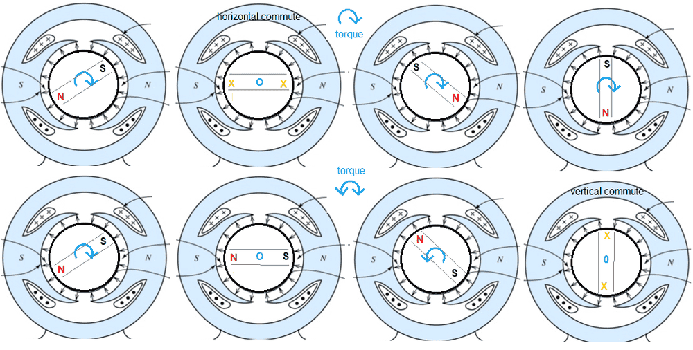

But notice in the following rotor that the north and south pole depicted in the right and left side label is 90 degrees off the lorentz force which comes out of the conductor (remember all the up and down arrows in the conductors depicting the directions of the lorentz force?
What are we looking at ? Current in top horizontal part of the coil is coming towards us, lower away from us. Where is the permanent magnet field and which way is it pointing ?
Even without the stator or permanent magnet. The rotor has north and south that is perpendicular to the wires. It is the wires which is source of direction in the left hand rule and the lorenz arrows come from wires. This means north, south is not identical to the force direction. Right? Let's say it doesn't produce any force directions. Can the rotor rotate if there is present of stator or permanent magnet around it?

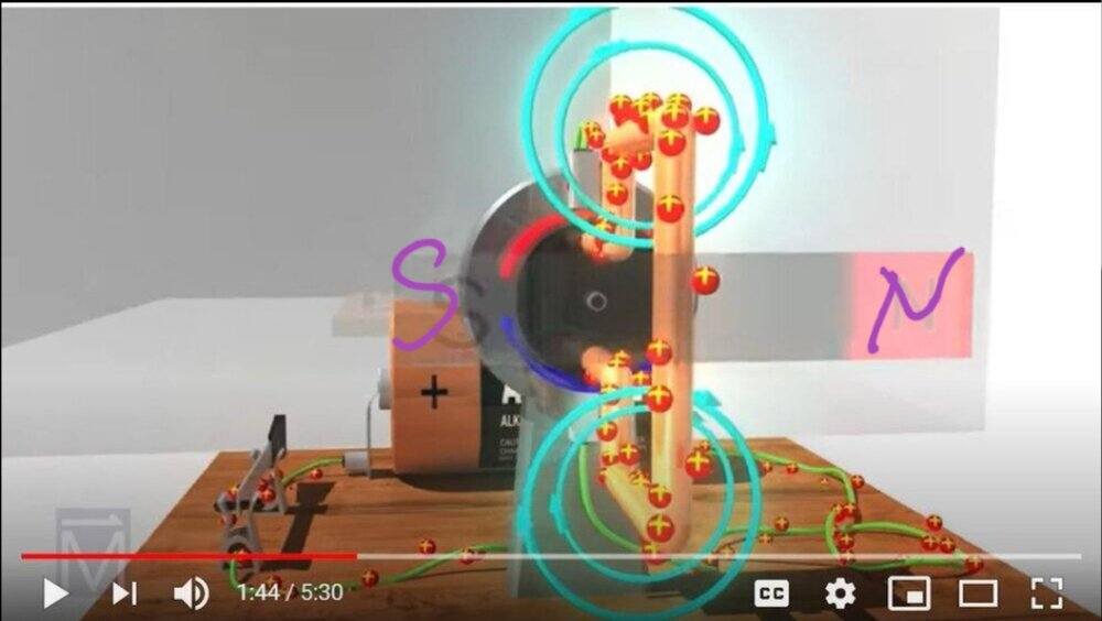

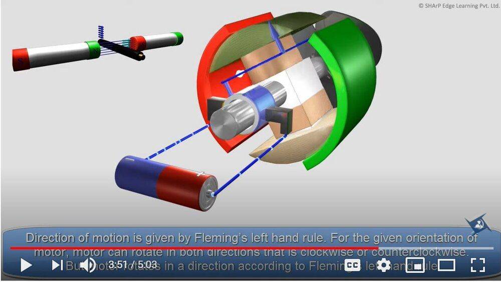

Here is to illustrate the point. Some demo in youtube only uses north, south and not the direction of force. I think you are saying it's two side of a coin. But let's say we won't use the "direction of force" explanation. Can one explain completely the action of the north, south, commutator in the rotor with respect to the permanent magnet? So the reason the rotor rotates is because the magnetic pole is attracted to the opposite side and this rotates the rotor? But the magnets kinda too far, is the north/south style of explanation able to stand alone (by suppressing the more powerful lorentz force explanation (i drew the violet lorentz force directions in the following)?
How DC Motors Work - YouTube
Correct, that is what I am saying.
We can go round in circles infinitely, but by now I don't think I still understand what your core question is.
Yes, because it is the same thing

The point of Science is to build models that represent physical reality and which will allow you to predict and explain things interns of actual values. That always involves some Maths. The Lorenz force can be calculated in principle for any situation and it can (could) tell you the torque on any motor design that you can specify.
  • #34
sophiecentaur said:
I can't think of any good reason to try that and I couldn't even begin to work out how I could add up the different 'tendencies' of each of the coils to point in a direction. You can't add up 'tendencies' because you haven't quantified them (unless you have some pretty revolutionary Maths) so afaics, it's a waste of time - except for the most elementary of elementary treatments of the Motor Effect.
Yes I believed you. And I've looking for different motor designs at google images to see example of "one with multiple coils at different angles around the axis". Are you talking of DC motors or induction AC motors? An example is this:
What kind of motors should I look for that satisfy "one with multiple coils at different angles around the axis". Can someone share? Merlin3189? Thanks.
  • #35
Those images are examples. The windings are not all in one plane. Their planes are all at different angles and the axis of rotation doesn't pass through the planes. I can't imagine how that could be re-drawn with equivalent bar magnets in their place.
