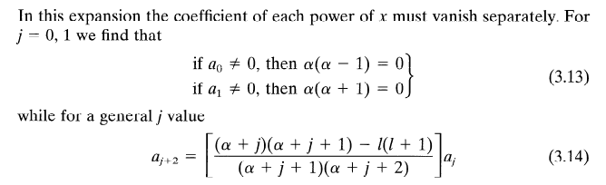

I'm reading through Jackson's Classical Electrodynamics book and am working through the derivation of the Legendre polynomials. He uses this ##\alpha## term that seems to complicate the derivation more and is throwing me for a bit of a loop. Jackson assumes the solution is of the form:
Inserting this into the differential equation we need to solve,
we obtain:
He then says:
which I agree with. The issue I'm having is with the next statement:
First, in saying the two relations are equivalent, I assume he means that if ##a_0 \neq 0## then we have ##P(x)_{a_0 \neq 0} = P_{\alpha=0}(x) + P_{\alpha=1}(x)##
##= a_0 +a_1*x^1+a_2*x^2 +...## ##+## ##a_0'*x^1+a_1'*x^2+a_2'*x^3 +...##
whereas if ##a_1 \neq 0## then we have ##P(x)_{a_1 \neq 0} = P_{\alpha=0}(x) + P_{\alpha=-1}(x)##
##= a_0 +a_1*x^1+a_2*x^2 +...## ##+## ##a_0''*x^{-1}+a_1''+a_2''*x^1+...##
and, setting ##a''##=0 to avoid the potential blowing up at x=0, ##P(x)_{a_0 \neq 0}## is basically the same as ##P(x)_{a_1 \neq 0}##, since each can be expressed as an infinite series in the form of ##c_0+c_1*x^1+c_2*x^2+...##. Therefore, we can choose either ##a_0 \neq 0## or ##a_1 \neq 0##.
But then he says we can't have both ##a_0 \neq 0## and ##a_1 \neq 0##, which I don't quite follow. If they were both 0, we'd need ##\alpha \equiv 0 ## (to satisfy his eq 3.13) and the solution would be of the form ##a_0+a_1*x^1+a_2*x^2+...##. What's wrong with that at this point in the derivation?
I recognize that eventually we will see that either ##a_0## (and ##a_1'## ) or ##a_1 ##(and ##a_0'##) must equal 0 for the solution to be finite, but that's at a later stage in the derivation. At this stage in the derivation, what's wrong with still assuming ##a_0 \neq 0## and ##a_1 \neq 0##??
I also recognize that I may be mucking things up due to staring at this for far too long..
Thanks!
I don't think it was meant to be over-analyzed. If ## a_1 \neq 0 ## then there is a possibility that ## \alpha=-1 ##, but if ## a_o \neq 0 ##, this possibility does not exist. ## \\ ## Editing... I don't quite follow J.D. Jackson's logic either, because what about ## \alpha=0 ## ? I'm going to need to study it further...
An additional look at these formulas shows that when multiple terms are included in these polynomials, for the different integer values of ## l ##, they only contain even or odd terms. That seems to be the purpose of assuming ## a_0 \neq 0 ## or ## a_1 \neq 0 ## but not both at the same time. The actual solution can contain both even and odd terms, but there are no constraints between the even and odd terms of the series solutions.

Let's start by considering the case [itex] a_0 \neq 0 [/itex]. In this case we have [itex] \alpha = 0 [/itex] or [itex] \alpha = 1 [/itex]. Let's consider what happens when [itex] \alpha = 0 [/itex]
In this case the expression for general [itex] a_{j+2} [/itex] is
[itex] a_{j+2} = \frac{j\left(j+1 \right)-l\left(l+1\right)}{\text{not zero}}a_j[/itex]
we are looking for a polynomial where [itex] a_j =0 [/itex] for all [itex] j>j_{max}[/itex]. There are two ways that this can happen. The first is that the seed coefficient [itex]a_0[/itex] or [itex]a_1[/itex] is equal to zero. Or in the second case the numerator [itex] j\left(j+1 \right)-l\left(l+1\right)[/itex] has to equal zero for some values of [itex] j[/itex]. In our case the numerator only equals zero if [itex] j = l [/itex] or [itex] j = -l -1 [/itex]. Note that the two solutions have opposite signs. This implies that there is only 1 positive j for a given l for which the numerator will be zero. If l is even then the coefficients for the even series will be zero ([itex]a_n=0[/itex]) for [itex] j>l[/itex] but the coefficients for the odd series will never zero unless [itex] a_1= 0 [/itex] . Thus if [itex] a_0 \neq 0 [/itex] and [itex] \alpha = 0 [/itex] then we need [itex] a_1= 0 [/itex].
If you repeat this analysis for [itex] a_0 \neq 0 [/itex] but [itex] \alpha = 1 [/itex] you will see that [itex] a_1= 0 [/itex] by the same logic. This gives us two linearly independent solutions. One solution is odd in x (this is the [itex] \alpha = 0 [/itex] case) and a second solution that is even in x (this is the [itex] \alpha = 1 [/itex] case).
If you consider the case [itex] a_1 \neq 0 [/itex], then by the same logic you will find that [itex] a_0 = 0 [/itex] and you will get an even and an odd solution. The even and odd solution that you find will be the same solutions you found for [itex] a_0 \neq 0 [/itex] but the indices will be shifted by one.
For Jackson the above explanation is a "moment's thought."

This is just the usual Frobenius method. I'd not do it this way, because it's complicated compared to the elegant algebraic method used in quantum theory (I'd teach electromagnetism after QM, but that's another subject).
So you make the ansatz
$$P(x)=\sum_{j=0}^{\infty} a_j x^{j+\alpha},$$
where ##\alpha## has to be determined as well as the ##a_j## from the differential equation. It's now clear that you can without restricting generality that ##a_0 \neq 0##, because if ##a_0=0## you just have to redefine ##\alpha## to get the same series.
If you choose ##a_0 \neq 0## then you get either ##\alpha=0## or ##\alpha=1##. So you can set ##a_1=0##, because you get all solutions, because the case ##a_1 \neq 0## and ##a_0=0## with ##\alpha=0## leads to the same series as choosing ##a_0 \neq 0## and ##\alpha=1##.
