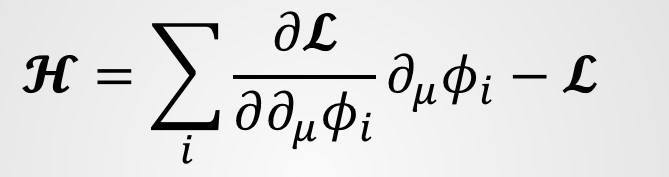

I'll call them L density and H density for convenience :)Anyway, the derivation of the H density from L density using Legendre transformation confuses me :(
I thought because parameters of them are space-time components, it should be
But I found that this is related to the De Doner - Weyl Theory,

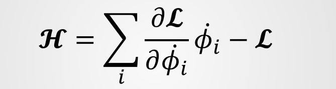

and the H density used in textbook is
where the dot represents time derivative.So, my question is,
why we consider Legendre transformation on only time derivative of phi ?
Is it just 'defined' to consider energy of the system?
Then what does the covariant H density defined in the De Donder - Weyl theory mean?
From the lagrangian density [itex]\mathcal{L}[/itex], you can define the canonical stress-energy tensor [itex]\mathcal{T}[/itex] as follows:
[itex]\mathcal{T}^{\mu \nu} = \dfrac{\partial \mathcal{L}}{\partial \partial_\mu \phi_j} \partial^\nu \phi_j - g^{\mu \nu} \mathcal{L}[/itex]
This is a conserved current in the first index:
[itex]\partial_\mu \mathcal{T}^{\mu \nu} = 0[/itex]
Then you can define a hamiltonian density [itex]\mathcal{H}[/itex] in terms of [itex]\mathcal{T}[/itex]:
[itex]\mathcal{H} = \mathcal{T}^{tt} =\dfrac{\partial \mathcal{L}}{\partial \partial_t \phi_j} \partial^t \phi_j - g^{tt} \mathcal{L}[/itex]
This is the same as the expression in the textbook, if you're using the metric where [itex]g^{tt} = +1[/itex] and defining [itex]\dot{\phi_j} = \partial_t \phi_j[/itex]
The hamiltonian is the integral of the hamiltonian density over all space:
[itex]H = \int d^3 x \mathcal{H}[/itex]
It's the hamiltonian, not the hamiltonian density, that is constant:
[itex]\dfrac{d}{dt} H = 0[/itex]
