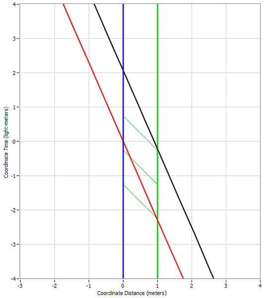

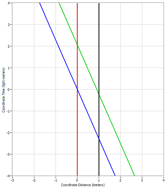

I'm going to draw some spacetime diagrams to depict the various possibilities of your scenario to illustrate why Peter is so adamant about getting you to nail down exactly where you want that AND gate to be. That is what this problem is about, not what happens when you transform to the rest frame of the meter stick. That is a trivial application of the Lorentz Transformation process which will automatically resolve what happens in different frames.
bmbuncher said:
So, from what I understand, when the meter stick is traveling extremely fast, it experiences length contraction (say, it is traveling fast enough to contract to 0.9 meters), and so it will never obstruct the path of both lasers simultaneously; therefore, in the frame of reference where the lasers are still and the meter stick is moving, no electronic pulse will be created, and so the light will not turn on.

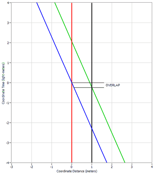

The first spacetime diagram is for the rest frame of the lasers without any electrical signals. We'll call this the apparatus rest frame. The units for time are light-meters, the amount of time it takes for light to travel one meter, which is also about 3.3 nanoseconds:
The two receivers are shown in blue and green, one meter apart and the meter stick, moving to the right at a speed of 43.589% of the speed of light is Length Contracted to 0.9 meters. You can see this clearly at the Time Coordinate of zero. The endpoints of all lengths must be specified at the same Coordinate Time, in other words, horizontally on the diagram. The front end of the meter stick is shown in black and the rear end is shown in red.
Clearly, the two receivers do not detect the presence of the meter stick at the same time. In fact there is a gap of about 0.2 light-meters between the blue receiver detecting the red rear end of the meter stick and the green receiver detecting the black front end of the meter stick. So your mission is to decide where to put that AND gate so that it will not detect a meter stick traveling at relativistic speed across the two receivers.
bmbuncher said:
However, in the frame of reference that the lasers are moving and the meter stick is still, the distance between the lasers will contract (say, to 0.9 meters), so both lasers will be obstructed simultaneously, and so the light will turn on.

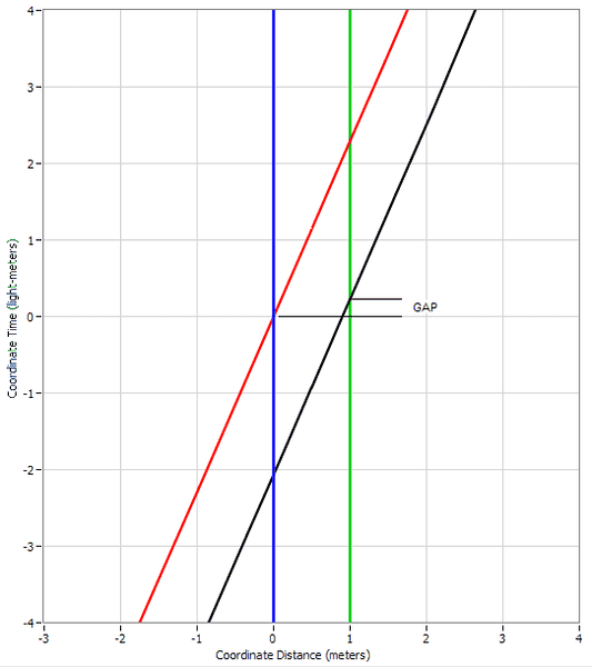

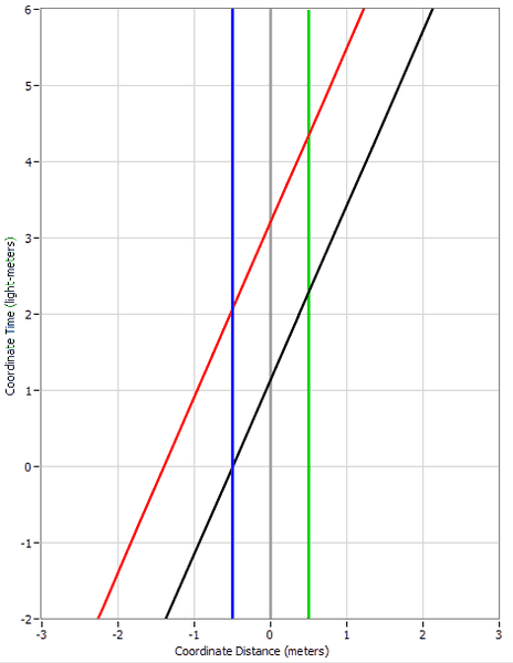

Here is a diagram for the rest frame of the meter stick:
You are correct that the distance between the laser (and receivers) is contracted to 0.9 meters and that there is a time interval when both lasers are obstructed simultaneously but...
bmbuncher said:
When I posed this to the professor, he said that the observation in both frames of reference should be analogous because causality must be preserved; therefore, the light will either turn on in both scenarios, or will not remain in both scenarios. He said that, while the length contraction will occur in both scenarios, the time dilation caused by special relativity should "balance this out" so that the same result occurs regardless of the frame of reference. However, I am still somewhat confused. In this scenario, how does time dilation cause the light to behave similarly in both frames of reference? Can anyone explain what is going on in this scenario that prevents causality from being violated? Thank you!
...as your professor said, if the light does not turn on in one frame, it won't turn on in any other frame and we already decided that in the apparatus frame the light shouldn't come on so if you can arrange things so it doesn't come on in the apparatus frame, then it won't come on in the meter stick frame.
However, your professor is not correct about Time Dilation having anything to do with what happens in this scenario. But we'll leave the explanation until after you finish specifying how the light is hooked up to the receivers.

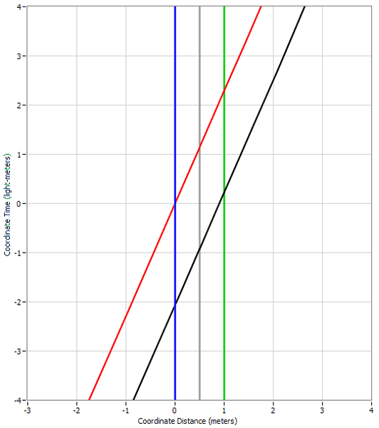

In the mean time, we can investigate the possibility of having just one electrical signal. Let's suppose you decide to put the AND gate at the location of the green receiver. Then the blue receiver has to send the electrical signal to the green receiver where the AND gate is located. For the sake of simplicity, we will assume that the electrical signal travels at the speed of light.
Now let's see what happens:
Clearly, this isn't going to work because the last part of the detection from the blue receiver overlaps the first part of the detection from the green receiver by about 0.8 light-meters.

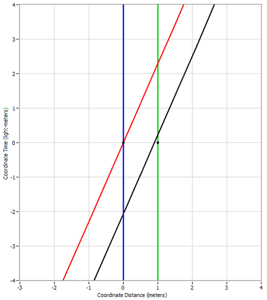

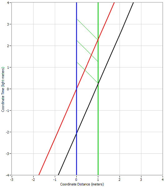

So let's try it the other way around. Let's send the electrical signal from the green receiver to the blue receiver and put the AND gate at the blue receiver:
This does have the desirable effect of not detecting an overlap but will it work if the meter stick is traveling in the other direction? We don't want to have an experiment that works differently in two different directions:
Well this has the same problem as the first method so I think we can only conclude that we're going to need two electrical signals and put the AND gate somewhere other than at one of the receivers. That's your problem: tell us where to put the AND gate and make sure it works with the meter stick going either way.

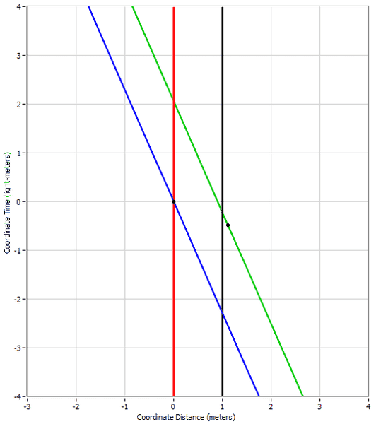

Here's what I'd like you to do if you are willing: copy this image and paste it in your favorite drawing program and add in some of the electrical signals (traveling at the speed of light) to represent the beginning, midpoint, and ending of the reception of the detection of the meter stick similarly to what I did in post #22 except that the signals will terminate at the grey line. Then upload it and describe why the light will not come on.
If you can do that, I will upload another diagram transformed to the rest frame of the meter stick and you can repeat the process to see how the light bulb will still not come on. Can you do that? If you don't want to, I'll do it for you but I think it will be more meaningful to you if you do it yourself.
Here is a spacetime diagram based on Peter's coordinates in case you prefer to use his to add the signals in:

...does this answer enough to be able to analyze the question?
As I said in post #27, yes, it does, but now the question is, are you analyzing the question or are you waiting for someone else to do it?
He doesn't have to wait; between us we've already done the analysis.
  • #31
Not quite. You told him what to do in post #26 and what he should find but no one has yet posted the transformations to the rest frame of the meter stick:
PeterDonis said:
Now it's just a matter of using the Lorentz transformation with v = 0.436 to find the coordinates (t', x') of all 6 of the above events in the meter stick rest frame. You should find that event #4 still happens before event #6 in that frame, so the bulb still does not light. But you should also find that event #3 happens *after* event #5 in the meter stick rest frame, which is what was confusing you: the two ends of the meter stick do cover both receivers simultaneously in this frame. But as the above analysis shows, that's not what determines whether the bulb lights; what determines that is when the signals reach the AND gate, i.e., events #4 and #6, *not* events #3 and #5.
  • #32
The analysis of the signal really is unnecessary and I see no point in complicating life with it. It really just is the pole-in-barn paradox. The lighting of the lamp can be assumed to occur if both receivers are covered simultaneously in a given frame. If this frame is the rest frame of the receivers, the lamp will not light. An observer in the rest frame of the pole will not think the lamp should light up simply because (s)he can compute that the receivers have never been simultaneously covered in the receiver frame, which was the criterion for lighting the lamp. Dealing with signals is just going into detail about how such a device would be constructed, but adds nothing in terms of physics.
  • #33
Then you missed the point of the problem.
No it's not. This problem was ambiguously stated. Didn't you read PeterDonis's posts or my post #22?
That is so untrue. What is important is the relative lengths of the two wires (or fiber optic cables) coming from the two receivers to the AND gate. The lighting of the lamp is independent of which frame the receivers are covered simultaneously in.
Different frames will not change what actually happens. All frames will analyze the exact same result. Several posters, including myself and Peter, have noted that in the rest frame of the meter stick, the receivers simultaneously detect the meter stick, and yet the light does not light. The question is, why?
The light and all the wiring between it and the receivers and the AND gate don't know or care what an observer thinks or analyzes.
Of course the construction is part of the physics and needs to be part of the analysis if the scenario is going to work as intended.
If you would read the OP, you would see what the problem is:
The OP stated that there were two receivers one meter apart and an electrical signal connecting them to a light. Obviously, this is impossible. There need to be two electrical signals connecting them through an AND gate (or equivalent) to the light. The details of how these are constructed alone determines whether the light will behave in the intended manner, not some analysis based on simultaneity according to a given frame. After prodding, the OP did fill in the missing details and posted a complete description of how the wiring could be constructed so that the scenario would work as desired. Now all that is left is the analysis for both frames.
Remember the OP's questions:
Those questions have not been answered and I was hoping that with enough help the OP could answer them himself and that's why I asked him if he was working on it in post #29 and I'm still waiting for his answer.
  • #34
Ah, yes, good point.
  • #35
Any difference in travel times (again in the frame where the receivers should be simultaneously activated to light the lamp) from the receivers to the lamps can be corrected by electronics. I maintain that gritting down into signalling is not necessary as long as we state in which frame the receivers should be simultaneously covered in order for the lamp to light up. Obviously we are going to have to make the correct setup happen, but this can be done.
This statement violates special relativity.
