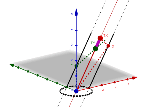

Here's a video showing, on a spacetime diagram,
how length contraction is needed so that there is no time-difference between "ticks" for the transverse and longitudinal light clocks (i.e., the arms of a Michelson-Morley apparatus).
and here a GeoGebra visualization of the situation
https://www.geogebra.org/m/XFXzXGTq
But why stop with two clocks?
Here's a circular light-clock (similar to what is shown in the German-language video posted earlier)
