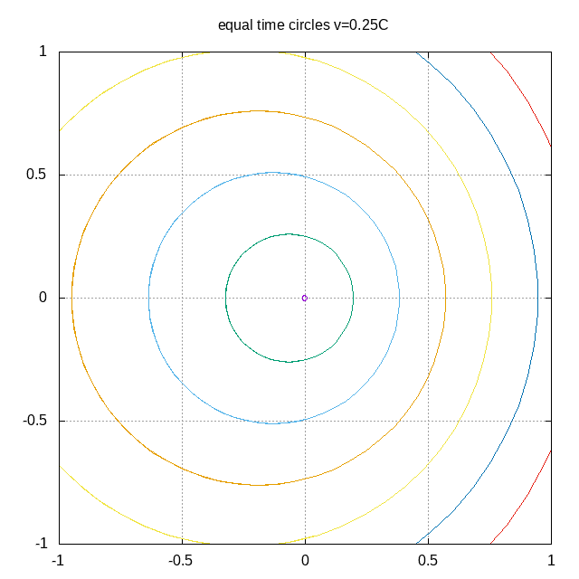

Contours of equal field propagation time (constant [itex]r_r[/itex]) from the charged particle/planet are easily graphed. They make a doppler shift circle pattern receeding at the speed of light from the uniformly moving point charge. In the following graph, the planet is at the origin and has been moving to the right from negative x values in previous times. The contour rings clearly show a doppler shift kind of diagram. Each time contour represents a constant difference in time compared to the adjacent contour. They are compressed to the right of origin, and expanded to the left.
243605
From this diagram, I was able to figure out what the unit retarded radius vector and retarded radius value would be:
[itex]r_r= {{x^2+y^2} \over {(x^2+({1- {v^2 \over c^2} })y^2 )^{1/2} - ({v \over c}) x } } [/itex]
[itex]\vec u_r = { [ { vm^2+-\sqrt{1+m^2(1-{v^2 \over c^2})} \over {1+m^2}} , {m(-v+-\sqrt{1+m^2(1-{v^2 \over c^2}})\over {1+m^2} } , 0 ]}[/itex] : where m=y/x , eg: the slope.
The unit vector formula was defined for the top half of the graph, (y>0). Choose the positive sign in the equation and you will get the vector for points x>0, otherwise you get the vector for x<0. You can mirror the vector for all other quadrants.
Note carefully: The unit vector points in the direction from point x,y to where the particle was in the past and NOT to the origin of the graph.
I was able to use these algebraic expressions to write a numerical analysis routine to calculate E and B fields according to 28.3 and 28.4 using numerical differentiation.

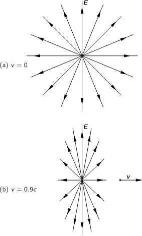

Richard Feynman pointed out that the third term of eq 28.3, is the only one responsible for radiation due to "acceleration" of particles (second derivative of position with respect to time.). Radiation magnitudes of E and B fields fall off as [itex] 1 \over r [/itex] in some directions, but Lorentz contracted E and B fields of a uniformly moving charged particle is expected to fall off as [itex] 1 \over r^2 [/itex] in all directions. Please review Feynman's work if you have questions.
http://www.feynmanlectures.caltech.edu/I_28.htmlWhen Feynman draws the E field of a uniformly moving point charge in another part of his lectures, he says that the drawing contracts linearly only in one axis (the axis of motion.) In essence, I thought that a linear contraction in one dimenstion should give me an elliptical outline if I were to plot a contour of constant force. Both Feynman and others tend to draw images to imply this same outcome. Lorentz contraction of a circle, looks like an ellipse.
243608
243609

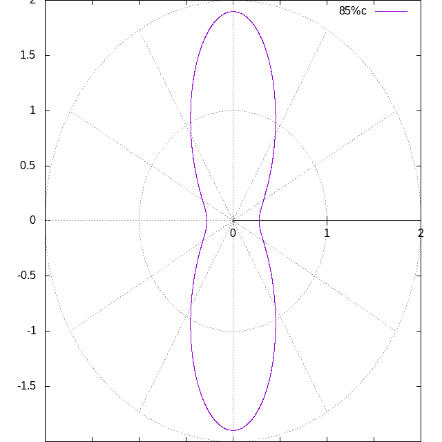

However, careful analysis of the third term (radiation) of the Heavyside equation shows that only one component of the acceleration vector falls off with [itex]1 \over r[/itex] The other component falls off as radius squared. Even though the "planet" is moving uniformly along the x-axis with a fixed velocity, v, none the less ... the unit vector in equation 28.3 accelerates as the particle passes by and distorts the Lorentz contracted field.
When I try plotting a contour map of where the numerical solution has an arbitrary fixed force magnitude, I don't get an ellipse shape for all v. I get something that looks like a circle at very low velocities, an ellipse at medium v < 10% c velocities, but a peanut at high V>0.6C.
Constant force magnitude contour graph, for v=0.85C:
243610
The B field at any location on the peanut graph's contour line points directly into or out of the page. (out of page for +y locations, and into page for -y locations if we assume a positively charged planet.) There is no magnetic field on the x axis. By cylindrical symmetry of the problem, the y and z axis are equivalent directions; Therefore, the magnetic field lines are making perfect circles in the y-z plane. eg: They loop around the [x,0,0] axis line.
I was able to numerically compute the magnitude of the E and B field vectors at every point at an instant of time. (eg: when the planet is at the origin in the plots). I was also able to fit the numerical results to a pair of algebraic equations. (cool!)
The following algebraic approximations are accurate to over 100 digits. I tested from v=0.000001c all the way to 0.999999c. Compared to the significant digits possible in a plank length, I'm sure the following two equations are indistinguishable from exact for practical physics problems.
[itex] | \vec{E} | = {{ {(1-{v^2 \over c^2})} \sqrt{ x^2 + y^2}} \over { ({ x^2 + {(1-{v^2 \over c^2})}y^2})^{3/2} } } [/itex]
[itex] | \vec{B} | = | \vec{E} | {1 \over c } {y \over { \sqrt {x^2+y^2} } } [/itex]
Note: the direction of the E vector is always colinear with a ray to/from the origin in the above plot. The E field vectors all point to or directly away from the graph's origin, where the planet is (depending on type of charge + or -).

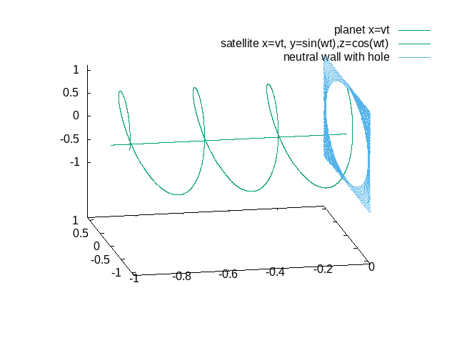

But, in either case (let's do another gedanken) ... if I built a non-moving wall of neutrons/neutral matter along the Y axis in the rest (labarotory) frame at the origin, then I could test the actual size of the satellite orbit by making a hole of varous sizes in the non-moving neutron wall, and seeing whether or not the planet and satellite fit through the hole or "hit" the wall.
If I now place the planet with orbiting satellite at some location on the x-axis x<<0, and set it's translational velocity v=85% c (x=-10000m+vt), then the system should either go through the hole or not. That allows us to determine the "real" radius of the sattelite orbit.
Given that the experiment uses translational motion only in the x direction, I would not expect the satellite orbit's radius to change much (if at all). Lorentz contraction is not supposed to happen perpendicular to the direction of motion, and both the planet and the satellite are point sized objects.
So, if the planet and satellite would just barely fit inside the hole without hitting when v of the system is 0, then the planet and satellite system should still just barely fit inside the same hole when passing through it along the x-axis an arbitrary velocity v.
The same experiment should even work if the satellite is orbiting in the x-y plane instead of the x-z plane. The analysis will become far more complicated, but Lorentz length contraction should still happen only along the x direction, and not the y direction.
Any suggestions on how to attack the shape of the acutal sattelite orbit (x-y plane) with respect to the peanut shape equations for |E| and the magnitude of |B| is appreciated. I think the satellite orbit ought to be an ellipse relative to the planet, but I'm unsure how to derive that result given the algebraic equations I have already come up with.
