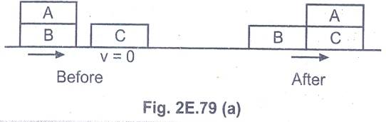

Board ##A## is placed on board ##B## as shown. Both boards slide, without moving w.r.t each other, along a frictionless horizontal surface at a speed of ##6 \text{m/s}##. Board ##B## hits a resulting board ##C##, "head-on". After the collision, board ##B## and ##C## stick together and the board ##A## slides on top of board ##C## and stops its motion relative to board ##C## in the position shown in the diagram. What is the length (in m) of each board? All three boards have the same mass, size and shape. The coefficient of kinetic friction between boards ##A## & ##B## and b/w ##A## & ##B## is ##0.3##.

But, the answer given in the book is ##10m##, where am I going wrong.

decentfellow said:
stops its motion relative to board C in the position shown in the diagram
I don't see a diagram showing this. Is A half way C when no longer sliding ?
Oh no! I am very sorry I will be uploading the diagram in a moment.
Here is the diagram accompanying the question
OK, so it slides the full length of C. I agree with the 4 m/s for the 'after' case. Check out the situation right after B collides with C.

That all seems right. I didn't understand how you got the time 2/3s in post #5.
What are the speeds of A, B and C just after collision? What is the speed of A relative to B&C then? What is the relative acceleration?
Just after the collision the speed of the block ##A## should be ##6\text{m/s}## because there is no impulsive normal reaction acting on its surface but there is force of friction acting on it to stop its relative motion but just after the collision, i.e. in a time ##dt##, it does not deaccelerate to any significant time.
And for the blocks ##B## & ##C## as there is an external force, i.e. the force of friction, so the momentum of the system is not conserved exactly but due to the same reasoning as that in block ##A##, the deaccelration produced due to the friction force is not significant, so we assume the momentum of the system can be assumed to be approximately conserved. So, we get
$$mv=2mv'\implies v'=\dfrac{v}{2}=3\text{m/s}$$
For the relative acceleration what I did was as the block ##A## has a deacceleration of magnitude ##\mu_kg## and from the equation of motion we get $$v_f-v_i=a_Ct\implies 4-3=a_C(2/3)\implies a_C=\dfrac{3}{2}\text{m/s}^2$$ ,so we get ##a_{A/C}=4.5\text{m/s}^2##.
So we get $$S_{A/C}=\dfrac{-u^2_{A/C}}{2a_{A/C}}=\dfrac{(6-3)^2}{2\times 4.5}=\dfrac{9}{9}=1m$$
This again brought a new answer, where did I go wrong in this.

Good question. Let's see where that takes us:
Loss of KE of A is m(62-42)/2=10m. Force=3m. L=10/3.
We can do the same for B&C: 2m(42-32)/2=7m. L=7/3.
Interestingly, the difference is 1m, as correctly found to be the answer in post #13.

Yes, that method is also valid, and produces the same answer decentfellow got in post #13.
I think its safe to conclude that the answer the book has written is wrong and the answer should be ##1\text{m}## as the work energy theorem also gives the same answer.
