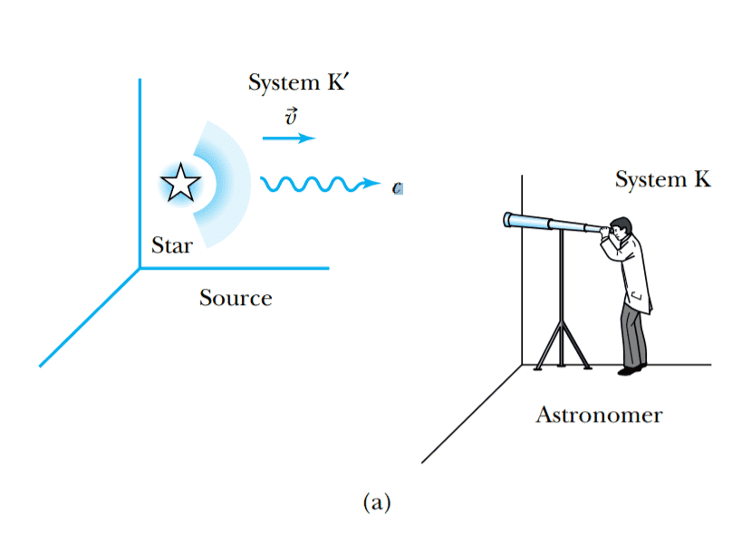

Consider a source of light (for example, a star) and a receiver (an astronomer) approaching one another with a relative velocity v. First we consider the
receiver fixed (Figure 2.27a) in system K and the light source in system K moving toward the receiver with velocity v. The source emits n waves during the time
interval T. Because the speed of light is always c and the source is moving with
velocity v, the total distance between the front and rear of the wave train emitted
during the time interval T is
Length of wave train = cT - vT
I am confused about how to find the length of a wave train emitted within a time interval T and that is moving with speed c relative to a moving frame that is itself moving with velocity v. Apparently the answer is that the wave train's length is cT - vT, but I tried to plug in variables into the Lorentz velocity transformation equation in the x direction and didn't get the right answer. I also tried to use the time dilation and length contraction equations but to no avail. Please see attachment for the figure.
Also, I am unsure whether the textbook is trying to find the proper length or is trying to find the length with respect to the stationary frame.
In frame K:
1) What is the definition of the length of the wave train?
2) Where is the first wave when the last wave is emitted.
3) Where is the source when the last wave is emitted.

You must either be misunderstanding something or otherwise the book must be wrong, since the Lorentz transformations are a coordinate transformation between two inertial frames. To answer @PeroK's bonus question: nada.
The first wave emitted by the source travels ##cT## during the interval ##T##, and the source travels ##vT##. The distance between the front wave and the source is ##cT-vT##. The resulting wavelength in ##K## is this distance divided into ##n## pieces, i.e. ##\lambda = \frac{cT - vT}{n}##.
Likes PeroK

The question ought to give the frequency in the frame of the source: ##n## waves in ##T'## seconds. Then, you would need to use time dilation and the question would have some requirement for SR.
But, the answer is just the simple kinematic answer. So, clearly, they intended ##T##to be the time in the astronomer's frame and it's just a simple kinematic problem.

@PeroK's suggestion in #11 is very good. In the rest frame of the source let's say the time interval between the first and last emissions is ##T'##. Because the emissions occur at the same spatial location in the source frame ##K'##, we can use the time dilation formula ##T = \gamma T'##. Notice that$$\lambda = \frac{(c-v)T}{n} = \frac{(c-v)\gamma T'}{n}$$ Since ##n = fT = f'T'## (i.e. the number of wavefronts is frame invariant),$$f = \frac{c}{\lambda} = \frac{cn}{(c-v)\gamma T'} \frac{c^{-1}}{c^{-1}} = \frac{f' T'}{(1-\frac{v}{c}) \gamma T'} = \frac{\sqrt{1-\frac{v^2}{c^2}}}{1-\frac{v}{c}} f' = \frac{\sqrt{1+\frac{v}{c}}}{\sqrt{1-\frac{v}{c}}} f' = \frac{\sqrt{1+\beta}}{\sqrt{1-\beta}} f'$$This equation should be familiar, it's the Doppler effect!
