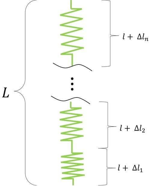

Trying to derive the length of a spring hanging under its own weight. I was trying to approach it like a series of small springs free length ##l## connected in series, in hope to use a limit as ##l \to 0 ## to get the final result, but either I'm bungling it, or it just doesn't work.
I'm proposing that the total length ##L## is given by:
$$ L = \left( l + \Delta l_1 \right) + l + \left(\Delta l_2 \right) + \cdots + \left( l + \Delta l_n \right) $$
And the force balance on each spring yields:
$$ \Delta l_n = \left( n-1\right)\frac{mg}{k} $$
Where:
## n ## is the number of springs in series
## m ## is the mass of each spring
##k## is the spring constant
So it seems like:
$$ L = ln + \frac{mg}{k}\sum\left(n-1\right) = ln + \frac{n m g}{2 k} \left( n-1\right) $$
I do the following substitutions:
##L_o = l n## The initial free length of the system of springs.
##m = \frac{M}{n} ## ##M## is the total mass if the spring system.
I'm left with:
$$ L_o + \frac{Mg}{2k} \left( n-1\right) $$
This is where I have an ""uh-oh" moment (perhaps I should have had it sooner)?
Any help correcting my course is greatly appreciated.

Haven't fully checked your working but don't forget that the spring-constant (k) for each mini-spring is a function of its length.
E.g. if you take a spring of spring-constant k and cut it into two equal lengths, then the spring-constant of each half is 2k.
Likes erobz, Delta2, Orodruin and 1 other person

Think about this. Two springs with identical spring constant. What is their total spring constant when coupled in series?
$$ k_{eff} = \left( \frac{1}{k}+ \frac{1}{k} \right)^{(-1)} = \frac{1}{2} k $$
So then if I have ##n## little springs in series my spring constant is not ##k## like I think, but## \frac{k}{n}##

This. It solves the OP’s issues as the limit of ##n\to \infty## becomes well defined. To offer an equivalent, but somewhat rearranged view: Hooke’s law can be written on the form ##F = -\kappa \epsilon## where ##\epsilon## is the strain, ie, elongation per length (##\Delta L/L_0## for an ideal spring) and ##\kappa## is the normalised spring constant ##kL_0##.
A small element of unstrained length ##dx## therefore has length ##(1+\epsilon)dx = (1-F/\kappa)dx##. Insert the weight (##F =-m(x)g## where ##m(x)## is the mass below ##x##) and integrate.
Likes erobz and vanhees71
So then if I have ##n## little springs in series my spring contant is not ##k## like I think, but## \frac{k}{n}##
Exactly, so to get the correct spring constant for the smaller segments you need to multiply k by n.

Ahh...Thanks Everyone
$$ L = \lim_{n \to \infty} \left( L_o + \frac{Mg}{2k} \left( 1-\frac{1}{n}\right) \right) = L_o + \frac{Mg}{2k} $$

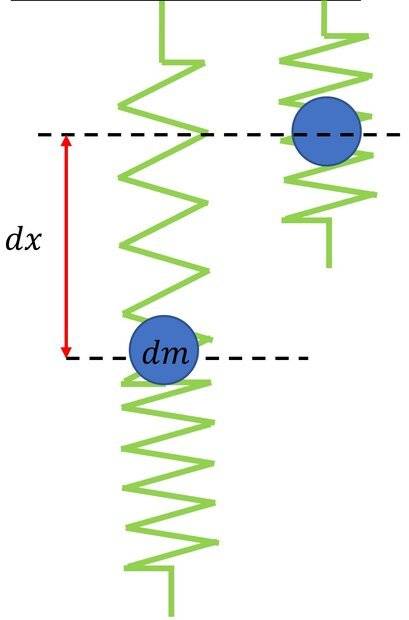

I'm stuck on this one.
You have a spring element of mass
$$dm = \frac{dx}{L_o} M $$
at some position below the top of the spring ##x##
Are we again using the mass below the element as the weight providing the stretch ##dl##?
Or is the ##dm## at the bottom of the spring and ##x## goes to the top?
It seems like its the latter:
$$ k \,dl = \frac{x}{L_o} g \, dm $$
So it seems like it is saying the stretch ##dl## at some distance ##x## from the bottom of the spring is the sum of all the individual stretches ##dx## from each mass ##dm## at point ##x##?

No. We are looking at the stretch caused by ##dm##. The mass ##dm## will stretch the spring above it by a fraction ##x/L_0## of what the same mass would stretch the spring if it were hung at the bottom, ie, ##(x/L_0)g\, dm/k##. The ##x## coordinate starts at the top here.

And this bit ## \frac{x}{L_o}## of mapping information comes from the linearity property of the spring?
I don't know why this part is confusing for me. If
$$k \left( x- l_o \right) = mg $$
Where is the dependency on position for ##\left( x - l_o \right)## coming from. it seems like its constant?
It seems like we get the same ##dx = \frac{g}{k} dm ## no matter where we load the mass?

This post seems garbled like you edited it some times and thoughts were lost along the way.
The argument is very simple. If you hung the mass ##dm## at the bottom of the spring, the full spring would satisfy ##\Delta L = g\,dm/k## and the elongation is linear. This means that the elongation of the upper ##x## of the spring is given by ##(x/L_0)\Delta L = gx \, dm/(kL_0)##. The forces acting on this upper part are the same regardless of if the mass hangs at the bottom or ##x## down the spring so the elongation must be the same. When you hang the mass ##dm## a distance ##x## down, there are no forces acting on the part below ##x## so it will therefore not be elongated at all. The elongation of the full spring due to a mass ##dm## at position ##x## from the top is therefore ##gx \, dm/(kL_0)##.
No, you don’t. See above.

The argument is very simple. If you hung the mass ##dm## at the bottom of the spring, the full spring would satisfy ##\Delta L = g\,dm/k## and the elongation is linear. This means that the elongation of the upper ##x## of the spring is given by ##(x/L_0)\Delta L = gx \, dm/(kL_0)##. The forces acting on this upper part are the same regardless of if the mass hangs at the bottom or ##x## down the spring so the elongation must be the same. When you hang the mass ##dm## a distance ##x## down, there are no forces acting on the part below ##x## so it will therefore not be elongated at all. The elongation of the full spring due to a mass ##dm## at position ##x## from the top is therefore ##gx \, dm/(kL_0)##.No, you don’t. See above.
Alright, it makes sense. My tiny brain needs to rest before I proceed to untangle the "intuitive approach".
Here is (yet another) approach that mixes both the approaches how much does each mass element elongate the spring and how much is each element elongate.
Consider how much the element ##dm## at ##x’## elongate the element ##dx## at ##x##. The elongation will be zero if ##x > x’## (coordinate going from top of spring) and ##d\xi = d\epsilon\, dx = (g\, dm/\kappa) dx = gM\, dx’ dx/(\kappa L_0)## if ##x’ > x##. Therefore, integrate the latter over ##0 < x < x’ < L_0## to get the total elongation. Depending on which integral you do first you should recover the integral of each of the other two approaches.
