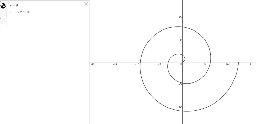

Use Desmos to graph the spiral ##r=\theta## on the interval ##0\leq\theta\leq4\pi##, and then determine the exact length of the curve and a four decimal approximation.
Hint: ##\int \sec^3(x)dx=\frac{1}{2}\sec(x)tan(x)+\frac{1}{2}\ln\left|\sec(x)+\tan(x)\right|+C##
Arc Length of a Polar Curve is given as:
$$\begin{align} S & = \int_\alpha^{\beta}\sqrt{\left[f(\theta)\right]^2+\left[f'(\theta)\right]^2}d\theta\\
& = \int_\alpha^{\beta}\sqrt{r^2+\left(\frac{dr}{d\theta}\right)^2}d\theta \end{align}$$
I have attached the required graph from Desmos.
Right off the bat, I am stuck here.
I start off with ##S=\int_0^{4\pi}\sqrt{(\theta)^2 + (\theta')^2}## and this makes no sense.
I also tried using the identity ##r^2=x^2+y^2## but then it of course gave me a nasty polynomial in two variables as the integrand.
I'm not seeing where this hint is coming into play.
Any ideas?

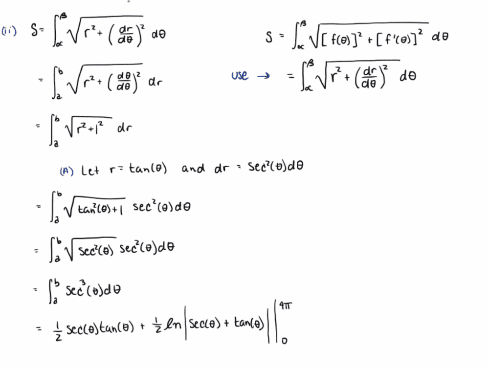

Ok I see it now I think, but I'm a little shaky on the nuances here.
From your hint, I got rid of the ##S = \int_\alpha^{\beta}\sqrt{\left[f(\theta)\right]^2+\left[f'(\theta)\right]^2}d\theta## and replaced it with ##\int_\alpha^{\beta}\sqrt{r^2+\left(\frac{dr}{d\theta}\right)^2}d\theta##
From here, ##\int_\alpha^{\beta}\sqrt{r^2+\left(\frac{d\theta}{d\theta}\right)^2}d\theta = \int_\alpha^{\beta}\sqrt{r^2+1}d\theta##
Then I let ##r=\tan(\theta)## and make the appropriate trigonometric substitutions and I get what's given in the hint.
Now for the "nuances" I mentioned, I am unsure exactly what to do with the interplay between the ##r## and ##\theta## here. What I did in my work, which I will post as an image, is kind of swap the r's for the theta's, and change the limits of integration from ##\alpha## and ##\beta## to ##a## and ##b##. I'm really not sure how to handle this in a mathematically proper way.
If you wouldn't mind having a look at my work in the image to see what I mean (kind of hard to explain in words), could you guide me in the right direction on how the notation/change of variables needs to be handled appropriately?
No, that is not correct, ##r = \theta##, not ##\tan\theta##.
Likes Delta2 and opus
Ahhh I see what you mean. It wasn't pretty, but looks like my solution matches the answer key now. Thank you!
