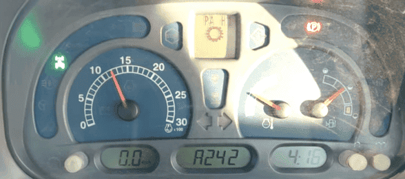

Below is a New Holland dashboard with a clock showing 4:16. Does your's look like that?

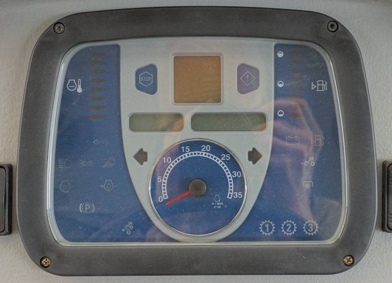

No, I attached a photo, (a reflection shows my hand). The clock is displayed in the right hand LCD (the longer rectangular one). The tractor has a CVT transmission and after the new instrument panel is installed, it has to be set up with New Holland's proprietary software using a laptop computer. That brings up another issue about serviceability. Some service on the tractor can only be done with New Holland's proprietary software using a laptop computer. The result of this is that cost of repair is greatly increased, especially if you are hours away from dealer and something you might be able to fix yourself is made impossible! That's why there is a movement for tractor manufacturers to allow a person to acquire equipment to service their own tractor. This is a very important thing to those who want to do their own work as much as possible. See info here, if you're interested:
