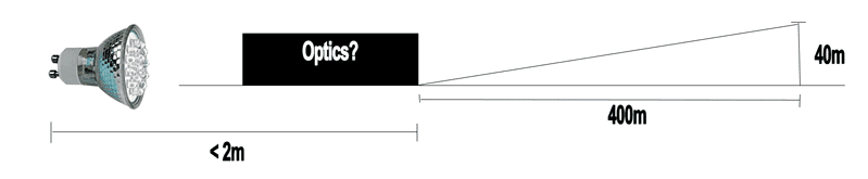

Hello All.
I'm working on a project to build an infrared spotlight which will hopefully light up a distant object so that I can see it on an IP enabled night vision camera. The lens problem seems very straight forward, but I could use some help. Per the attached diagram, I want to focus the light from an led (or cluster of LEDs) on an object that is 40m tall, 400m away. Ideally, I'd like the LEDs + Optics to be housed in a piece of PVC pipe less than 2m long. Whats the easiest way to do this with off the shelf cheap plastic lenses?
Thanks for the help...

I'm not an expert but I suspect you will need more power than that type of LED can produce. How sensitive is the camera? Perhaps start with that and work back?
Perhaps you could use LEDs that have a 6 degree beam angle? No optics needed then.

zlj06 said:
Great call CW! That's a much easier solution. Digikey has some very narrow radiation angle LEDs, so I'll solder together a cluster of those first and give that a try. Thanks, Zach
