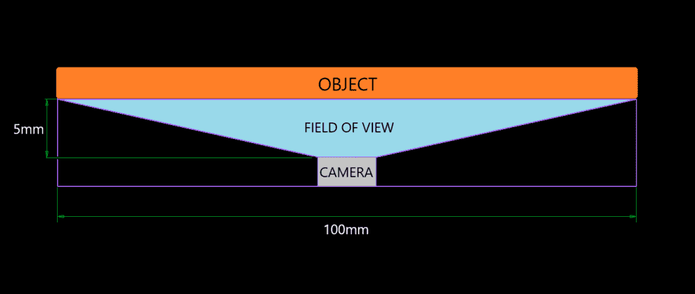

I am searching for some advice on how I could successfully take photos of a surface that is 5mm away from a CMOS camera sensor.
My ideas so far are;
1.) Find a lens with sub millimeter focal length (0.2mm by my calculations)
2.) Utilize mirrors to increase object distance
3.) Pin hole camera design
I have attached a sketch to illustrate.

Why not increase the object distance and use a longer lens?

The vertical space allowed for the camera is approx. 15mm.

If you have a space to one side then you could use a 45 degree mirror and a long lens on your sensor. But then, I'm not sure about the usable field there would be. I guess the mirror would need to be curved (convex) and placed at the far side of the subject.
Only you know the actual geometry but I wonder what sort of distortion the arrangement in the diagram will produce - and what masking of the surface there could be, if it's not flat all over. Could there also be a question of available light and depth of focus, whatever system you choose?
A few more sketches are required.

This is going to be a very difficult design challenge, if your diagram is reasonably accurate- a 100mm diameter object placed 5 mm away subtends nearly 86 degrees (170 degree total field of view), so you are likely looking at a fisheye design with all the distortion that implies.
What about a 'door peeper' lens like this:
https://www.grainger.com/product/1H...ucid=N:N:PS:Paid:GGL:CSM-2295:4P7A1P:20501231
Not sure it will fit your space.
That said, you haven't specified some basic performance aspects: I assume this is visible light imaging, for example. Are there any optical performance requirements regarding throughput or resolution? What about the object illumination- is this a transmission or a reflected light situation?

Thank you both sophiecentaur and Andy Resnick for your input.
Great idea with the door peeper Andy, I will look into this!
And yes, the object will be illuminated by led lighting therefore is a reflected light situation.

I think your idea #2 is the best bet. Use a mirror to relay the image to where-ever the camera fits.
If you have never looked at the workings of a flatbed scanner, find a cheap or junked one and do so. Closest to the object surface there is a flat mirror. From there the path is a series of curved mirrors in a folded light path (3 or 4 mirrors if I recall correctly). The advantage of reflective optics is they don't have to be massive for short focal lengths, also no chromatic aberrations.
Of course a scanner uses a line sensor which is much shorter than the paper width, so the mirrors are curved in only one dimension. It sounds like you need area sensing though, so two-dimensional optics are needed. Anyhow, the optical path is light weight and compact -- just not as compact as you are after.
