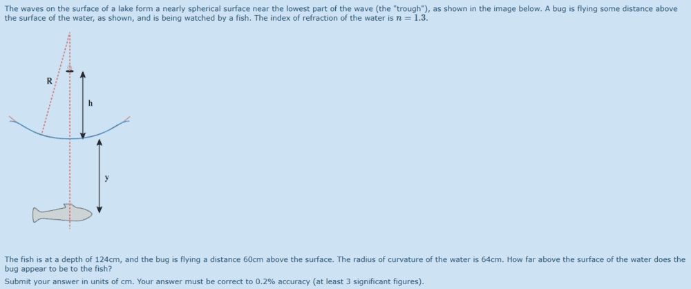

1/p+1/q=-2/R
So I am not really familiar with lens questions when there's 2 different refraction indexes. I tried using n1/p+n2/q=-(n2-n1)/R but it doesn't seem to work.
p would be the actual location of the fly and q would be the virtual location, what the fish sees if I am understanding correctly. n1 would be the index of refraction where the fly is and n2 where the virtual image is?
So 1/60+1.3/q=-1.3/64. q=-35.155
So the image is 35.155 cm above the water. But this is wrong, the answer is 60.88 cm
The 1.3 on the right side is not correct.
The rest is correct then?
Shouldn't it be on top according to the formula?
The rest is correct.
I'm not sure what you are asking here.
is this formula incorrect here?
The formula looks correct, although I’m not sure what sign conventions you are using for R, etc.
You made a mistake in calculating ##n_2-n_1##.
Likes JoeyBob
ya I am dumb. 1.3-1 isn't the same as 1.3-0. I get q = -60.88 when I use 0.3, so 60.88 above the water.
Thanks.
Likes berkeman
JoeyBob said:
ya I am dumb.
Not at all. We all make slips like this :oldsmile:
Thanks.
Looks good.
