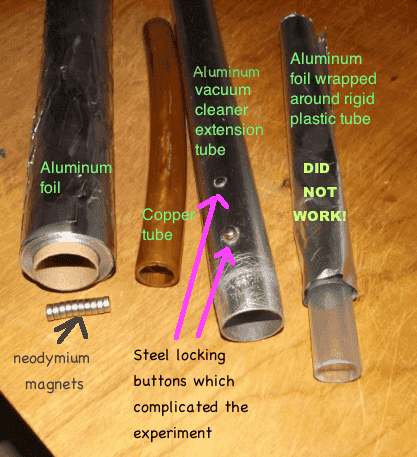

I just did the experiment with a full roll of aluminum foil, and magnets I have around the house.
Total cost: $0.00
It didn't work quite as well as the magnets down my copper pipe.*
But my copper pipe has a smaller diameter than my roll of aluminum foil, and I concluded that for really impressive results, you want to keep the diameter of the magnet as close to the diameter of the tube as possible. Without it getting stuck on the way down, of course.

  • #32
OmCheeto said:
fixing my neighbors water pipes at the meter...a healthy length of copper tubing
I think the flexible copper pipe for underground use is pure copper and has better conductivity than the rigid indoor pipe, which is an alloy.
I found some discarded hollow aluminum deck railings and a heavy aluminum grill for a portable gas stove,
both of which slow down magnets impressively.
If you know the physics of "how stuff works" you can find interesting materials free or cheap. For example, magnets in hard drives, speakers, microwaves and vibrating toothbrushes.
