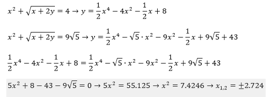

Hello again,
I have another level curves related question, which I tried solving, but I have the feeling that I did something wrong, would appreciate it if you could have a look.
The question is:
The function f is given by:
\[f(x,y)=x^{2}+\sqrt{x+2y}\]C1 is the level curve that goes through (1,4). C2 is the level curve that goes through (2,-1) and C3 is the level curve that goes through (-3,4).
For each statement, decide true or false:
a. C1=C3
b. C1=C2
c. C1 and C3 do not intersect
d. C2=C3
e. C1 and C2 has exactly two points of intersection
The attached photos show my attempt.
My conclusion is:
a. false
b. true
c. false
d. false
e. false (they are the same, so having more than 2?)
thank you !
I agree with all answers except (c). How can two different level curves intersect?
Concerning the attachment, what is $9\sqrt{5}$ on line 2? Why do the equations of the curves matter at all except to find out if they contain more than two points to answer (e)?
Thank you.
So if I understand you correctly, you are saying that my C1, C2 and C3 are correct, and that c is "true" since two level curves never intersect (yeah, never thought of that). Saying that, when I compared them, shouldn't I have reached a dead end when trying to find shared points ? Is my technique faulty ?
Regarding e, is it correct to say that C1 and C2 represent the same level curve and thus they have infinite number of shared points ?
First, there are errors in the fourth line in the attachment: $\sqrt{5}x^2$ is lost, and $5x^2=55.125$ does not imply $x^2=7.4246$. More importantly, you squared both sides of
x^2+\sqrt{x+2y}=4\tag{*}
and the resulting equation is not equivalent to (*); it may have more solutions. So $x_{1,2}$ you found must be spurious solutions to the problem of intersection of the two curves.
Yes.
