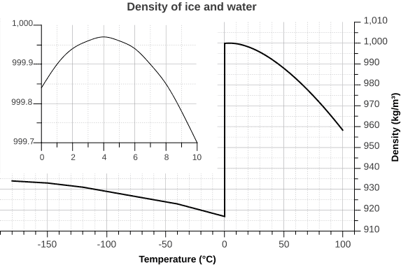

While it is true that water displays anomalous expansion between 0°C and approximately 4°C, that's a very small effect compared to the amount of expansion that water undergoes as it transitions from liquid to solid.
I assume that if the question you are trying to answer
"If we drop an ice cube in a glass of water ,check the level of water & let it melt, what happens to the water level afterwards? Does it rise, remains the same or lowers?"​
comes from a textbook, or was asked by a teacher, then the small amount that the liquid water expands or contracts as it cools while that the ice melts, is ignore-able.
Ice near 0°C is about 9% less dense that liquid water near 0°C
Liquid water at 4°C has a density of about 999.8395kg/m3.
Liquid water at 0°C has a density of about 999.9720kg/m3.
That's a decrease in density of about 0.013% in cooling from 4° to 0°C .
That's likely negligible compared to the 9% difference for the phase change.
The following graph is on Wikipedia .
Likes 1 person
