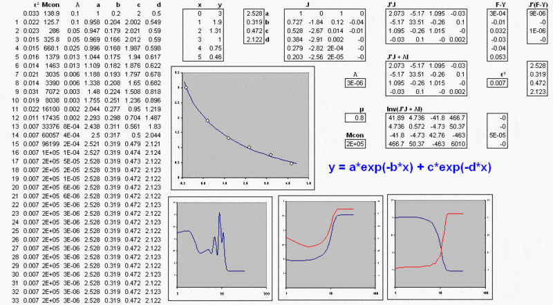

The 2nd attachment (Nonlinear Least Squares Example) in the below link might help.
https://www.physicsforums.com/showthread.php?t=97391
There are two ways this can be solved with Excel. The easiest is to set up the equations within the spreadsheet and solve using built-in Excel matrix functions. The second is to write VBA routine, which would still use the built-in Excel matrix functions.
Attached is an example of how one might solve such a problem in Excel. The data I just made up. In this example, the matrix calculations are done with Excel built-in spreadsheet functions (i.e. MMULT, Transpose, Minverse) and the iterative portion is handled by some simple VBA code that does a copy/paste operation on the solution vector and adjusts the L-M parameter (Lambda) based on how the sum of sqaures is behaving. Of course, one can get much fancier by using matrix decomposition techniques such as QR instead of calculating a matrix inverse and using a line search to determine updated parameters instead of a fixed multiplication factor (mu), but additional VBA code would be needed. This particular example is tricky because it is ill conditioned and actually is unstable.
