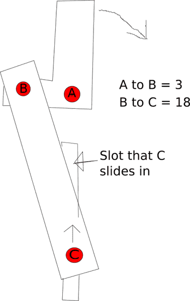

How to Calculate Pressure Exerted by C in a Lever and Fulcrum Configuration?
In summary, the bell crank lever can apply a maximum force of 20MPa when the pressure on the piston is at its highest.
john101
196
47
as B moves to over A, ( A is a fixed point ) C slides up its guide slot and is stopped by a non compressible object and no amount of force can shift it further up.
measurements in units.
At this point >> how do I know how much pressure C excerts upwards. psi? Mpa?
I hope I'm making myself sufficiently clear. I wouldn't be surprised if there are simpler ways to look at this.
I've no doubt I'm using wrong words. (how to frame Q correctly?)
Is this a fairly standard configuration? if so what's it called?
This is a bell crank / connecting rod / slide arrangement . It does not have any general name .
You need to work with forces . Newtons or Lbf .
A force applied to the the upper arm on the bell crank will be balanced by a reaction force from the stop fitted to the slide .
The relationship between the applied and reaction forces can easily be calculated . To do an actual calculation you need to assign an effective length to the upper arm of the bell crank .

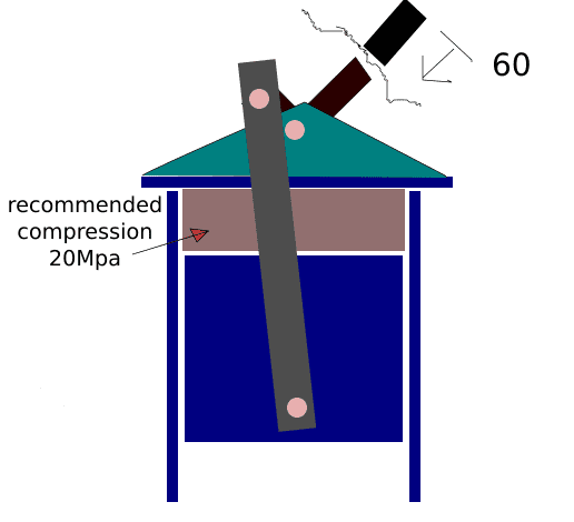

This image explains a bit more what I'm trying to do.
There's a box as a piston inside another (open ended) box.
Fixed pivot point A is on a lid.
Between the lid and piston is Earth mix.
When the lever pulls up the piston the compressed Earth becomes very strong and can be used as building block.
It is recommended to apply a compression of 20Mpa.
I'm building the 'knuckle' at the moment out of 3/4 inch steel.
I envisage the lever on this to be about 6 foot.
I'm working with inches as units (for scaling) and see myself pulling on the lever at about 5 foot or 60 units.
If I know how hard I have to pull I think can see if I'm building the parts strong enough to not deform.
Force acting on piston is pressure x area of piston .
Recommended pressure is given as 20MPa . So need to know the dimensions of the piston .
It is important to use consistent units in any calculations .
OK. I'll give all dimensions as inches. In all of the above 1 unit = 1 inch.
I was hoping to work out the dimensions of the piston/box from this.
So, let's say the area of the piston is 6 inches by 12 inches (to produce a block 4 inches thick) or 72 square inches.

Using an online converter 20Mpa is 2900psi.
Does this then mean the piston needs to apply 2900 lb x 72 = 208,800 lb of force to achieve the required compression on the Earth block?
20 MPa is about 200 atmospheres or 2940 psi . That is a very high pressure . Are you sure that this is the correct figure ?
Yes it does .

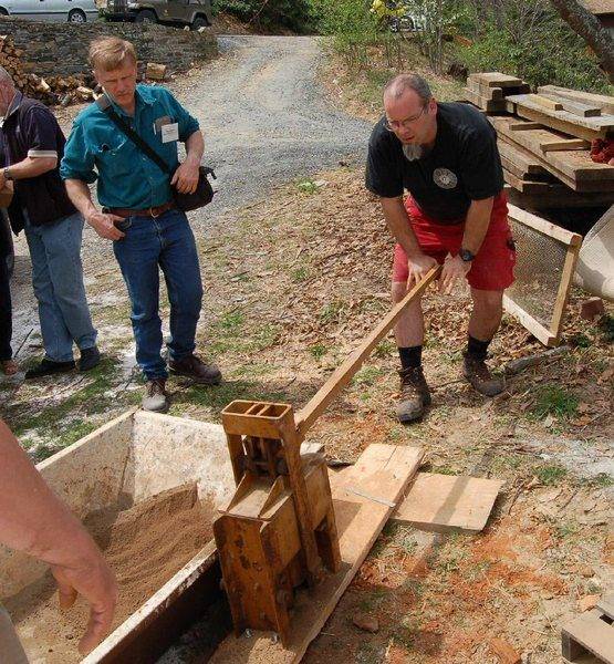

this is from a site demonstrating how to use it.
It's at this point I want to know the pressure.
The guy is pushing down.
The short bellcrank lever is moving towards him.
The 'piston puller shaft' is still moving up as maximum compression is achieved.
What's that pressure in relation to the force exerted on the long lever of the bell crank?

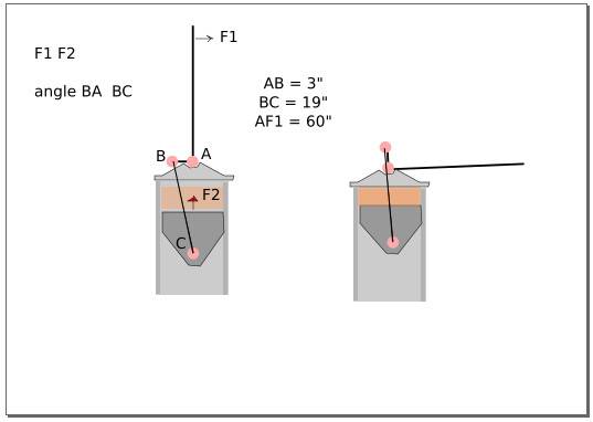

Based on this image.
What is the relationship (graph) between F1 and F2 as angle ABC* approaches 0 as the soil between lid and piston becomes incompressible.
edit correction: based on notation by TomG, I had angle BA BC meaning the angle ABC. F1AB is 90 degrees (I'm having a bit of trouble understanding the formula. Not so much calculating with cos, tan perhaps, using online calculator, but if I get it F2 is 0 when ABC is 0 and BAC is 180.? And the distance to F1 doesn't matter?)
john101 said:
Based on this image. What is the relationship (graph) between F1 and F2 as angle BA BC approaches 0
Given:
  • the angle F1,A,B is 90o
  • when B, A, C are in a straight line with each other, the angle is 180o.
Angle 'A' = the included angle BAC
Angle 'B = the included angle ABC
F2 = F1 x cos(B) x tan(90- (A/2))
p.s. A graph is left as an exercise for the reader. :smile:

Correction to post #19:
Given:
LH = length of handle, F1 to A
LAB = length of arm A to B
F2 = F1 x (LH / LAB) x ( cos(B) x tan(90- (A/2))

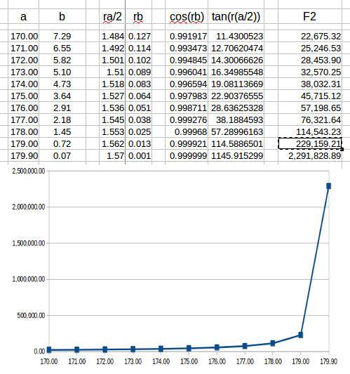

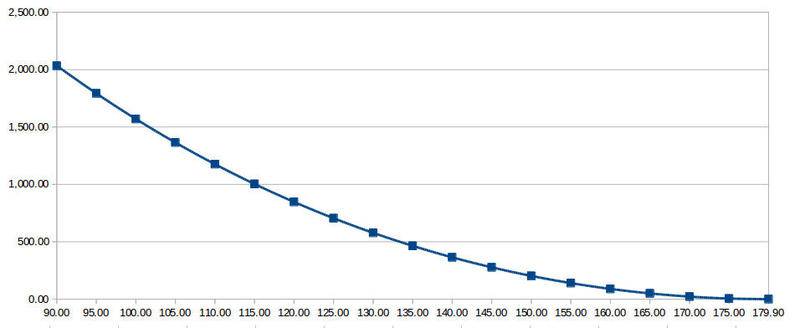

I'll use distance from A to F1 as X, AB as Y, angle BAC as a (alpha), angle ABC as b (beta)
So, F2 = F1*(X/Y)*cos(b)*tan(90-(a/2))
If that's ok, image and formula, I'll be AFK for a few hours and hope to have something to post by tomorrow.
Looks good.
(I see you cleaned up my typo of an extra "(" too!)
my brain hurts.

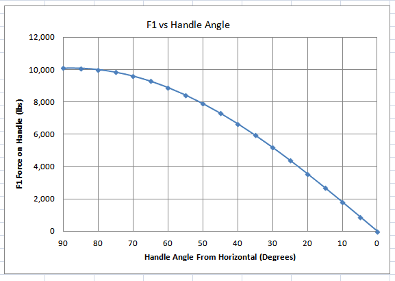

If that is the result of the equation then it appears there is a problem with the equation; and, a complicating factor is that the amount of F1 force that the operator can apply will not be constant due to the fact that his weight contribution vector is always vertically downward. From a practical application standpoint, it might be better to start at the point that the handle is at a 45° angle to the ground with the handle F1 force vector vertically down and calculate the F2 toggle force based upon the operator's weight in a range from 45° to 0° for the handle angle. Unfortunately this adds another angle factor into the equation.
Edit: A simpler way might be to keep the same calculation range and assume a good estimation of the operator's weight force will always be tangent to the handle and as a result the torque force applied to point B will be constant as it rotates through its corresponding 45° angle.

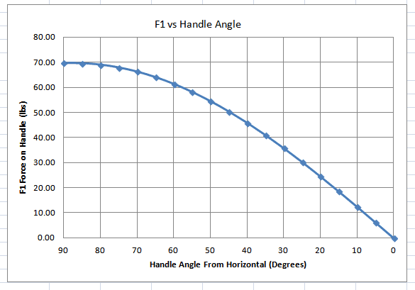

I was quite careful in setting out the formula in LibreOffice Calc and making the graph and used an online triangle solver to get angle alpha. (from this I also got length AC which will be useful later.). I'll recheck later. I have to be afk for the next 8 hours or so.
I used 100 pounds of force at 60". I figured this to be a reasonable starting point. As you say it will vary depending on the angle.
Meanwhile I've improved the knuckle, increasing the pin sizes and general thickness of material.
Later, and thank you.

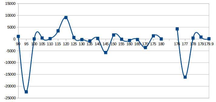

edit add: I think I got the problem : I need to convert degrees to radians before calc calculates cos and tan. Later.
  • #31
that's a bit better... something is missing though.

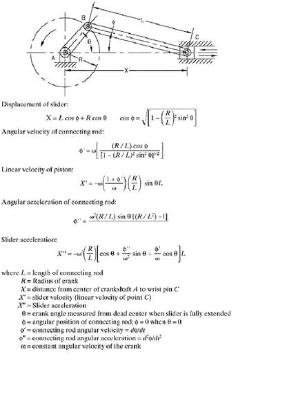

while trying to understand the toggle effect I found this :
helpful?

Nice graph.

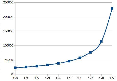

Sure is. I expected F2 to rise steeply as angle BAC approached 180o.
Ahh! Think I found it. Get rid of the "90-" in the formula so it becomes:
F2 = F1 x (LH / LAB) x cos(B) x tan(A/2)
(that makes the argument to tan() cover the range of 45o to 90o, rather than 45o to 0o ) o:)
You should see F2 approach infinity as angle BAC approaches 180o.

OK, Now we're getting somewhere...
Given :
Formula is correct, both as given and as used in spreadsheet.
All prior reasoning is correct and understood and applied correctly.
then
at 179 degrees the force on a 72 square inch piston is around what corresponds to the looked for 20Mpa.
(I think I can see clearly the value of the rubber.)
I think from this it is possible by adjusting variables to finish a design and know what size piston, arm lengths et.c. will be best.
It now occurs to me that :
While the triangle is measured from the centers of the pivot points is that actually where these forces are? Is it rather the surfaces of the shafts and the distances between them that need to be considered.
edit add : and what about material for shafts etc . size, shear, wear, deformation, fatigue... ? I don't really have a good concept of the magnitude of forces involved. Examples ?

Well, we are all finally converging, after trying to calculate the press force due to handle load, I decided to take the reverse approach and calculate the handle load based upon a given required compression pressure (I have inserted arbitrary brick length and width values) as you will see in the attached Excel calculation workbook. I decided to attach the workbook rather than spend time trying to describe everything. In the end, once the relationship of the angle between the bottom link and the vertical in terms of the handle angle was found the rest turned out to very simple. A key to applying this to the design is to design the initial contact pressure point at the minimum handle angle from the horizontal that will still guarantee the required compression pressure at full travel. A big help in this respect would be to calculate the bottom plate travel vs handle angle as well; but, I haven't added that yet. (Due to time restraints). See the below graph for an assumed 6" x 12" brick face area with 20 MPa pressure loading for an initial view of the worksheet results.
  • Brick Press Design.xlsx
For calculating leverage or mechanical advantage yes, that is the effective length of a lever.
