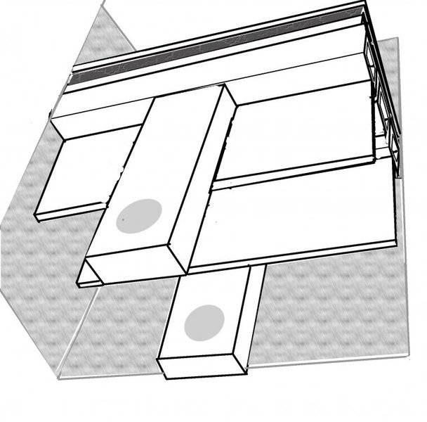

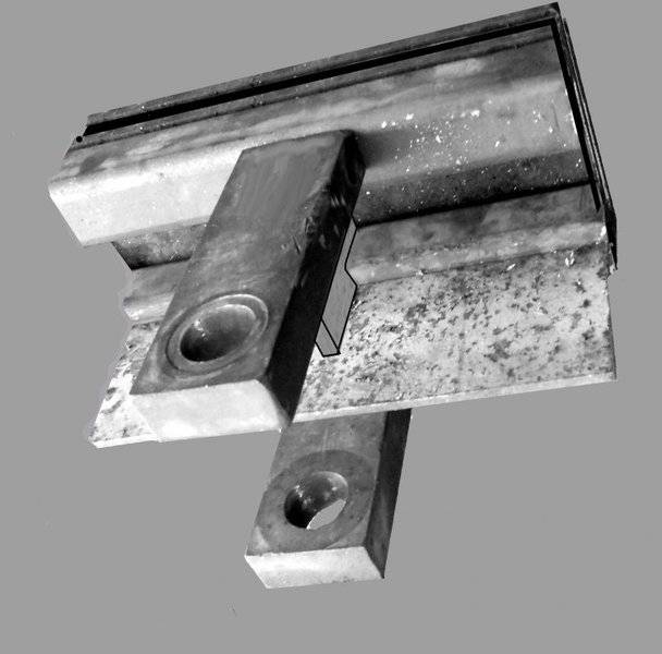

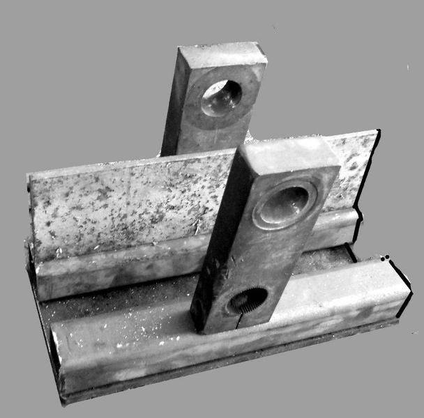

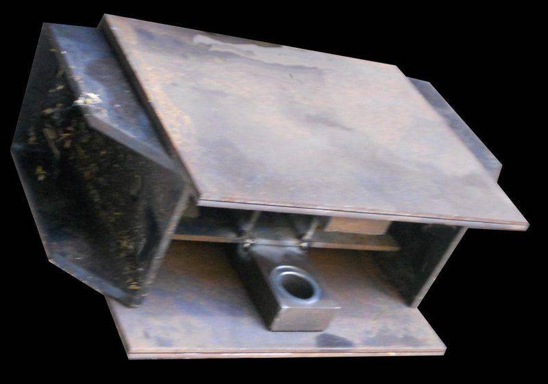

Looking at your latest assembly picture, I would like for you to give me the sq tubing dimensions including their lengths for the down links so I can calculate the tensile stress and stretch in those links at the 200,000 lb load.
  • #72
I hear you re rubber. I'll try both. I imagine the separator doesn't need to be very thick.
the square tubing :
5/16 walls.
1 15/16 square.
20" long.
  • #73
I agree it shouldn't need to be very thick since it is strictly a particle embedding barrier; but, if too thin it may be subject to warping due to varying compression densities across the brick. I suggest you start with something easy to handle and adjust if required.
I assume the 1 15/16" is the tubing outside dimension and will let you know the results of my calculation. tomorrow.

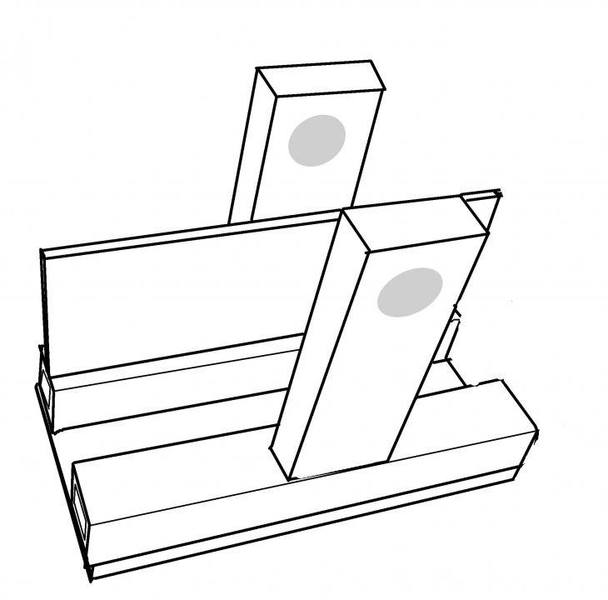

  • #74
Yes, outside.
_____
here's just a scribble I did to work out some dimensions and material...
  • #75
Below is the calculation for the Stress and the expected elongation on your press links. Since I don't know the your actual material alloy, I have included a sample of the specifications for a USA Standard Structural Square Steel Tubing that comes in 3 Grades (Yield strengths). Unfortunately, as you can see, the maximum load stress on your parts clearly exceeds the stated yield stress limits for all but the Grade C strongest alloy steel material.
As a result, it is very possible you will experience in permanent stretching of the arms and loss of loading at the end of the stroke with similar lower strength materials. A clear sign of this on your links will be that you experience an unexpected low handle load on your initial operation and/or are required to successively add more material in the mold to maintain the same operating handle load toward the end of each additional cycle, both of which will be a warning sign that the links are going to fracture at some point due to overloading and/or fatigue cycle failure.
  • #76
interesting...
OK. While I don't fully understand yet the information you have provided I accept it and it leads me to ask what to do.
I assume I can downsize the area of the piston and reduce the load/stresses or reduce the height of the piston chamber in order to reduce the amount of soil to be compressed and therefore load needed. Am I thinking right here. Something doesn't feel right. Anyway it seems logical to go on to thinking along those lines.

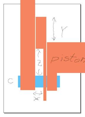

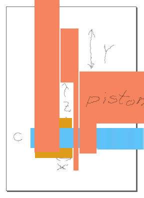

However, if I am thinking right then the questions I look for answers to are
What area piston will make it possible for a grade c to be used in current configuration..
What height of piston chamber to have in order to make sure that before failure there is no more to compress.
edit add : Just thinking aloud for now...

First, the pressure plate area depends on what safety factor is selected for the maximum anticipated loading. For ductile materials such as are used for the tubing samples, a safe level of stress for a member under a single tension stress would be 80% of the yield strength if this were being based upon the ASME pressure vessel code. In order to maintain your current compression pressure that would reduce the pressing area of your brick by 80%.which could be attained by either reducing the cavity length to about 9 1/2 " or the cavity width to about 5".

As you will see below the links at 80% of S yield are all capable of much more than 725 psi of plate pressure with your 72 in^2 brick area.
As for the 176° toggle position, also see the below and the major issue is the operator handle load required at that position.
Take a look at all of this and let me know what other conditions you might want to investigate.
ASTM A500 Structural Square Tubing Grade B Grade C Grade A
Max Allowable Link Tension Load at S yield (lbs) = 93,466 101,594 67,052 (No Safety Factor)
Max Allowable Link Tension at 80% S yield (lbs) = 74,773 81,275 53,642
Total Allowable Load with both Links (lbs) = 149,546 162,550 107,283
Allowable Plate Compression Pressure (psi) = 2077 2258 1490

  • #83
F1 refers back to the terminology used in the figure in post #21 and is the force the operator must apply perpendicular to the end of the handle.
As for my remark about a "Long Handle" was related to the fact that, the longer the handle the less operator force required for any selected bottom plate compressing pressure. i.e. if you double the length of the handle then you reduce the required operator force by 50%.
On a similar note, I need to know the dimensions of the bar or tubing you are using for your handle because I have realized I may have a method you can use to measure the pressure in your machine by using the amount of handle deflection under load that is based upon a style of torque wrench with no moving parts.

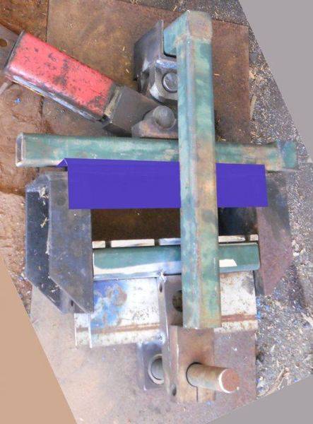

  • #89
Just as a note, the method I sent you will work just as well with the rod mounted above the handle and a vertical bar or plate on top of the handle at the end of the rod for showing the deflection and could be seen by you from above the handle. (Just to make sure you understand, for my handle deflection to be correct the bar must be installed with flats on the top and bottom of the handle)
An advantage of the load indicator is that if it indicates the load is too low just before toggle full extension then the brick is too thin and the finished compression is below 20 MPa.
I ran a quick verification on my excel calculation sheet and it indicates that for 20 MPa with a 60 in^2 area brick face the handle load at 1" above horizontal (and toggle full extension) will be 152 lbs which could be reduced if needed by a bit of added handle length and is well within the hexagon handle stress limit as I am sure you have already seen.
At the same time, a 20 MPa loading is still right at the yield stress limit for grade C tubing on your vertical tube links, so how are planning on dealing with this problem.
One thing you might consider is adding a reinforcing strip along the front and back faces of the tubing. For example, a 3/16" thick x 1 3/4" wide strip on both faces would add enough metal area to reduce the tension stress to 37,000 psi which would be well within the Grade B material stress limit and just barely above the Grade A limit. The strips would only need to fully welded to the tubing at the top and bottom ends (and maybe an 1" down each edge for safety) to provide this added strength.
  • #90
Yes, of course. I get what you mean re mounting bar on top. Neat. (Because the bar is good for other things like a crow bar. I'll clamp the readout on to it. Also I'll clamp a T handle on. I've got more tubing, either round pipe or heavy rectangular tube, to make an extension with as well.)
I have the material for strips the size given. I'll cut and weld them on.
Am I right in thinking that by now the weak link will be the smaller rods at pivot point B. I'm also planning to use the same rods at C.

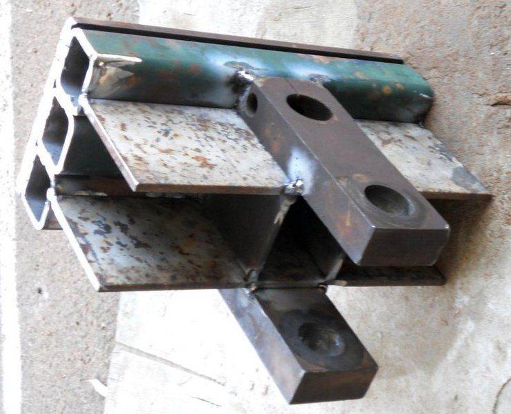

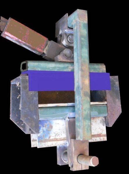

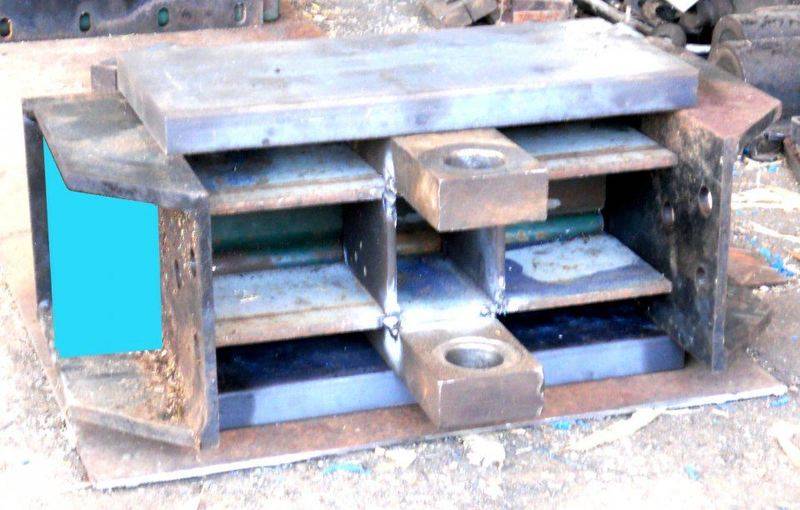

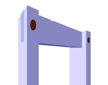

  • #91
Yes, at this point, the shear strength of the B & C 1 1/4" dia axle shafts' material and the potential for lubricant breakdown and galling between the those shafts and the plate holes without the 1/2 bearing shells are still a bit of an unknown.

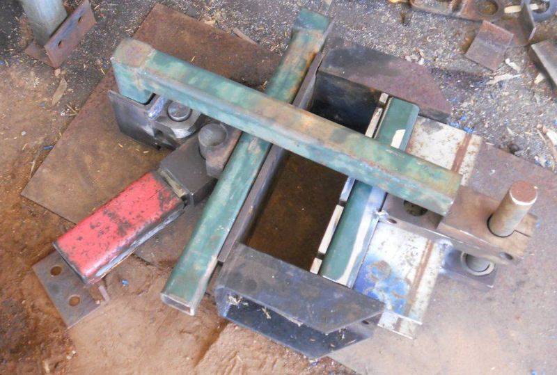

I was just looking back at your last assembly picture in your post #67 and there are a couple of suggestions regarding the reinforcing of the links and their cross bar.
First, I recommend that you extend the added side plates all the way to the top of the crossbar tubing at the ends of the links.
Second, with regard to the crossbar tubing, it is really hard to calculate the possibility of load buckling of the crossbar tubing where it sits on the top steel angle; so, if it can be reasonably done at this point, adding a bit of the same type of reinforcing strips all the way across the bottom face and on the sides of that crossbar tubing might be a good idea. (those should be fully welded to the tubing along both edges)
Apart from those issues, it appears everything else we have discussed so far seems to be getting worked out.
  • #92
The cross bar :
When I place it on the angle it allows me to bolt it in place. If I thicken the side against the angle it moves off center.
What about doubling the cross piece with a second on on top?

  • #93
I just looked at the #79 post and now I see that when I pasted it from Excel all of the number columns became scrambled and essentially unreadable. I can't believe I didn't catch that when I did that post. Below is a screen shot of that data in a readable form
The first table simply gives the compression pressure limits for the side links for each of the three material grades.
The purpose of the second "For All Plate ..." table was simply to show you the amount of operator handle force that would result at a handle position 4" above the horizontal and the toggle at 176° with a 725 psi (5 MPa) and a 400 psi plate pressure to give you an idea of how high the operator load would be with the handle at that position at those pressures.
At this point, I think what is important for you to see is that the first table shows that you can safely have up to 1973 psi (17.6 MPa) pressure with the Grade A material limits with your desired 72 in^2 of area; and assuming we return to using the full toggle extension with your latest design and revisions then you would only have a operator handle force of 134 lbs at 1" handle height with your current 60 in handle. So other than possibly lengthening the handle a bit I don't see that is is really necessary to reduce your compressing pressure all the way down to 5 MPa. Does this help clear things up a bit or am I missing something.
With regard to the reinforcing of the crossbar, I was not saying that your current crossbar tube will not be strong enough. I was only suggesting reinforcing it a bit if possible because I don't have any way to calculate whether or not the tubing wall might buckle or not under a 200,000 lb load.
Adding the strip on the bottom of the crossbar will definitely help, so if placing the strips on the sides is a problem then just don't add those suggested plates. Adding a strip to the top of the crossbar will not improve the buckling strength so there is no reason to do that.
Let me know what you think about all of this with regard to your above thoughts about changing your current design.

Got a bit distracted yesterday. Had to move a huge (1 meter wide 2.5 meter diameter) tyre using only a car jack and bricks to partially tilt it upright and ultimately the car pulling it upright so I could roll it.
The next thing I'm thinking about is the construction of the piston.
This photo shows what I propose.
The top plate (here on bottom) is 3/8 inch. The angle irons are 1/4 " and the bars with the hole for c (ignore the other hole with the split) 1" thick.
edit add : or
  • #100
It looks as though it should handle a heavy loading. I recommend beveling the angles' bottom edges at the angles' bottom attachment to the center post to insure a full penetration weld.
What is the length and leg width of the bar angles and the overall dimensions of the assembled base plate?
I want to try and analyse the loading stress on the welds between the center section and angles'
I don't expect any issue, and even if I find one, it can easily be addressed by adding gusset plates between the top edges of the angles and side posts.
What is the function of the four holes in the bottom angle faces?
  • #101
The angles are 3x3x1/4" and 4 1/4 long, all up the size of the plate will be 6x12".
The holes were just there. I got a stack of those off cuts that just happened to be the right size.
  • #102
I think your first design with the angles is cleaner than the second; but, I will let you know how my analysis works out before giving a more definitive answer.
Suggestion: when you have something to add it, is better for me if you place it in a new post rather than an edit. If it is a new post I get an alert but for an edit there is no alert so it is only when I decide to return to your thread to add or review something that I discover there is something new for me to see.
  • #103
I noticed something in your #95 quote of mine that looks like it could be confusing for you. I stated: "]you can safely have up to 1973 psi (17.6 MPa) pressure with the Grade A material limits".
What I should have said is " you can safely have up to a 17.6 MPa (2553 psi) compression pressure at the 1937 psi stress limit of the Grade A material"
As long as you understand you can have a 17.6 MPa press pressure then that is what is important, but I obviously didn't make that very clear.
  • #104
I have run an analysis on your first design and it is going to require some reinforcing in a number of areas; but, before I get into that I would like to see what your alternative design with the 2x2x1/4 square tubing looks like as a complete assembly, including the thickness of the bottom plate, to see what the stresses might be on that design.
  • #105
I did a bit of gimp manipulation to make it like this.
The bottom plate is 3/8". size 6x12
The upright plate is 1/4" x4x12. (I've only shown one but both sides are mirrors of each other)
