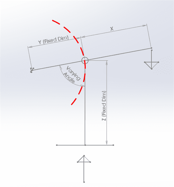

Leverage and Forces on a Pivot System
In summary: angle will be aprrox. 45 degrees, and once its been pulled down it will end up at approx. 90 degrees.

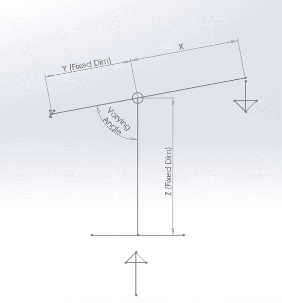

The diagram drawn below shows a lever system fixed to a point on the left with a pivot point (circle) on the line which attaches to vertical line. I have dimensions for Y and Z and the forces pulling the lever down on the right, and the force acting upwards from below. I am trying to work out the dimension for X to determine how long the lever needs to be to compress the upwards force, but I am unsure due to the varying angle as the lever is pulled down. Any help is greatly appreciated.
Before lever is pulled down.
After lever is pulled down.
Thanks.

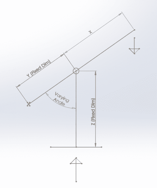

I sense some contradiction between the Y (FIxed Dim) and the Z piece seemingly staying vertical. Y is clearly shorter in the lower picture. Is the point where XY touches Z fixed on XY (and X also a 'Fixed Dim') or not ?
Likes sophiecentaur
Y is a fixed dim (may not be to scale on the image). The point on the left of line Y is fixed, and the point where XY touches Z is fixed. However, X is a variable dim as I am trying to work out the length of leverage required to compress the force acting up.
I hope this clears it up a bit better.
Thanks.
Point on the left of Y is fixed. Y is a fixed dim ##\Rightarrow## point where XY touches describes a circle when the 'varying angle' varies. Correct ?
Yes. The angle varies when the lever is pulled down, as Z always stays vertical. The circle represents a pivot point.
You miss my point. The x coordinate of the pivot point moves in a circle, so Z can not stay vertical
I understand the point moves in a circle, however, where Z touches XY it is a pivot point. The pivot allows Z to stay vertical as it moves around the red circle marked on.

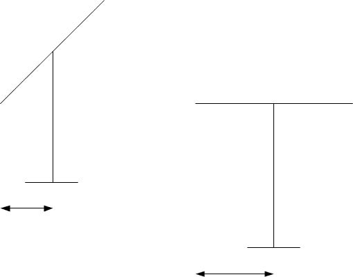

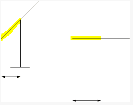

Let me try again. In the left picture the arm is at 45 degrees, in the right it is horizontal. Do you see the distance between the left fixed point and the vertical Z has changed ? So either the leeft fixed point has moved to the left or Z has moved to the right and down.
I can see that the length of the arrows have changed as the lever moves down. However, the Y dimension has not changed- the length of the yellow line has stayed the same. From my understanding the pivot allows Z to stay at the same length and vertical, and also allows Y to stay at a fixed length?
The point on the left is always fixed.
Has anyone got any other suggestions as to how this would be solved? Thanks.
The problem as stated can only be solved for the case where the lever almost doesn't move . Applying down pressure on the lever end can then apply down force on the column without the point of contact moving significantly .
Likes BvU
I'm struggling to work out what the equation would be. I want to find out the minimum length X would have to be to move the lever down, with a specified force pulling the lever down.
For what you describe - and assuming the small movement idea is ok - and if the 'variable angle' shown in your diagram is set to be somewhere near 90 degrees - the essential mechanism is just that of a simple lever .
Solution can be obtained by taking moments about the fixed pivot point at left end of lever .
Force down on column multiplied by distance Y = Force on end of lever multiplied by distance ( X + Y )
Example :
X = 2 metre , Y = 1 metre and force on end of lever = 100 N
Force on column * 1 = 100 * ( 2 +1 ) . Therefore force on column = 300 N

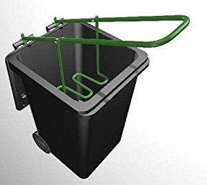

The mechanism is waste compactor, similar to the one below.
Likes BvU
So the vertical link is not actually fixed in position after all . Mystery solved .
For the lever being horizontal the calculation in #14 is still ok .
You could do a calculation for the lever at other angles but since the reaction force from squashing the waste is least when the lever is 45 deg up and greatest when it is somewhere near horizontal I think you could just use that one answer for horizontal for design purposes .
Any calculations are going to be approximate anyway due to the varying properties of waste material .
That's great. So as the force will be greatest at 90 degrees I can assume that it would be worst case?
Yes, they will be approximate. I have done some testing to get an approximate force required to compact household waste.
Yes - I think you'd be quite safe to use lever being horizontal as worst case .

Have you done any reading around levers and moments? The principle of moments uses the phrase 'perpendicular distance' in the definition of the moment of a force around a fulcrum. This link gives you a way into the topic if you haven't already read about it. The simple, lower school, treatment of moments is only restricted to horizontal levers / see-saws etc. but the angle is important if you want to understand it more fully.
I have done some work on moments previously.
I understand that when the line is at 90 degrees: Force on the vertical line multiplied by Y = Force on end of lever multiplied by ( X + Y )
However, when the lever is at 45 degrees I am struggling to create a formula that incorporates the angle.
Why do you need to "create" one? It's in any A level textbook and many other places. Try the link I gave you
You don't have to invent Physics all your own.
Sorry, maybe 'create' was the wrong terminology.
I am trying to write out the formula that incorporates the angle.
For the two instances - line at 45 and 90 degrees- I have written the formulas below.
When the line is at 90 degrees: Force on the vertical line multiplied by Y = Force on end of lever multiplied by ( X + Y )
When the line is at 45 degrees: Force on the vertical line (sin45) multiplied by Y = Force on end of lever multiplied by ( X + Y )
Are these correct?

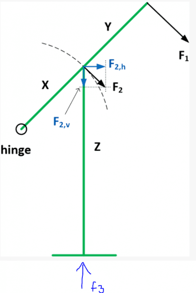

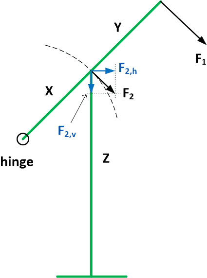

For good reasons: the handlebar is also constrained to move along an arc with radius X+Y. I don't think a component along the X Y arm is doing anything useful -- anyone ?
So I drew ##F_1## as Nidum suggests
Moment balance: $$F_1 \times (X+Y) = F_2 \times X$$
Decomposition of ##F_2##: $$F_{2,\rm v} = F_2 \sin 45^\circ$$
So your formula should be $$F_{2,\rm v} = F_1 {X+Y\over X} \sin 45^\circ$$
Again, if Z starts moving, the top is constrained to move along the dashed arc, but that shouldn't be a big issue: let go, press again is the recipe.

The only unknown I have is the distance you have labelled Y. I have added 'F3' to the diagram to show the force acting against mechanism (representing the resistance of the waste).
How do I find the value of F2? Do I just substitute F2v for F3?

I notice that you now have the applied force acting at right angles to the lever. Would this be likely - as it would tend to tip the bin over. I would think that the natural direction to push would be vertically downward. The bottom line is that the force on the rubbish would be twice the applied force (more accurately [X+Y]/X plus or minus any variation in applied angel and friction). The angle of the bar to the horizontal will have no effect because the ratio of the perpendicular distances is the same.
Apart from any weight force from the press arms, the force on the rubbish is the same as the magnified force from the operator. F2,v = F3)

So the equation above is not relevant as the angle does not need to be considered as the force is worked out using a ratio of X and Y?

The compactor is going to be prone to tipping over anyway . Excessive lever length / lever ratio will make this problem worse .
Useful pictures here .
The picture with the lady operator and the handle at highest level is particularly interesting .
Lever ratio appears to be about 2.5 : 1
