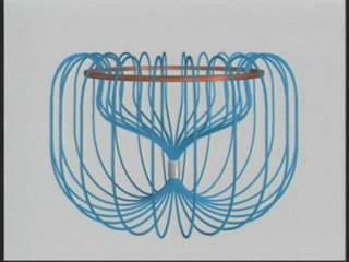

Well, shouldn't the ring magnets keep the magnets on the frame in the inner circle of the ring?
This, except upsidedown. And having that on both the top and bottom of the frame makes it stable. I could be wrong?

Balancing the fields is a little tricky, I don't know if you can do it with a flat picture frame - I think you might need a ring of magnets in the horizontal plane on the floating part.

The problem is not with the strength of the magnets its balancing the force created by the fields of the magnets. Because of this, you have two choices, use an electromagnet on the top or bottom of the cradle with a control circuit, or use some type of di-magnetic materials. If you look at all the floating picture frames and globes out there they all require power to operate their control circuit and electromagnets.
