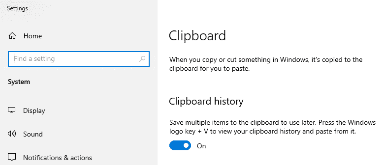

Always watch what is in the buffer ... Why don't they invent a preview for buffer content?
Very late to this, @fresh_42, off topic vis-à-vis the OP, and not sure whether you were joshing, but Windows has a buffer preview, it's the Windows-V key, though you do need to enable the clipboard buffer in Settings before it is useful.
Likes ohwilleke and fresh_42
