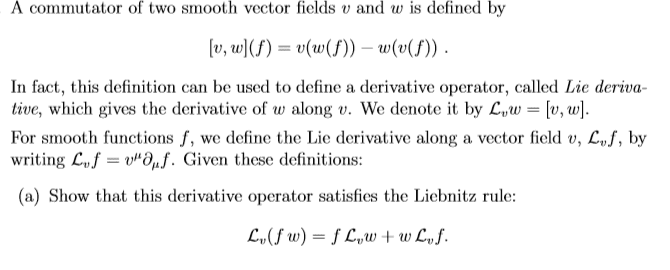

Lie derivative vector fields, show the Leibniz rule holds
In summary: I think it is not a tensor at all, because it is not a linear map ##V: T_p \to T_p##, which would be a tensor.I am not sure if we can still talk about tensors of rank ##(0,0)##, because rank is the number of indices, so ##(0,0)## should not qualify as a tensor (just as a scalar). But as you can see, I am not an expert in this topic either.In summary, the conversation discusses the notation and confusion regarding the Lie Derivative of a vector field expressed as a commutator expression. The conversation also touches on the difference between using an index
binbagsss

##V=V^u \partial_u ##
I am a bit confused with the notation used for the Lie Derivative of a vector field written as the commutator expression:
Not using the commutator expression I have:
## (L_vU)^u = V^u \partial_u U^v - U^u\partial_u V^v## (1)
When using the commutator expression however I sometimes see it written as :
simply, without an index, indicating a tensor or rank zero ## L_v w = [v,w]##
and sometimes with an index : ## (L_v w)^u = [v,w]^u ##
Due to this I am confused as to what the commutator should be once expanded out.
Going with the notation my guess is that :
##(L_v W)^u= V^u w^{\alpha} \partial_{\alpha} - W^u v^{\alpha} \partial_{\alpha}##
##L_v W = (v^u \partial_u w^v - w^u\partial_u v^v) \partial_v ##
So I see the expression multiplying the ##\partial_v## is a tensor of rank 1 and the expression agrees with (1 ) ). Is this what the notation means , or could someone please fill me in (non-sexually)?
Since the question specifies no index, I am going to assume the expression
[/B]
So for the LHS I get:
##v^u\partial_u f w^v \partial_v - f w^u \partial_u v^v \partial_v ##
RHS:
## f(v^u\partial_u w^v \partial_v - w^u \partial_u v^v\partial_v) + w^v\partial_v v^u\partial_uf ##(where the last term comes from the expression given for the lie derivative acting on a scalar)
so the first term from the LHS and the third term from the RHS agree, but not the rest...
Many thanks in advance
First note the definition of the Lie derivative of a vector field (for brevity I'll use the lower comma notation to indicate differentiation of a scalar in a coordinate direction). In a local coordinate system, the ##a##th component of ##\mathcal L_v w## is:
$$(\mathcal L_vu)^a=[v,u]^a=v^c\partial_cu^a-u^c\partial_c v^a = v^cu^a_{,c}-u^cv^a_{,c}$$
Then, substituting the vector field ##fw## for ##u## in the above, we have
\begin{align*}
\left(\mathcal L_v(fw) - f\mathcal L_vw - w \mathcal L_vf\right)^a
&= [v^c(fw)^a_{,c}-(fw)^cv^a_{,c}]
- f[v^cw^a_{,c}-w^cv^a_{,c}]
- w^a \left(v^c f_{,c}\right)
&= [v^c(f_{,c}w^a+fw^a_{,c}-fw^cv^a_{,c}]
- w^a v^c f_{,c}
\end{align*}
and collecting terms, we see that this cancels out to zero.
