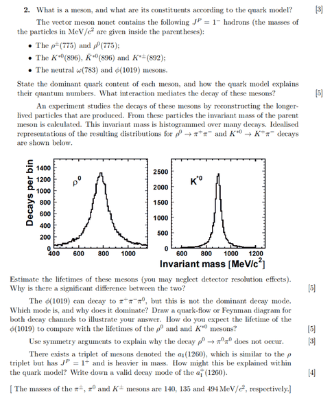

(a) What is a meson?
(b) State what these mesons are made up of and explain their quantum numbers and interactions.
(c) Find the lifetimes of rho meson and kaon.
(d) Find the dominant decay mode and explain why.
(e) Why is decay to 2 neutral pions forbidden?
(f) Explain how an a1 (1260) meson can be formed and a valid decay.[/B]

How do I find the lifetime from these graphs? I can see that the graphs peak at 1300 decays/bin and 2500 decays/bin respectively. How do I convert that into lifetimes?

(c) You don't. Instead, you use the uncertainty in the energy, so the width, not the height. Here or here

So since ##\Delta E \delta t = \frac{\hbar}{2}##, I take that the lifetime is the uncertainty ##\delta t## so I simply estimate the half-width ##\Delta E## from the graphs to calculate ##\Delta t##?
Yes. Nice, isn't it ?
