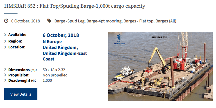

Also, is the crane going to be on the barge with the spud legs as it lifts them, or will it be alongside the barge on the dock?
https://www.hmsbroker.com/charter-type/spud-leg-barge/
