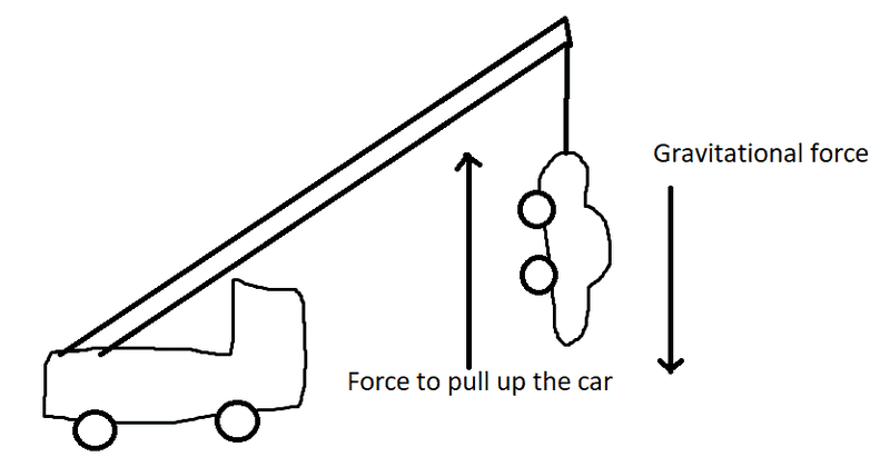

From a physics multiple choice test: "A car is raised to a height of 10 meters. The car is at rest both before and after it has been lifted. The mass of the car is 900 kg. The total work that has been done on the car during the move is"
(The right answer is: zero).
Wnet =ΔKE (Net work = Change in Kinetic energy). The car's kinetic energy remains the same (it's still on rest), so in this equation no work is done on the car.
But how is it that the work done on the car is zero?
Doesn't it contradict with the equation: W = F*s?
A force upwards is applied to the car to raise it up, it requires force against the gravity force to raise the car. And the car is displaced 10 meters upwards with that force.
The force exerted on the car to lift it up is: 900KG*9.81 = 8,829 N.
So according to this equation: W = F*s the work is done on the car, because it's been displaced by a force.
The car is still on rest (no kinetic energy), but the car's potential energy is increased by ca 88 Kj (mgh = 900Kg*9.81*10m). Doesn't it mean that it's been done some work to increase the car's potential energy?
Wnet =ΔKE (Net work = Change in Kinetic energy). The car's kinetic energy is the remains the same (it's still on rest), so in this equation no work is done on the car.
But according to this equation: W = F*s the work is done on the car, because it's been displaced by a force.

This is a somewhat tricky problem due to the wording. Technically, the book is correct about the total work done on the car is 0. It's important to pay careful attention to the wording of "the total work that has been done on the car during the move is ___."
The correct answer would be different if the question was:
"the total work that has been done on the car, by the crane, during the move is ___."
Similarly, yet a different answer than that would be correct for the question:
"the total work that has been done on the car, by gravity, during the move is ___."
You are correct that you can use the formula [itex] W = \vec F \cdot \vec s [/itex] for each force involved in the move.
But how many forces are there for this problem?
Keep in mind the result of the vector dot product can be positive or negative. To find the "total" work done on the car you need to sum the work done by all the forces involved.

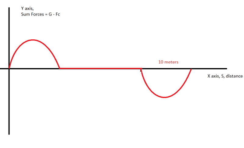

So this means:
Let's call the gravity force on the car (or weight on the car) G, and force from the crane to the car Fc.
1) When the car is lifted up, it needs to be accelerated upwards. Sum of the forces is positive upwards in some seconds.
In the start Fc > G.
2) Then it's lifted upwards with constant velocity. Sum of the forces is zero.
So Fc = G.
3) After 10 meters upwards lifting the car is kept there at rest. There's an acceleration downwards since the car's velocity changes from moving upwards to being at rest.
That means after the car is lift 10 meters upwards sum of the forces is pointing downwards in some seconds to stop car moving even further.
So Fc < G. Fc is 500 N in a short time.
4) The car is kept at rest there 10 meter above the ground. So at there Fc = G again.
This is how the Force and distance graph would look like (Y axis: Sum Forces applied on the car. X axis: meters above the ground).
Work is integral of Force with distance as variable. And integral of the graph above is zero (from 0 to 10 meters). This means zero work done on the car (sum is zero).
But there's some areal between the graph and the X axis. Does it mean both the gravity and the crane does work on the car during the lift, but their work done on the car cancels each other out, so the sum becomes zero?

That's pretty much correct in my opinion.
A note about the work done on the car by the crane: You are right that for at least a brief moment, Fc > g at the beginning and another moment where Fc < g at the end when the car comes to rest at the top. But when calculating the work done by the crane, you can use its average force (or when calculating the force, by using its average acceleration). [Edit: or as you suggest, you can integrate.]
And like @haruspex mentioned, you can use this idea to convince yourself that the net work on the car (same thing as total work once you sum everything together) is equivalent to the car's change in KE.

But isn't it that "the total work done on the car is zero" but "the work done on the car by the care" is not zero (above zero)?
The work done by the crane is nonzero.
If we ignore the transient acceleration and deceleration, whether you consider that the crane did zero work on the car but nonzero work against gravity, or that the crane did nonzero work on the car and the car did the same work against gravity, is somewhat arbitrary.
Of course, the crane could in principle pull the car up so fast initially that the car will rise to the required height with no further assistance. In this case clearly the crane does nonzero work on the car, then the car does the same work against gravity.
