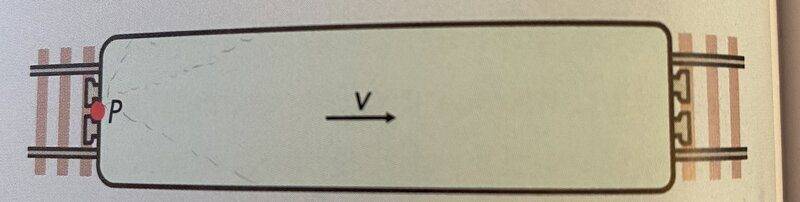

A train is traveling at a constant velocity v = 0.8c (80% of light speed). The figure shows a train observed from above. A light beam hits point P at the back of the wagon, from where the light is reflected in all directions. There are two questions that need to be answered;
1) I have to explain that some of the light has to be reflected obliquely (tilted, not in a straight line) backward, without hitting the wagon wall.
2) What is the maximal angle that the light beam can be reflected at

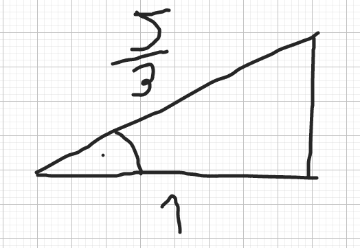

1) really does not make sense to me. It is not clear to me how light could be reflected in multiple directions if the source is not a tilted mirror or another object with specific properties. I think the thought of the "point" P confuses me. Further, the fact that light travels in the opposite direction initially from the velocity vector (direction of the moving train) does not give me any intuition. I suppose it would have to do something with contraction of the train, as I shall attempt in 2)
2) The correct solution that I came up with (which is 53 degrees) was by using the Lorentz factor. Namely, if we calculate
##y = 1/ \sqrt{1-0.8^{2}}##we obtain a value of y = 5/3. Making a right triangle, We get the value of 53 degrees (I guess the hypothenause would be the refhypotenuse
My question then would be, what and how does this angle of reflection have anything to do with the Lorentz factor and possibly contraction? And if it can be used to potentially answer 1)

2) It is unclear to me how you obtained this answer.
Lorentz factor evaluates to 5/3, and using the ##cos^{-1}(1/\frac{5}{3})## I get the the value of 53 degrees...Now, the question is where is the connection here?
That is what I am asking you. You cannot just throw numerical values around and hope to magically arrive at a solution. You need to make an argument.

I am having trouble understanding the question still. Some of the wording seems a bit off.
Aristarchus_ said:
Homework Statement:: A train is traveling at a constant velocity v = 0.8c (80% of light speed). The figure shows a train observed from above. A light beam hits point P at the back of the wagon, from where the light is reflected in all directions. There are two questions that need to be answered;
I think it should read "hitting the wagon's back wall". A wagon has four walls. Not one.
The word "backward" seems inappropriate. Surely light reflecting from a forward-moving wall can only be reflected "forward".
As I interpret this, we have the light hitting the midpoint P on the train car's back wall.
The light scatters in "all directions". But from the point of view of a passenger in the car, this actually means "in a 180 degree arc". After all, the light cannot scatter through the back wall.
If we are being asked for a scattering angle, we are being asked to consider how the limiting angle (90 degrees on either side of straight forward) changes when we shift to the rest frame of the tracks.
One way to do this would be to write down coordinates of two events in the railroad car frame
1. Reflection event from point P at time zero. (Suggest you place the origin of your coordinate system here).
2. Impact event when reflected light ray hits top of car right at the rear wall.
Repeat for the same two events using the ground frame this time. Tell us what calculations you have used to convert from the "moving" (train car) coordinate system to the "stationary" (train track) system.
Calculate the angle between the two points that you identified in the stationary coordinate system.

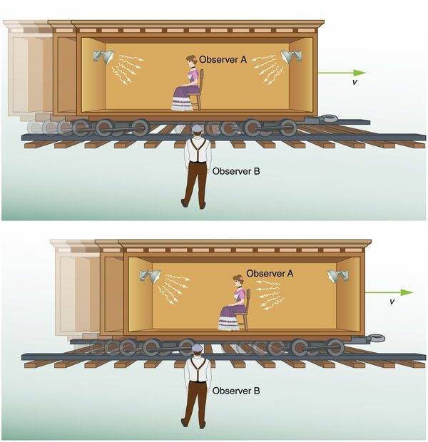

Think of two lights that are blinking. Then how each observer will preceive them. Maybe this image will help. You could also think of what you hear when a train goes by at a normal velocity compared to what the passengers hear. Coming toward Observer B the light would be compressed and be shifted to the blue (ultra Violet), traveling away from observer B the light would be extended and shifted toward the red (infrared).
