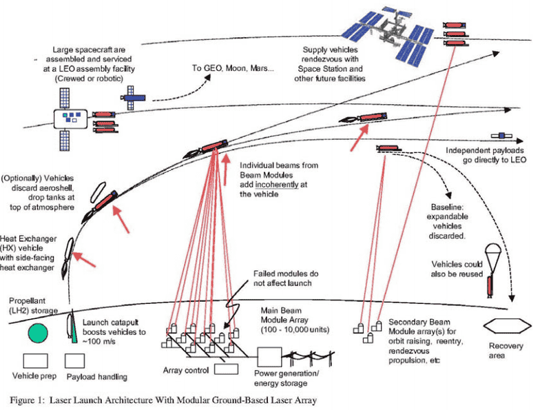

The standard reference on laser launch is by Jordin Kare:
Modular Laser Launch Architecture: Analysis and Beam Module Design.
Final Report
USRA Subcontract Agreement No. 07605-003-015
30 April 2004 Revised 18 May 2004
Dr. Jordin T. Kare
Kare Technical Consulting
908 15th Ave. East jtkare@****.***
Seattle, WA 98112 206-323-0795
http://www.niac.usra.edu/files/studies/final_report/897Kare.pdf
The estimate there is 1 kg in payload to orbit per megawatt laser power. Quite key is the fact discussed in the report you can combine separate lasers to get a high power beam for larger payloads.

The importance of the Jordin Kare research is that the theory showed that you can combine many of the lasers to get one large beam. This has been confirmed with the U.S. Army's 60 kW laser weapon that is formed by combining separate laser beams.
So you could get over a 1 MW beam by combining 20 of the Army's 60 kW beams. The development cost would be prohibitive however for only delivering about 1 kg to orbit.

Yes. This is a much relied on report in the field by the late Jordin Kare:
Final Report
Dr. Jordin T. Kare
Like with usual rocket engines there is more propellant than dry mass of the vehicle or payload. But that 1 kg per MW estimate is counting only payload that gets to orbit. That is, for that 1 kg payload for that 1 MW of power, the dry mass of the vehicle is more than that, and the propellant mass is greater still.
