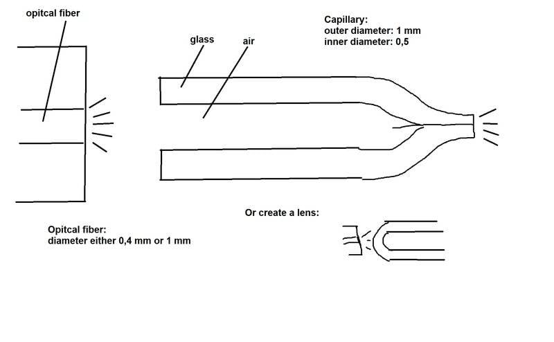

Many thanks for your answers! I have attached a sketch. The glass capillary is used to melt in a small metal wire which is then used as an electrode. The idea is to use the glass fiber both for insulation of the metal wire and for local illumination as we want to study photocatalyst reactions on a surface.
My question is how to position the optical fiber for the coupling?
-Directly on one side of the glass sheath? Therefore the diameters of the fiber (0,4mm) and sheath (0,25mm) would not match now. Maybe with a smaller fiber then? 0,4 is the smallest we have right now
-Illuminate both glass sheath and air with the bigger fiber? (Also directly place the fiber in physical contact with the capillary)
-Another idea would be to melt the glass end of the capillary and use it as a lens to collimate the light?

I think most light enters to hollow capillary and is lost. Maybe use a solid glass rod tapered to the size of the capillary and having a cone-shaped depression made in its end made using a pin when the glass is soft. We need to convert the optical mode to a coaxial waveguide mode to suit the capillary. Incidentally, I have previously found that it is not possible to collapse a capillary by just heating, but in principle I think it needs a transition from solid to hollow glass waveguide. Are you going to use a laser or special light source or an LED?
Unfortunately i cannot use completely solid glass as i need the capillary to melt in the metal wire. However i can melt quite a large part at the end of the capillary without major deformation but there is still a very small channel. The only option would be to open the capillary at some point and use a vakuum pump (this is the way we melt in the metal wires). The resulting glass ball at the end works also as a ball lens and i could reduce the losses a bit.
I will try with the pin to make a cone shape, how would you recommend to place the fiber then? butt-coupling directly into the cone?
I am not sure if i got your idea with the coaxial waveguide, additional shielding of the capillary (e.g. acrylate or another metal)?

Maybe it's just how you've drawn it, but It's the reduction of radius that concerns me. Aren't you trying to reduyce the phase space of the light? And doesn't Liouville's Theorem get in your way?
As far as i have understood, when the light enters the glass it propagates via total internal reflection and will exit at the tip. Its right that some light will be lost where the radius is reduced, but i also checked capillaries without any tapering and most of the light is lost already here with the coupling.

As drawn, the system seems to decrease etendue. How?

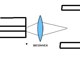

Hello, Decades ago, when I did this sort of thing for a living, NSG SELFOC has
small graded index lenses that attached to the end of fiber with index matching glue.
This (or any biconvex lens) would convert the diverging cone of light coming out of the end of the fiber,
into a focusing cone of light. By adjusting the lens distance, you could optimize the amount of light getting into the glass capillary.

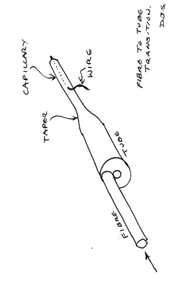

I have made a sketch of a possible coupling arrangement.
Would you just polish the ends of the FO cable and the glass, and affix them somehow mechanically? I wonder how the OP is cutting the FO cable to prepare it for the assembly...
I believe you could make a robust connection by stripping the cladding from the (polished) fiber end for 10mm. Make the glass tube hole as short as possible and put in low viscosity (UV cure?) epoxy with a syringe sufficient to fill the interstitial space between inner tube and fiber (try to match the glass index of refraction) and shove in the fiber. Bubbles are your enemy (you could put it in vacuo). Keep it simple and strong. Complicated schemes for light pipes never perform up to expectations and LEDs are now very bright sources.. (Twenty five years ago when I was designing bad light pipes they were much less so)

i made a holder to fix the fiber exactly like this on the glass wall, i will try and check the losses when i find some time...
the fiber i am using has a metal sheath like in my drawing at the beginning, i am not cutting anything just put them directly onto each other.
