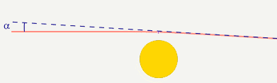

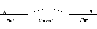

It is known that light beam bends near massive body and the object sendind deflected the beam is seen in shifted position.

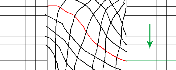

Now about spacetime curvature. As I undestand the things are like that:
http://i11.pixs.ru/storage/3/3/4/pic2png_7037348_21446334.png
The question is why are geodesics in left side not the same as in right? So I'd expect this situation
http://i10.pixs.ru/storage/4/5/6/pic3png_9235518_21446456.png
So that we can see objects before the body without shifting
You mean that everything must move "horizontally" in flat spacetime?
I mean that after passing curved region light has to return to flat region with the same straight geodesic as it was before the curved one. I depict the red horizontal line as one geodesic and it just bends in near the body and has to get straight again in flat region. Where am I wrong?

A geodesic is a straight line, the line you have drawn is significantly curved in the flat region. In the flat region, the line is straight in both cases in the first two figures.
Why in the same direction as before? Why can't it just continue in a straight line?
If a particle is moving in a straight line and you deflect it, it moves in a new straight line. It doesn't curve back to its original direction.
There can be many straight line geodesics in flat space.
I am sorry.There must be no curved

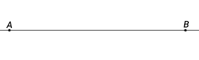

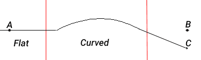

Thanks, guys for your replies. So when there is no curvature the path between two points i.e. geodesic is straight line
If we place a massive body in center the geodesic will be curved
But actually we see that light appears in point C
And we see an object that is in A as if it was above point A.
So where is misconception?
Your curved line in the middle figure (and in the beginning of the lower one) does not follow how the curvature actually bends the light. Part of your misconception probably stems from that your "curved" region seems like a slab rather than a spherically symmetric region.
Edit: Also, it is not as easy as declaring a part of your space-time to be flat and another to be curved - there is a gradual change from small curvature to large curvature.

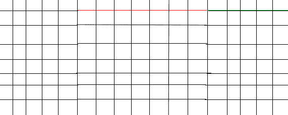

So from the second picture in your link it appears that if there is curvature instead of light moving to green line:
it moves more under the green line:
So it seems that there is a break of geodesic
Or another situation when right flat region moves down and there is no break with green line
But is that movement possible?
Sorry guys for inaccurate pictures
No. It is not that the light is offset downwards. It is curved downwards. It does not retain its original direction.
To be more precise, it does always retain its direction at every infinitesimal step along its path. However, the curvature of space-time means that the incrementally straight path seems to curve when judged against the asymptotically flat space-time far from the region of curvature.

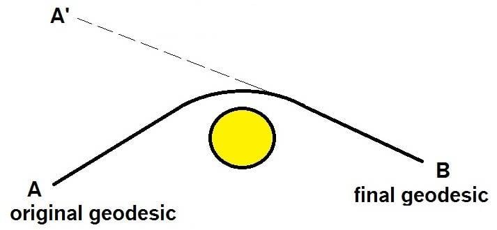

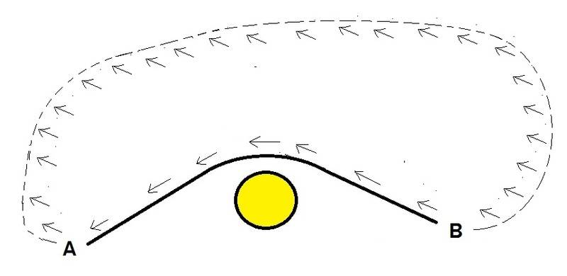

But that's not true. It won't return to the "same" geodesic. Here's an exaggerated picture of the bending of light around the sun:
Passing near the sun causes the light ray to change directions.

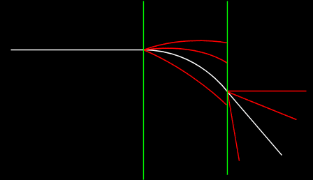

You have light coming in from the left leaving flat space-time and entering curved space-time as shown in the image below. There are an infinite number of geodesics that intersect any given point, and this is true for the point where the light enters curved space-time. Some possible ones are shown as the red curved lines. But only one of those geodesics "lines up" properly with the incoming light ray and is the only allowed path for the light upon entering light ray.
Upon leaving curve space-time, there are also an infinite number of straight line geodesics in flat space-time that intersect that point. Some are shown by the red straight lines. But again, only one of them (the white line) lines up properly with the curved space-time geodesic the light is now following, and it is the only allowed path the light can take upon leaving curved space-time. This new flat space-time geodesic will be a different direction to the original straight line path.
